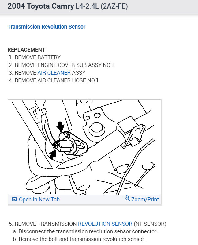

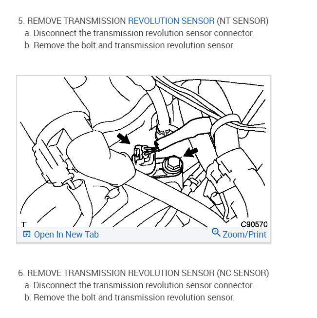

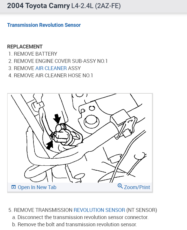

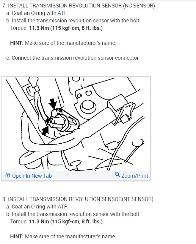

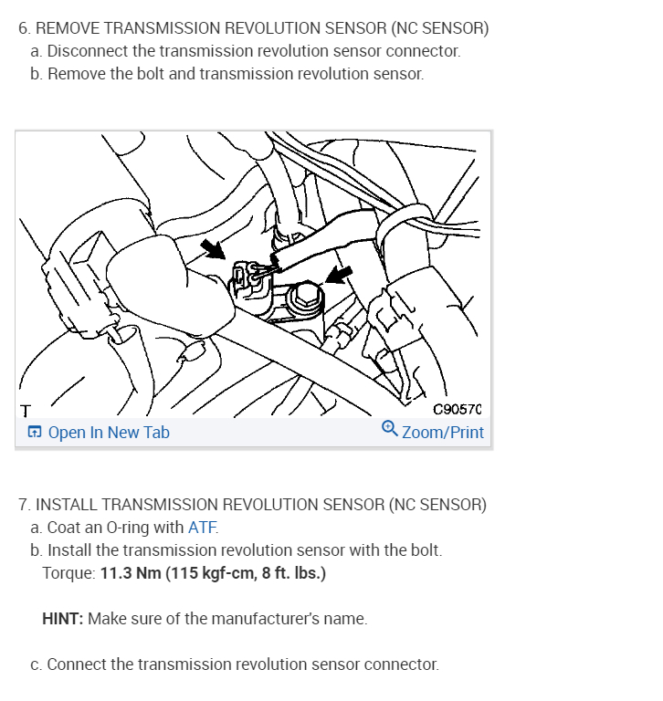

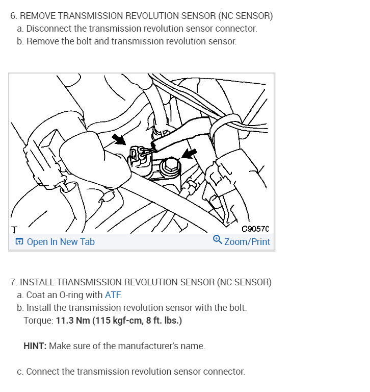

I would scan the car for codes first because it sounds like the ECM, or the input shaft speed sensor is not working. Here is a guide to help you get the codes and the location of the sensor in the images below.

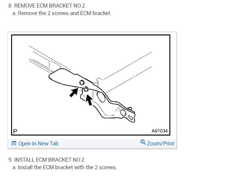

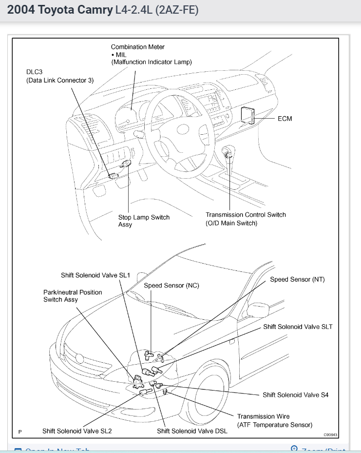

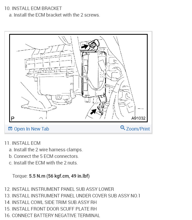

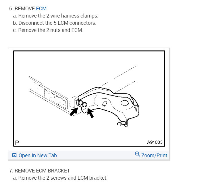

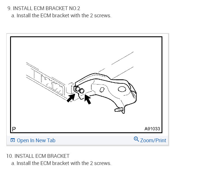

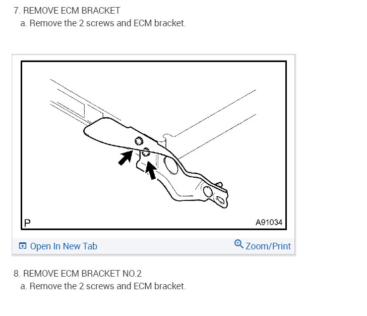

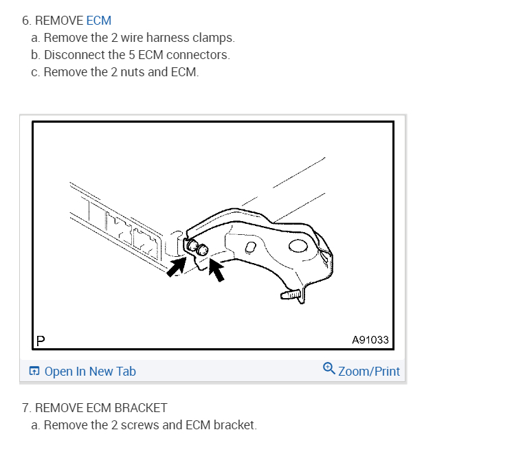

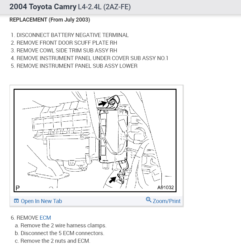

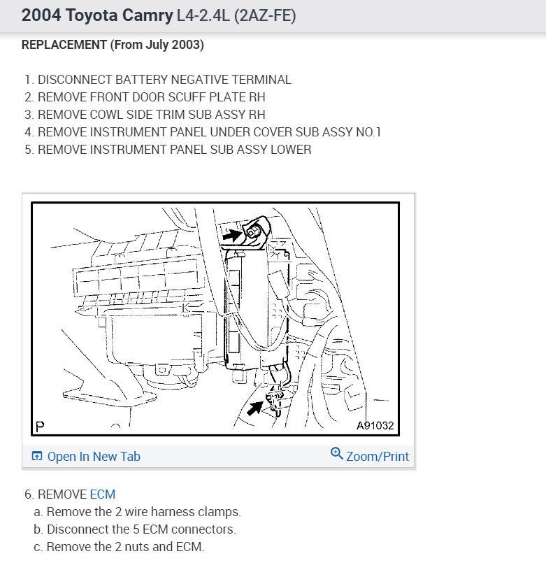

So, if the code is still there and the wiring is good, I would replace the ECM. Here are the location and instructions in the images below. You can get a preprogrammed unit by searching Google or Ebay. Check out the images (below). Please let us know what happens.
