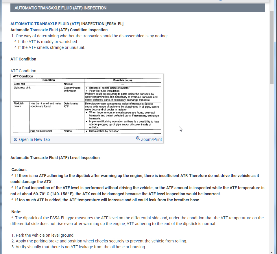

I recently changed the transmission fluid and filter and after that the car will go in every gear but it won't move, it just hits like it's going to go but it doesn't. It has no check engine light or A/T light. I need help ASAP! thanks
