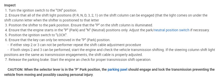

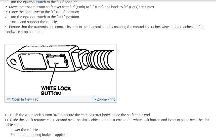

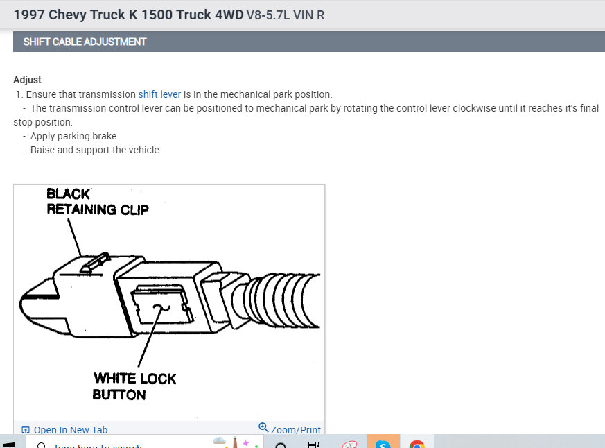

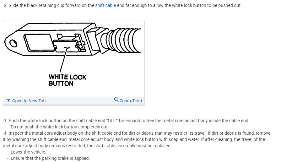

The shift linkage is a cable that can be adjusted. I suspect this is where I would start. The more I think about it, the less I feel there is a broken part. Instead, I feel it is between gears. Pay attention to the gear indicator to see if it lights up P and R.
I attached the linkage adjustment procedures below. You may want to do this first.
See pics below.
