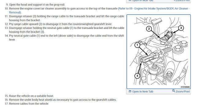

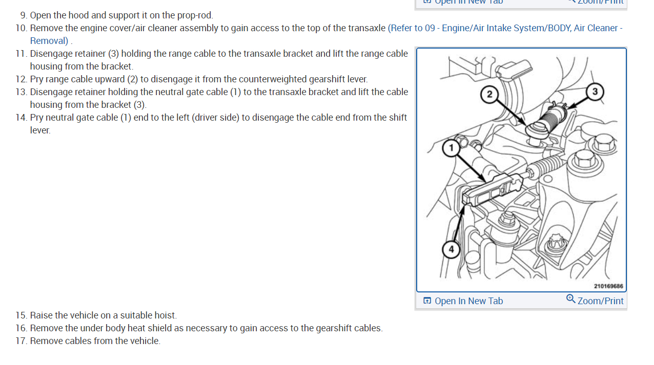

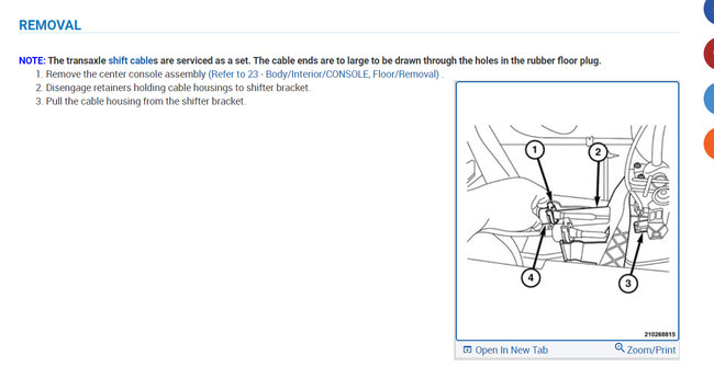

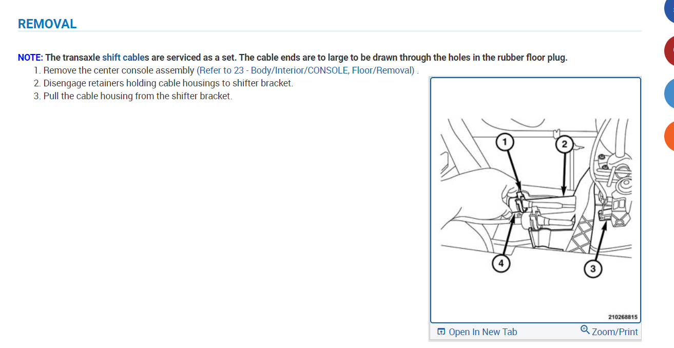

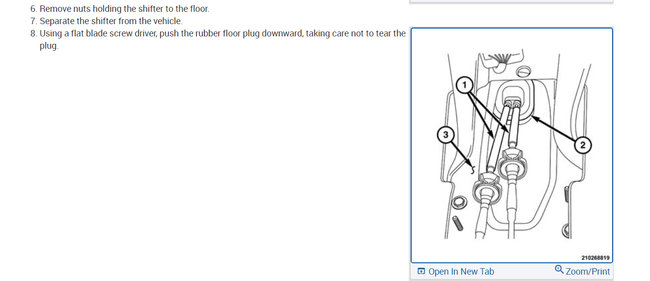

Good afternoon,

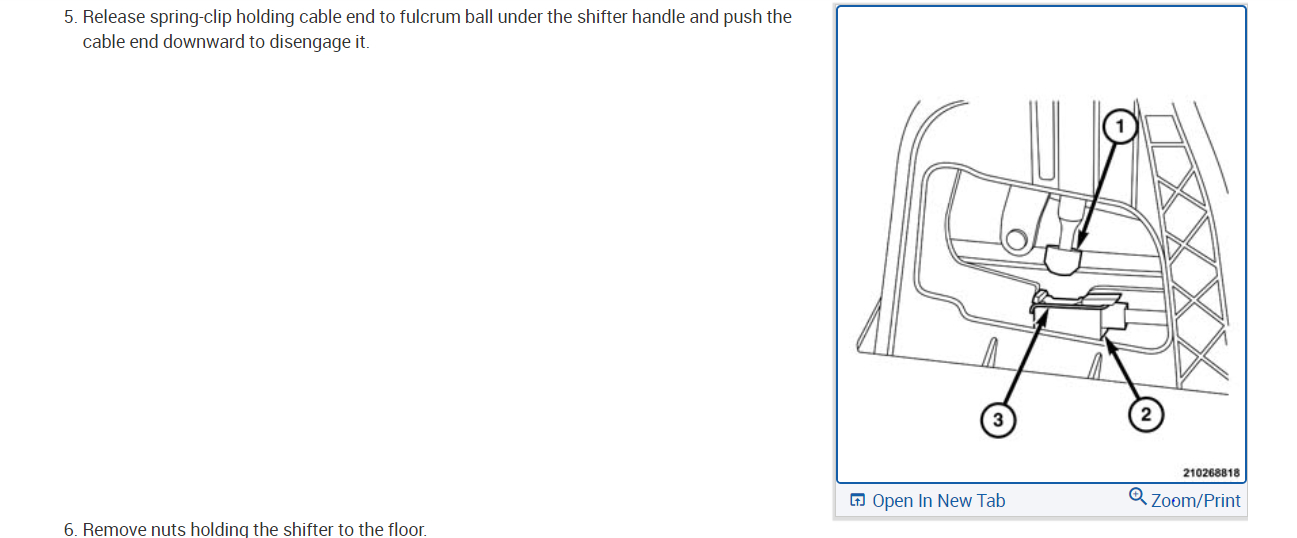

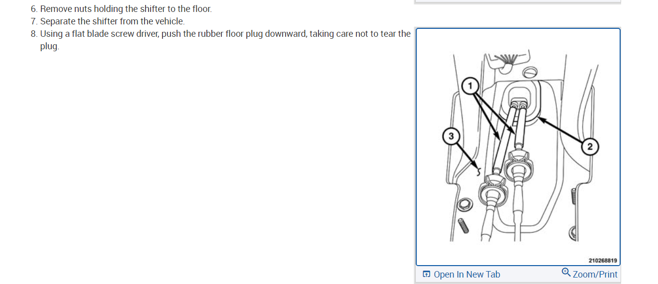

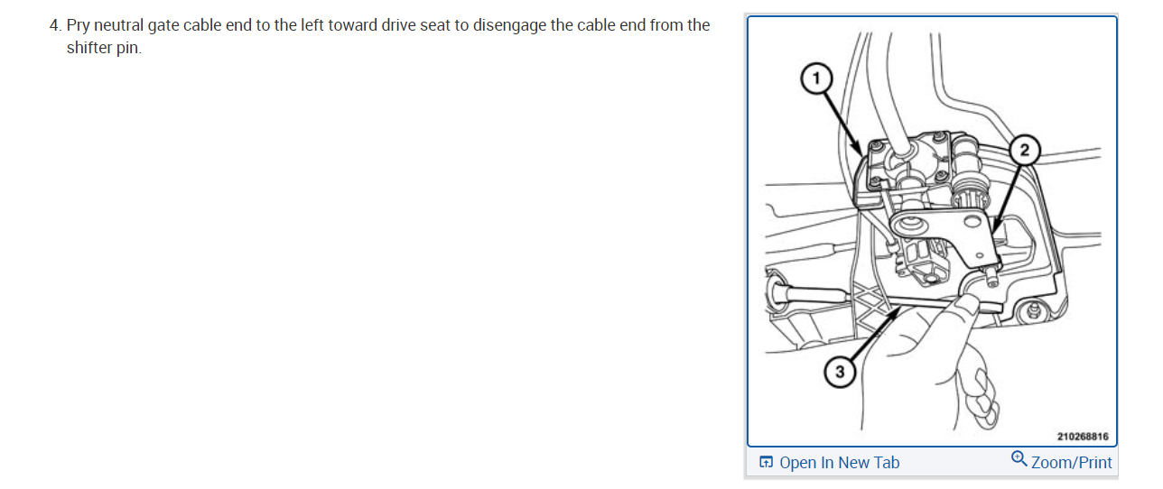

This sounds like the cables that attach the shifter to the transmission. You need to check the cable mounts to be sure they are secured correctly. I attached the procedure with pictures for you to view.
https://www.2carpros.com/articles/how-to-replace-a-clutch

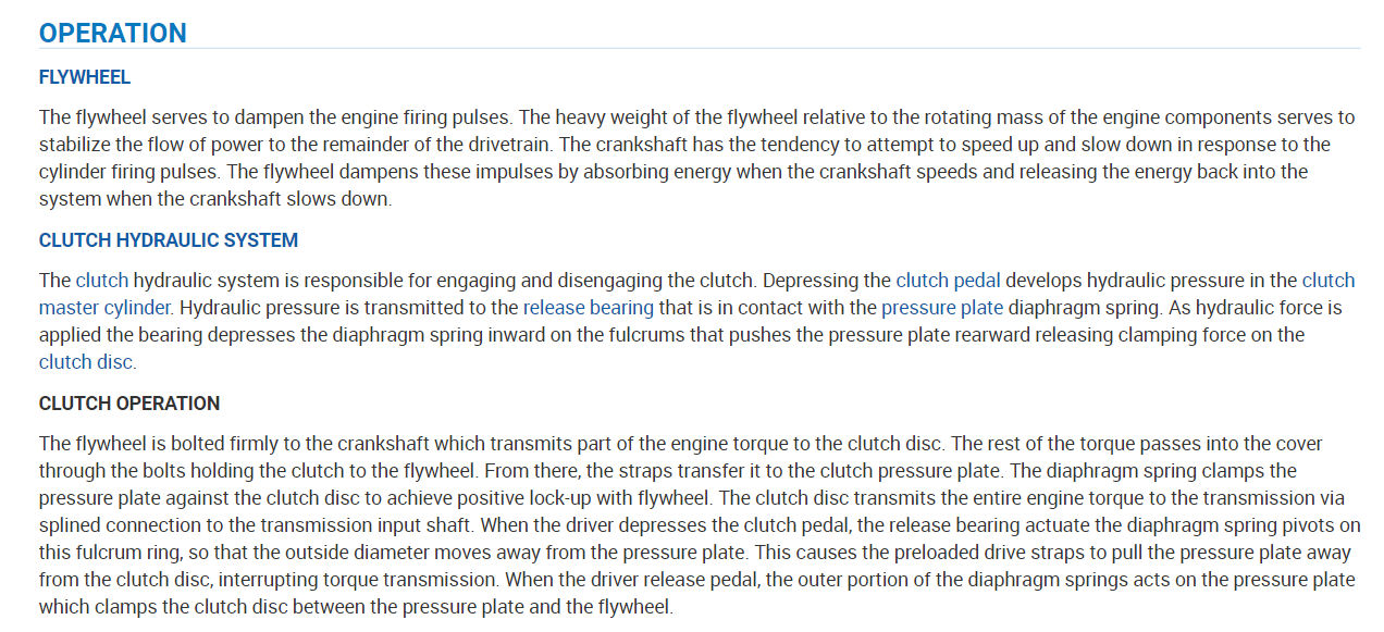

No, that is part of the clutch itself. The parts they used most likely were not OEM parts. The replacements give you an easier, softer pedal.
