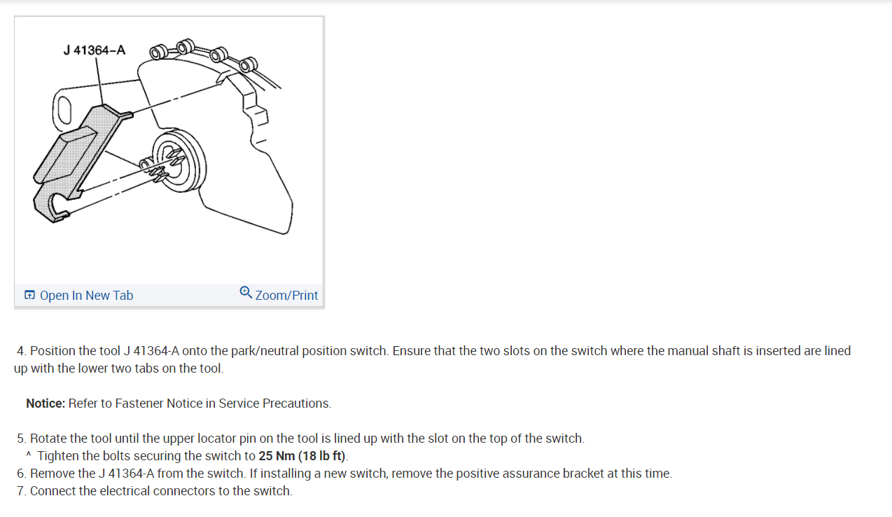

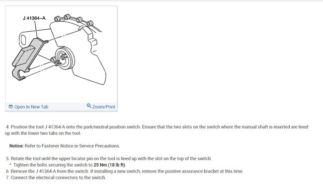

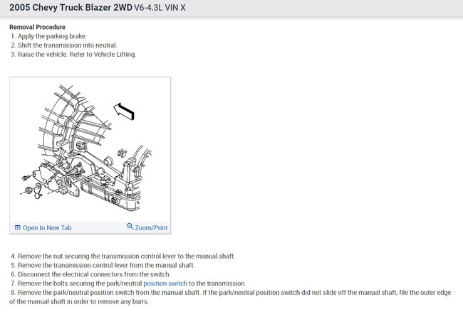

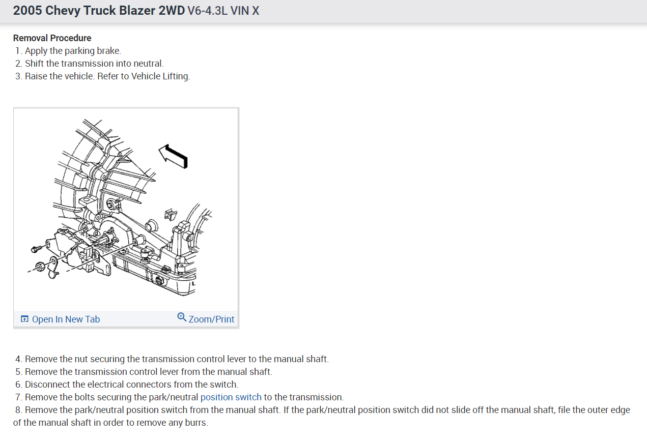

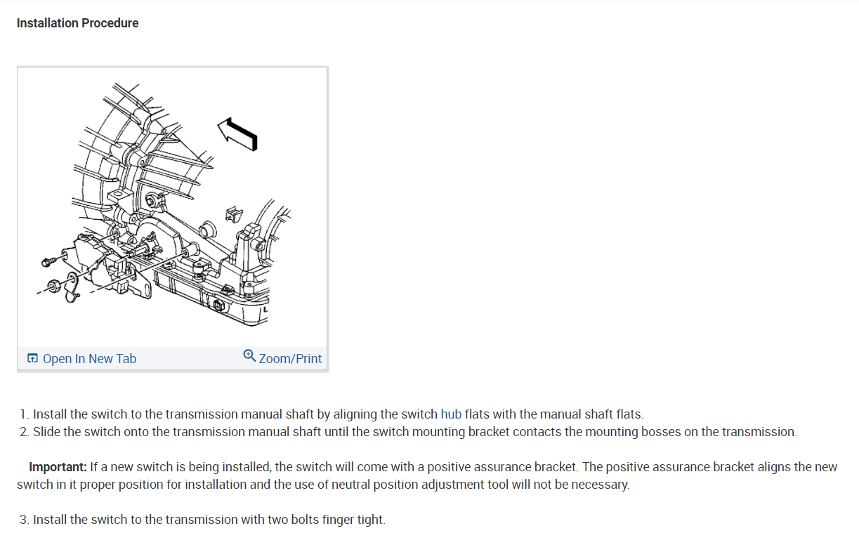

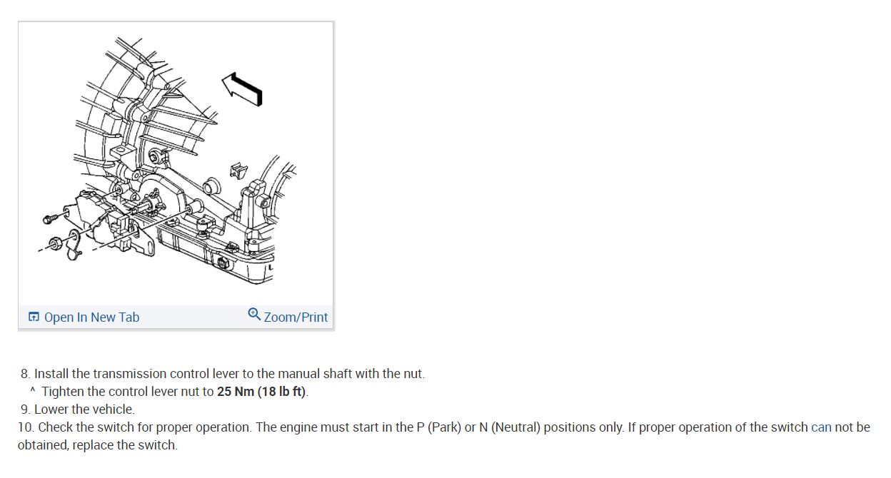

When you put the transmission in reverse does the indicator light up? If not, the gear range sensor has gone bad. Here is how to replace it. Also, I have included a guide that may help as well.
