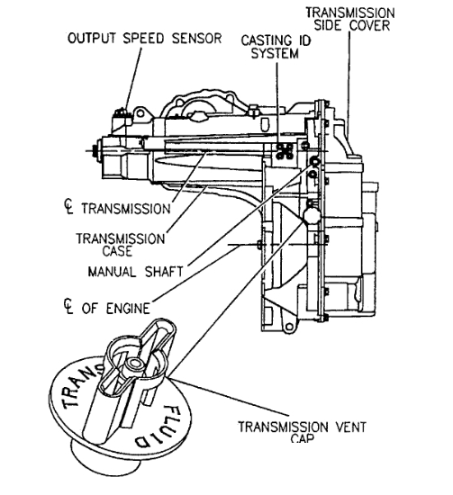

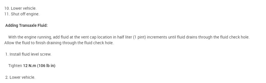

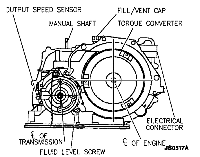

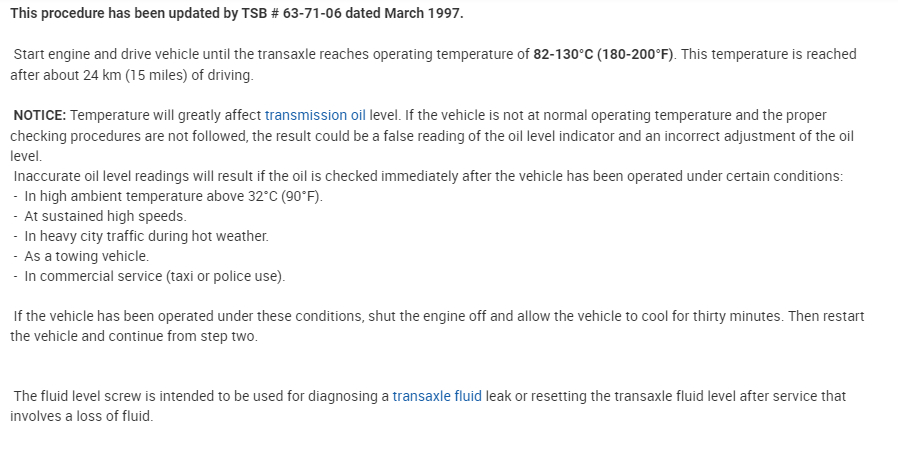

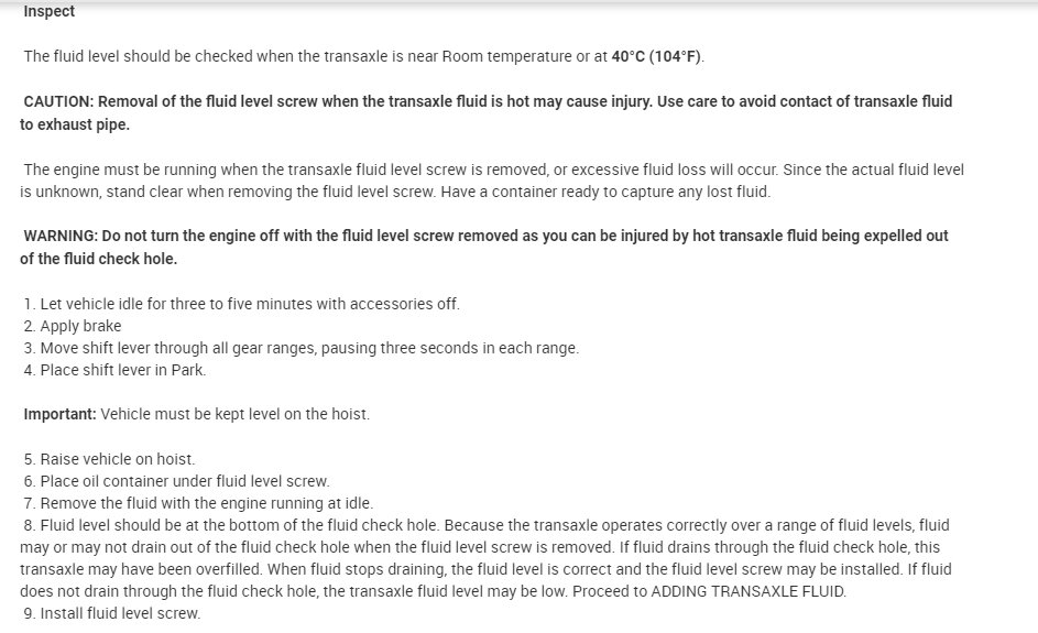

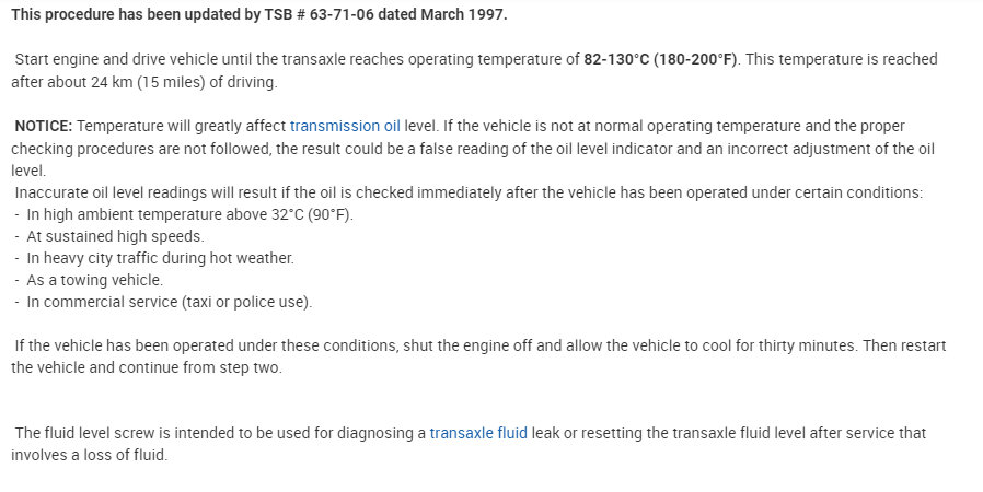

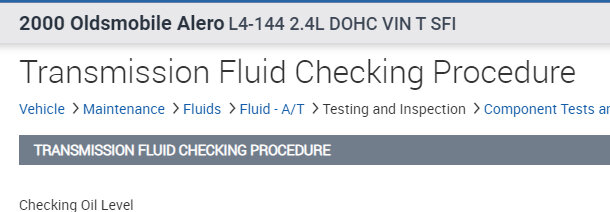

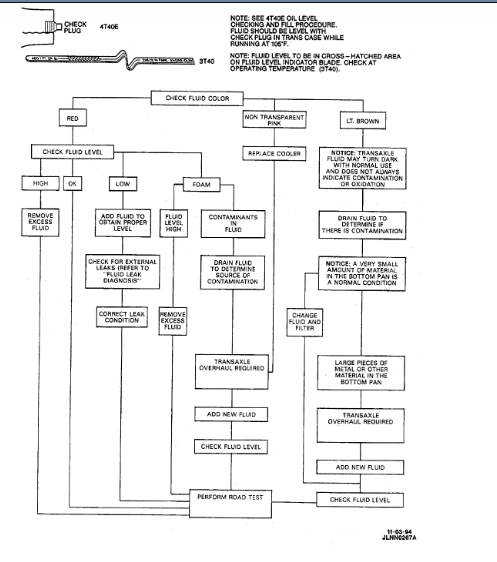

I attached the directions from my manual for you. It is a little bit of a pain to check this one. The directions also include some diagnostics based on what is found.
Take care.
See pics below.
