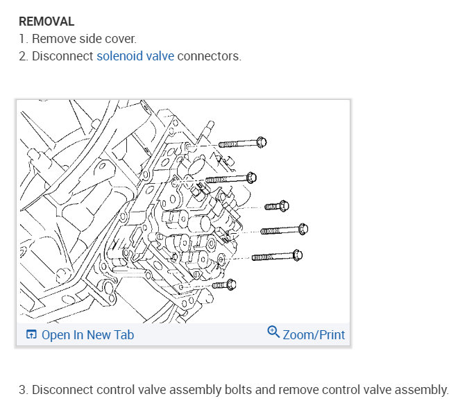

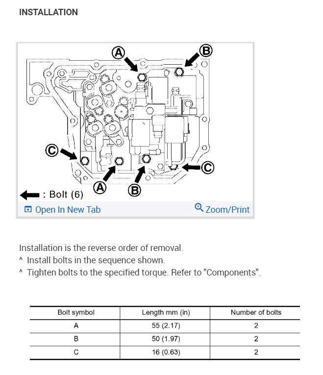

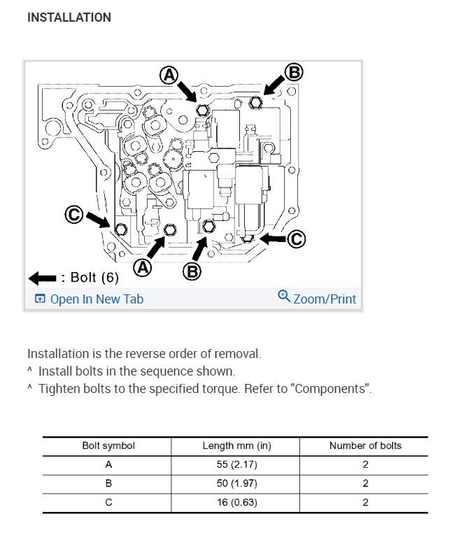

Okay, got one code gone, lets replace the valve body with a rebuilt unit. this will take car of the remaining codes. here are directions below. Check out the diagrams (below). Please let us know what you find.
