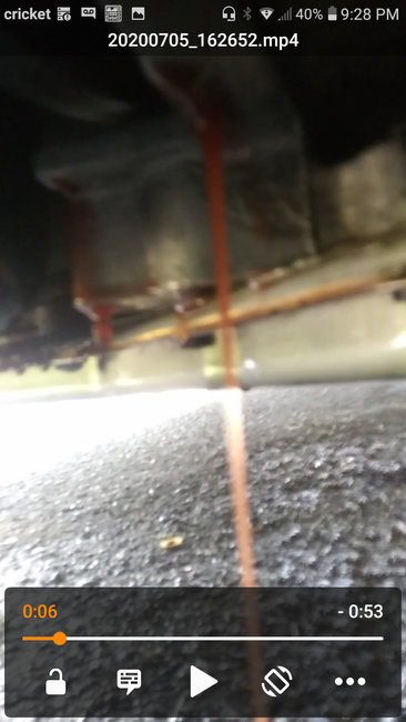

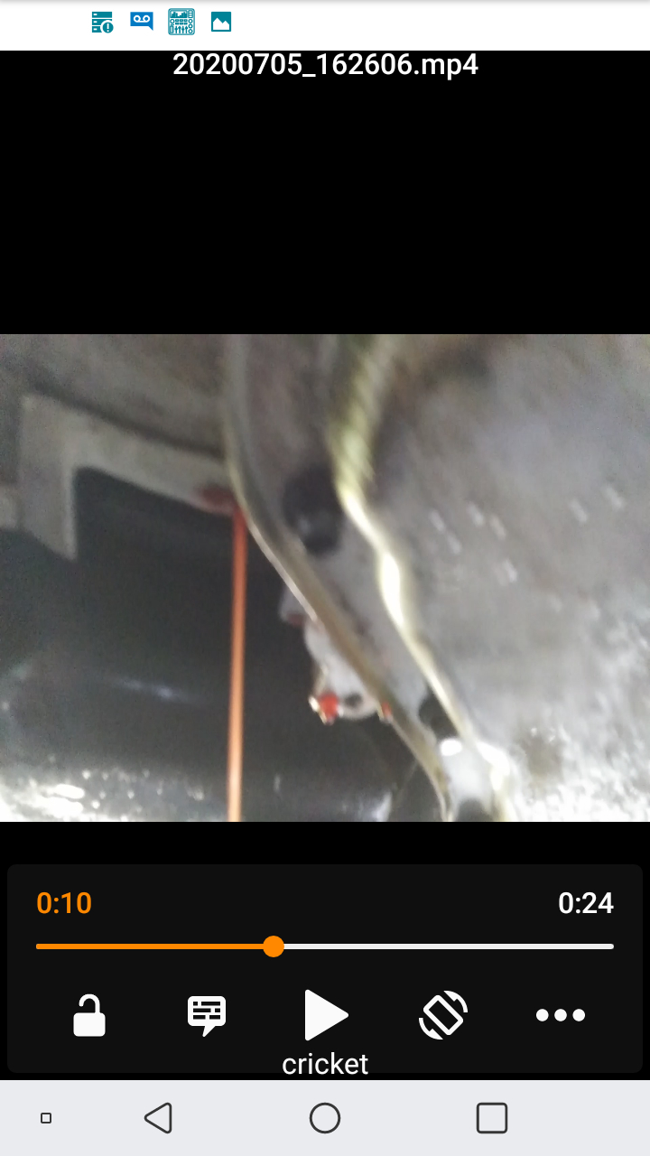

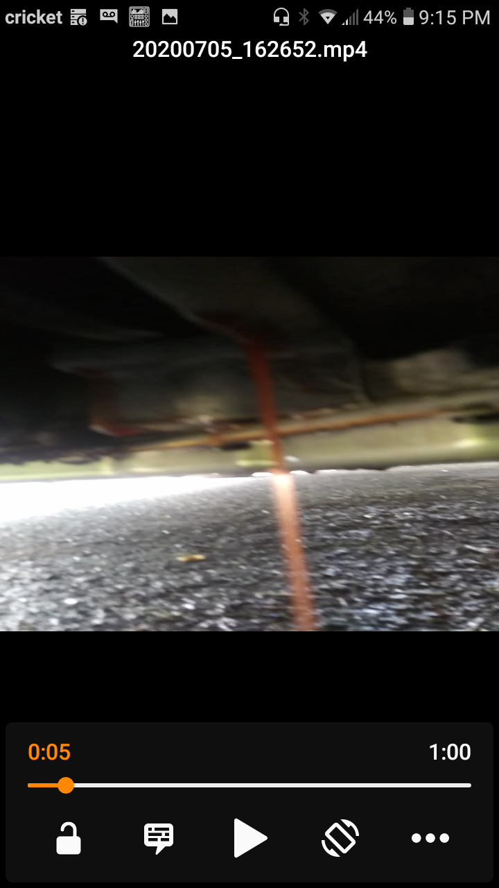

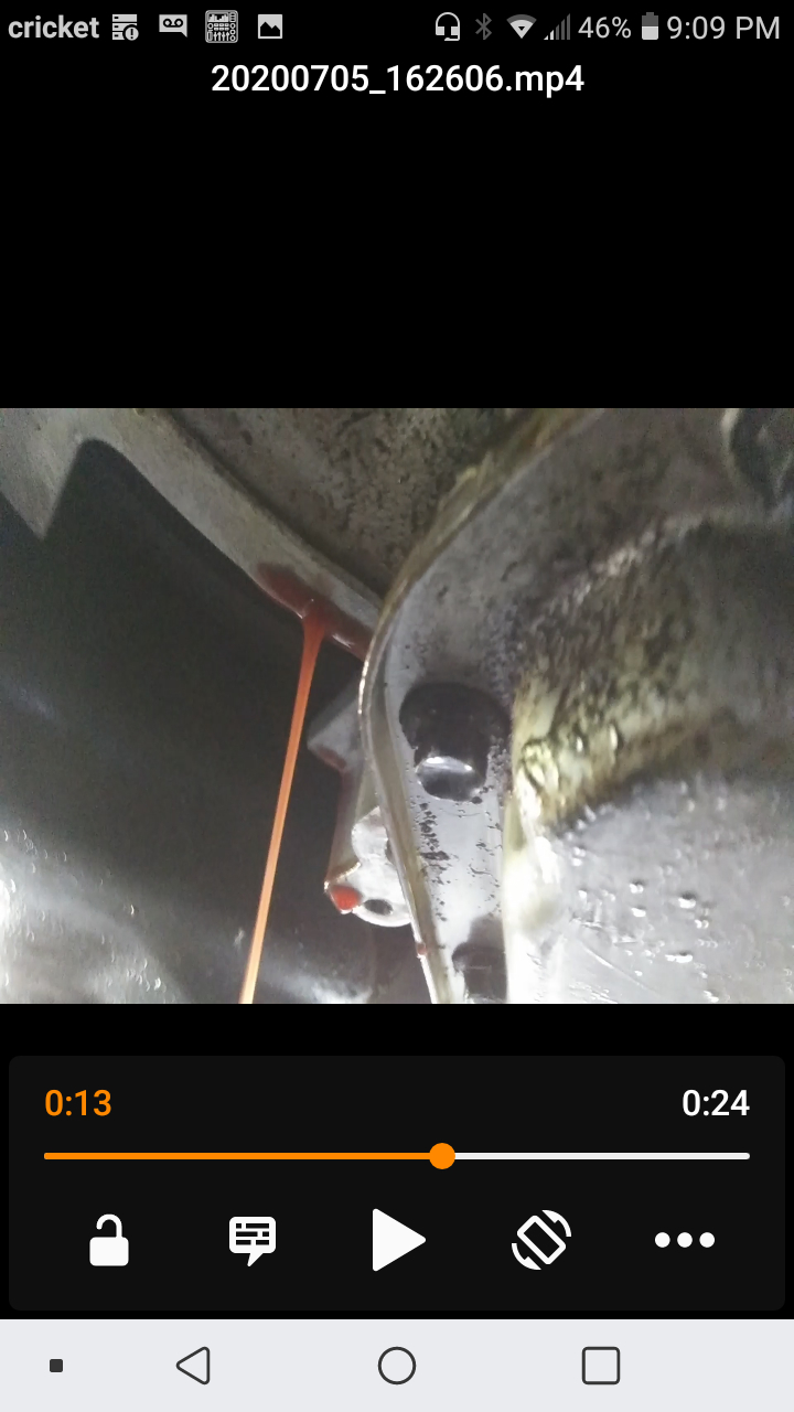

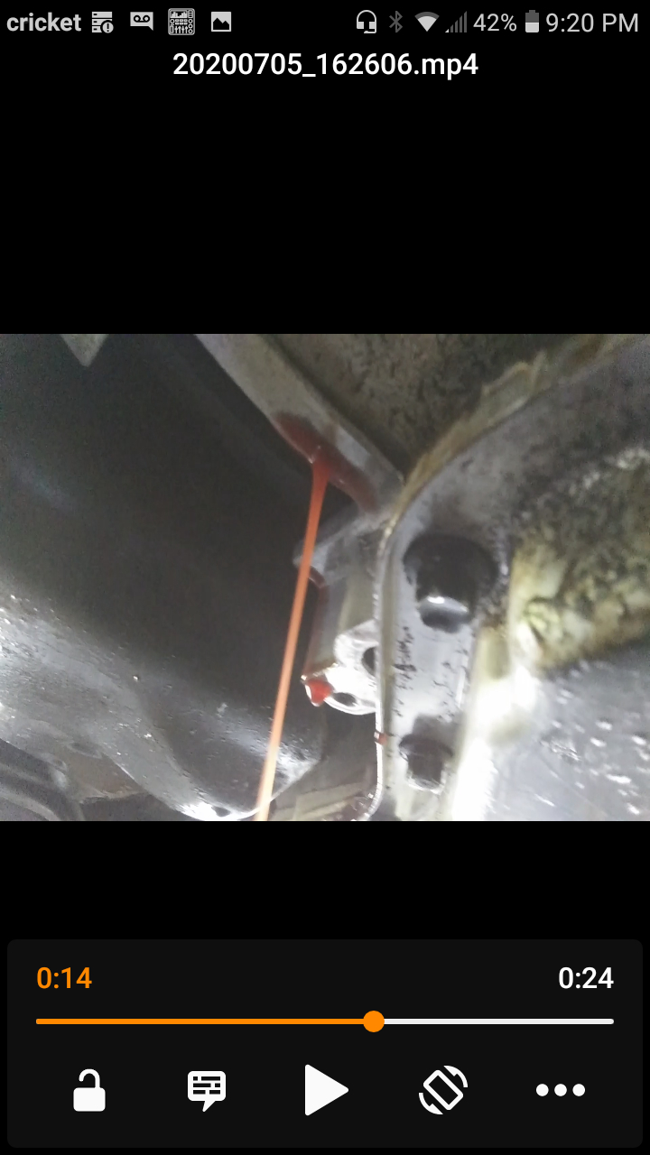

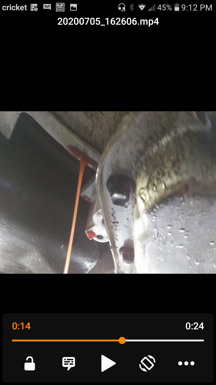

This time I got a video of exactly where the transmission fluid is coming out at under the motor. please give me some type of detailed information any kind of help on saving me money. This would honestly save my life. this couldn't have happen at the worst time. we're getting evicted I have animals. I'm freaking out. please help.

What are the pictures showing? The pictures are too dark and you cannot see anything.

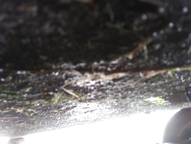

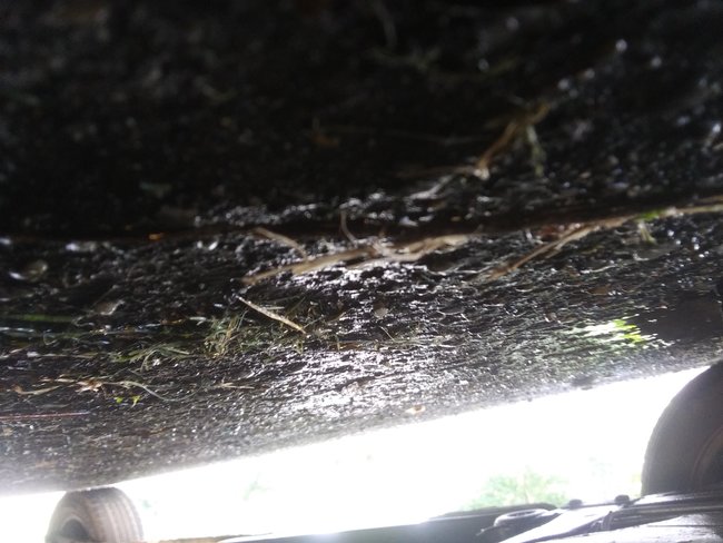

My name is Michael Underwood I'm the one that posted the issue with the car listed above regarding a transmission that wouldn't go into gear that was leaking transmission fluid. here are some pictures that I have of it leaking fluid. In one of your replies you said if I had a picture showing where it was leaking you may be able to give me some more information on exactly what it is and how much it will cost to fix it.
Jul 10, 2020 at 11:18 PM

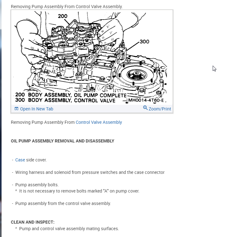

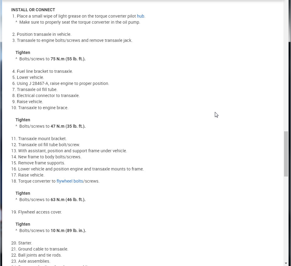

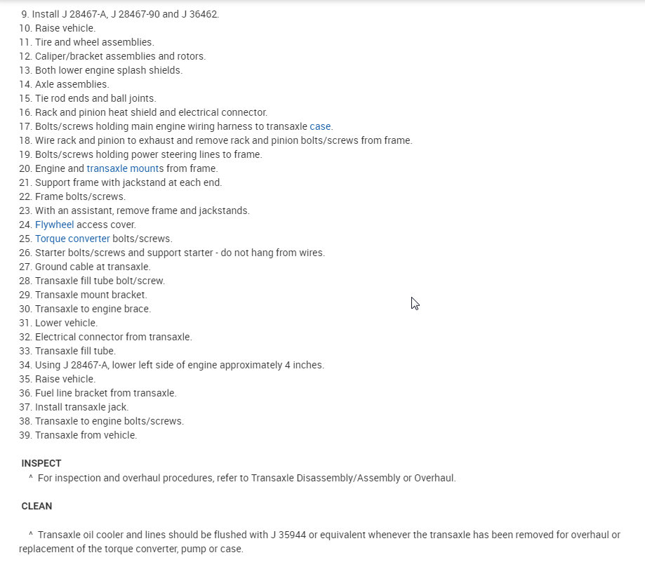

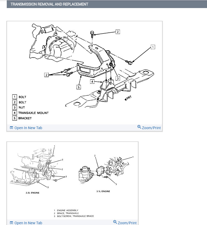

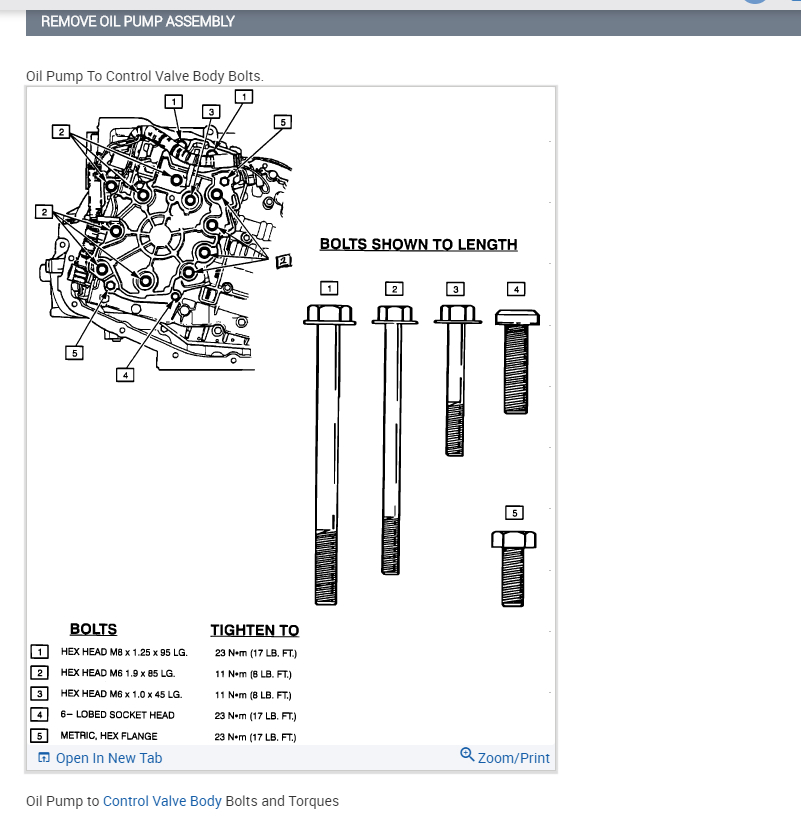

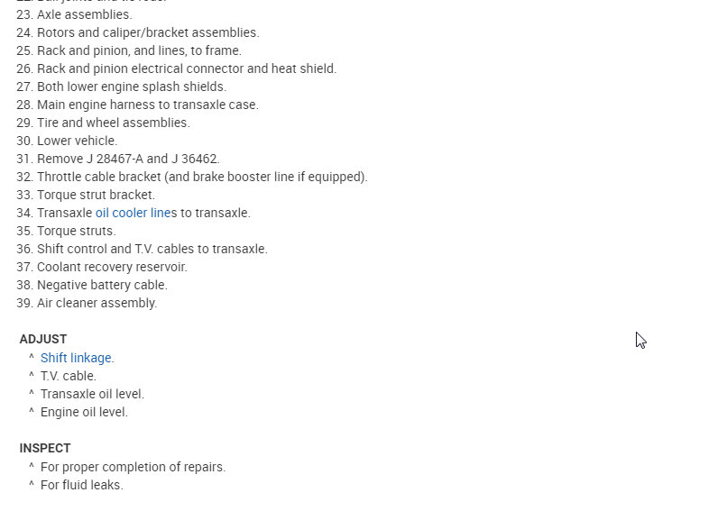

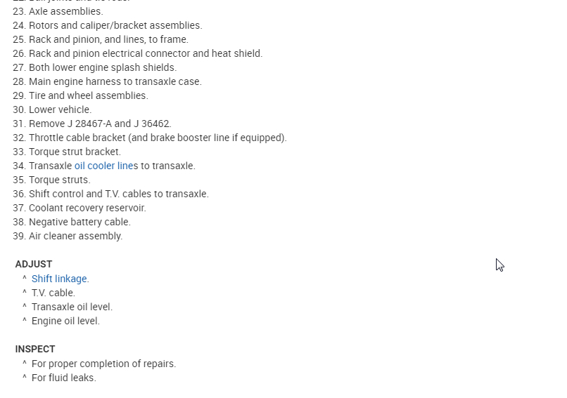

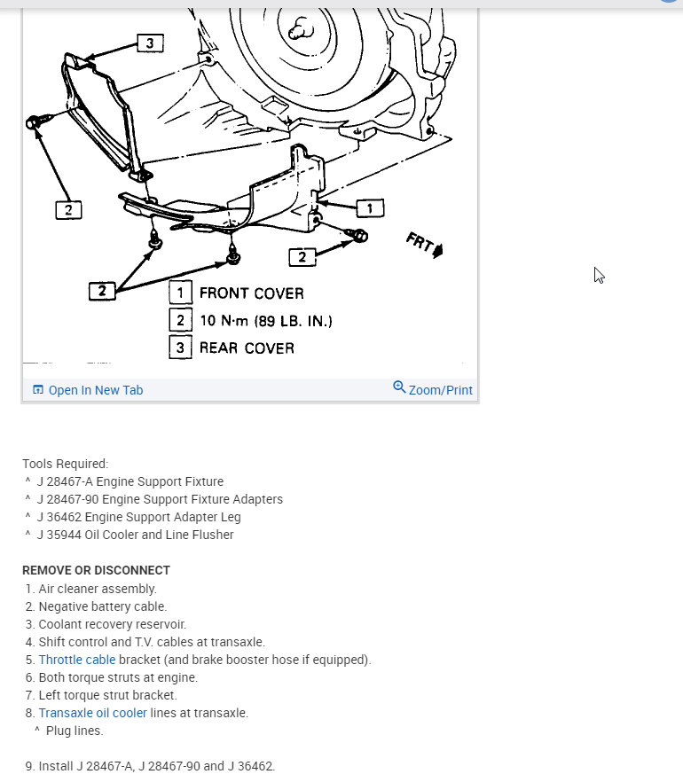

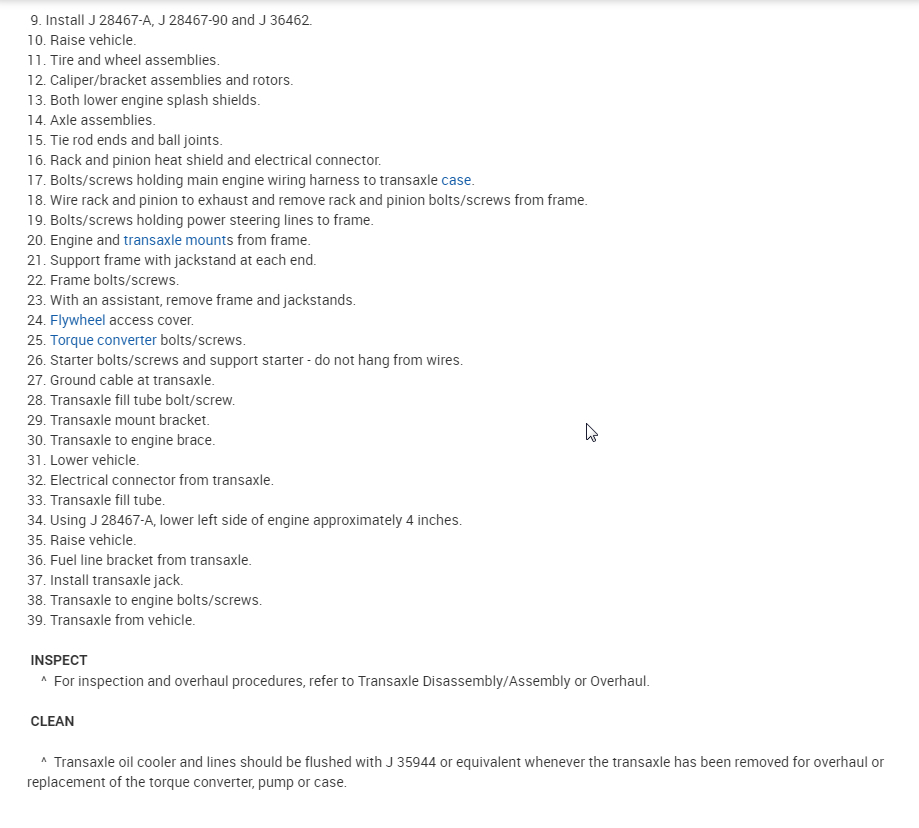

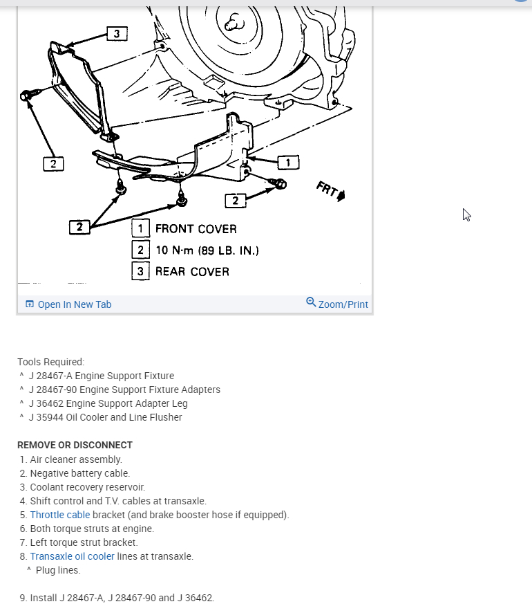

That appears to be the front pump seal if I am oriented correctly. It looks like that is coming from between the transmission and engine. If that is correct then the transmission needs to come out in order to repair it.
I attached the process on how to access the pump and remove the transmission. The time to do this is about 10 hours. So an estimate would be probably close to $1,000.00. Clearly this would vary on the shop you take it to and how much they charge per hour.
Hopefully this information helps. Thanks
