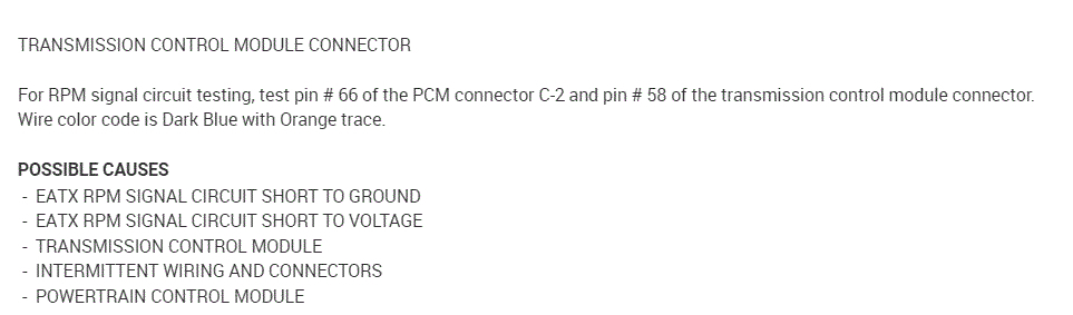

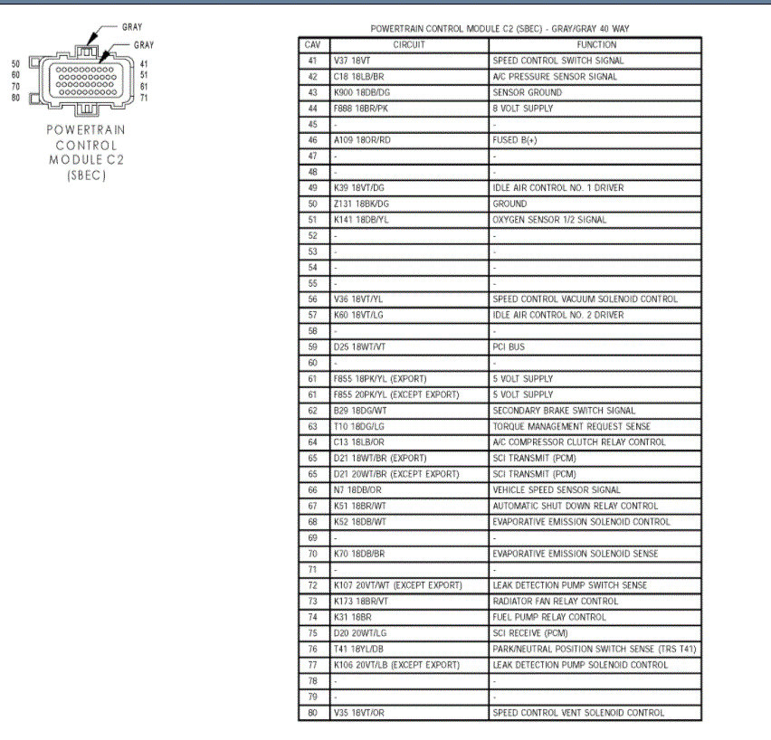

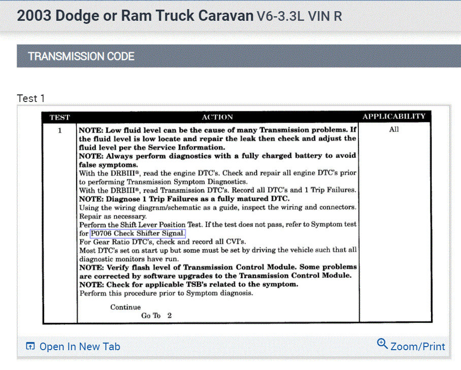

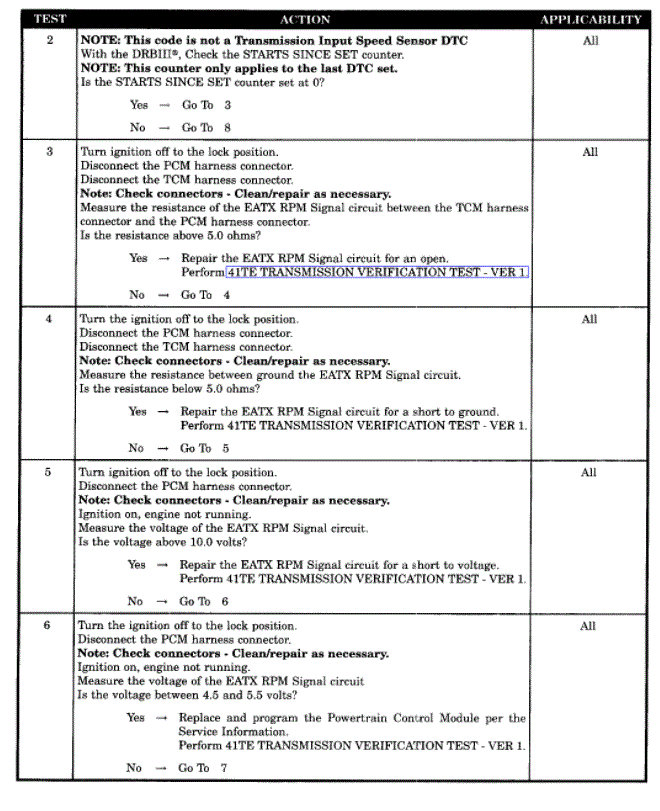

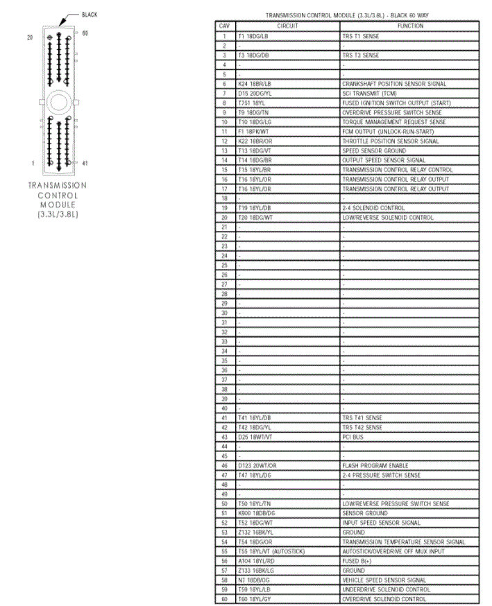

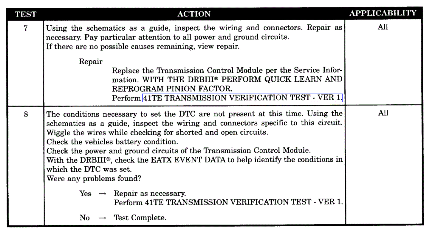

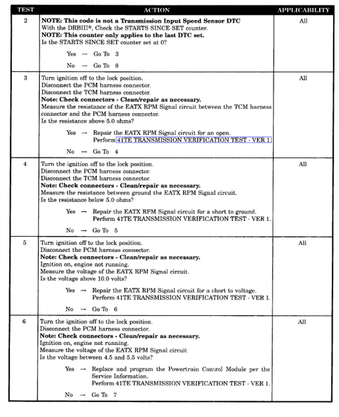

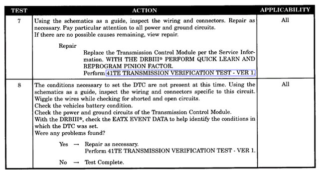

It sounds like there is a short between the PCM and transmission. I attached diagnostics below. Take a look at them and let me know if it is something you are comfortable doing.
