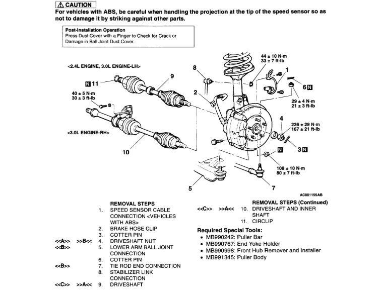

The first thing I would check is the axles in the front. If one of them fails, the car will not move.
The noise is the indicator that you mentioned.
There are two joints on each shaft. if one of the joints fail, power will not be distributed to the front wheels to move the vehicle.
https://www.2carpros.com/articles/how-to-replace-a-cv-axle-bearing
https://www.2carpros.com/articles/replace-cv-axle
