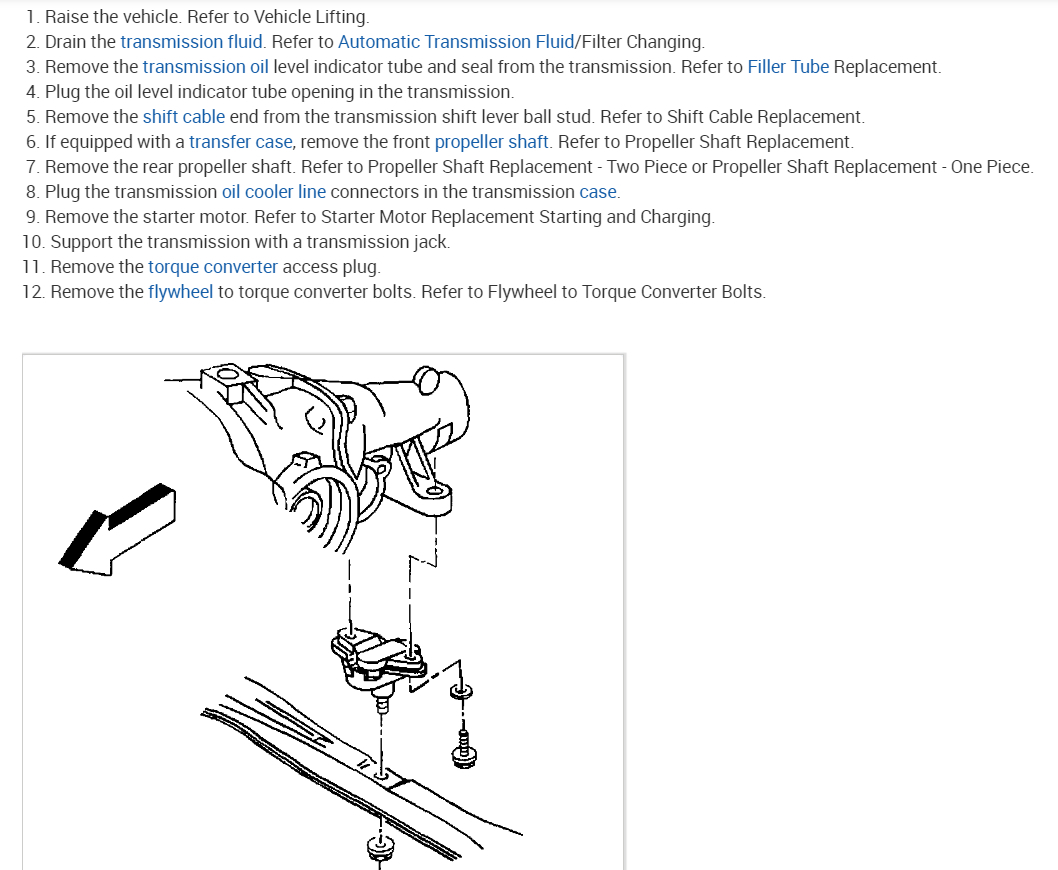

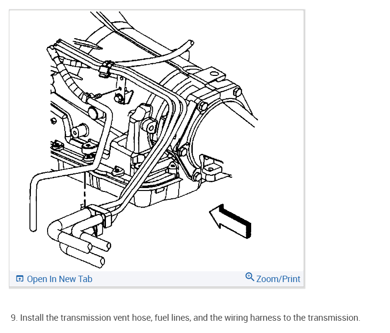

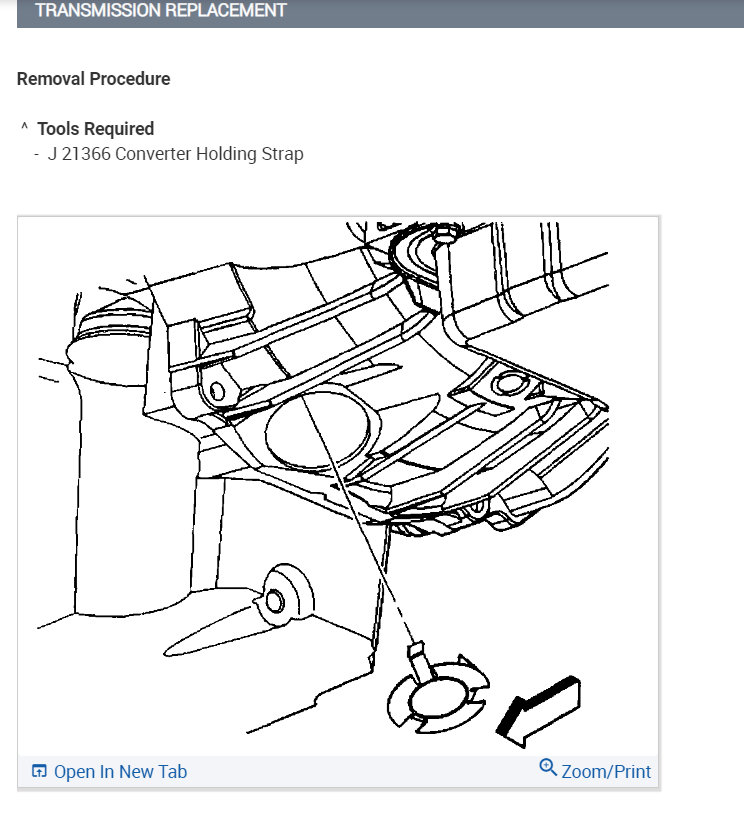

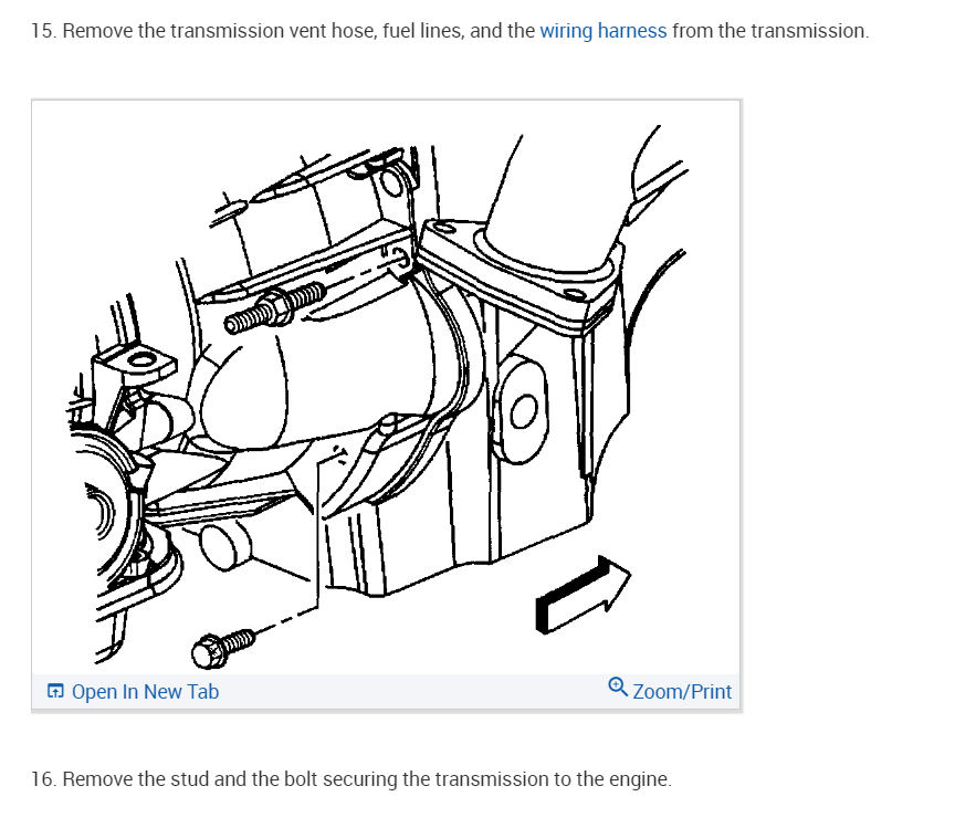

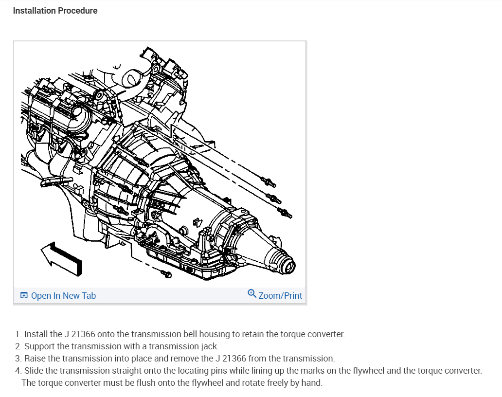

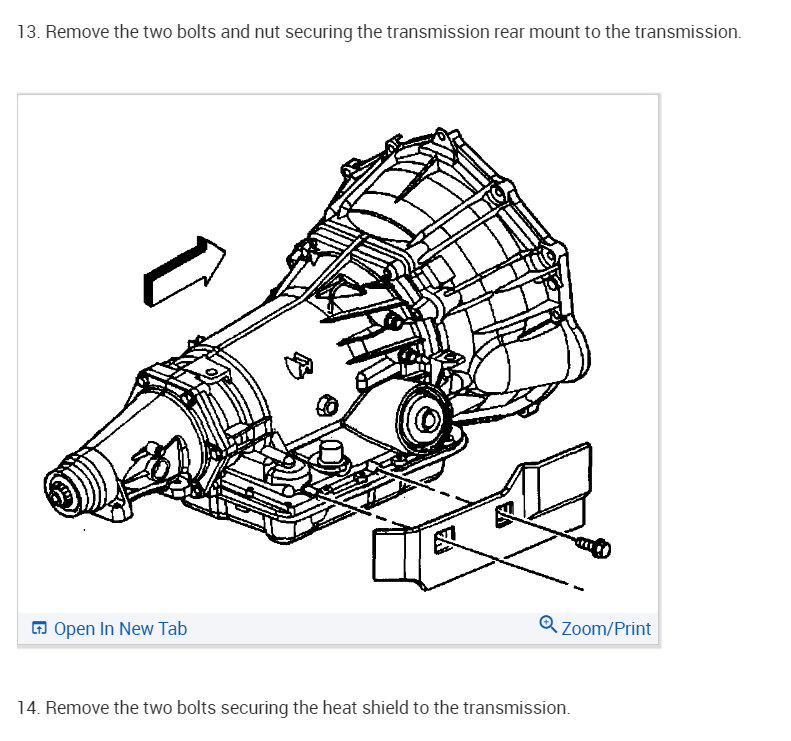

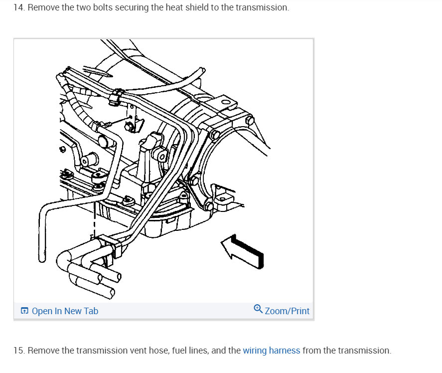

I believe any 4L80E automatic that has the same electrical connector and pin count will work. Also, the torque converter must be changed out as well because the diesel converter is different than a gas model.

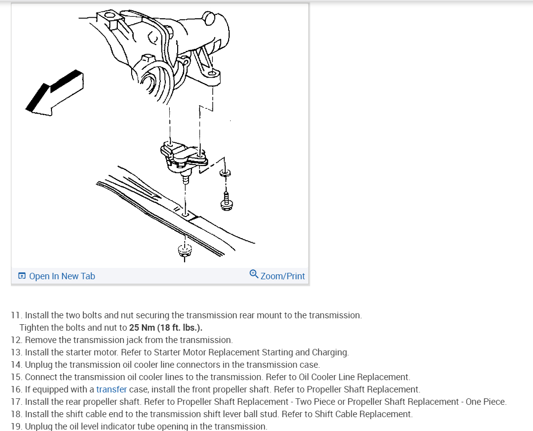

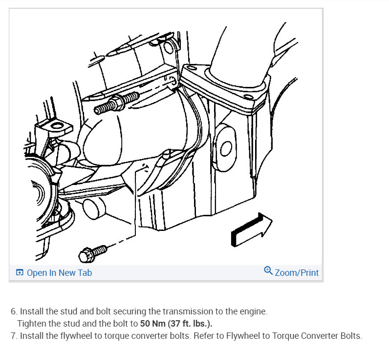

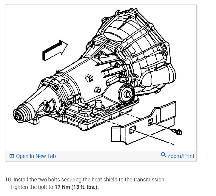

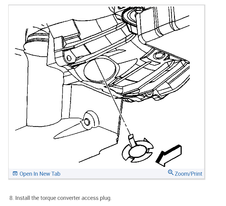

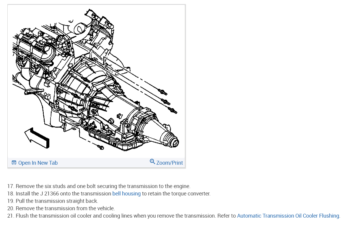

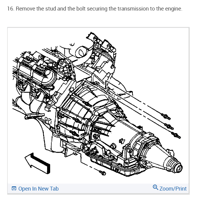

Here are two generic videos to help and how to swap out the transmission in your truck in the diagrams below:
https://youtu.be/ZC7xHVMKLRw
and
https://youtu.be/3vJAojsrfuU
