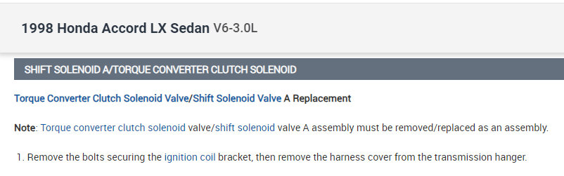

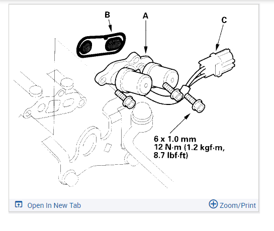

Next, if it is a solenoid related issue, I would think the torque converter shift solenoid (solenoid A) would be related, but I don't believe it has anything to do with reverse.

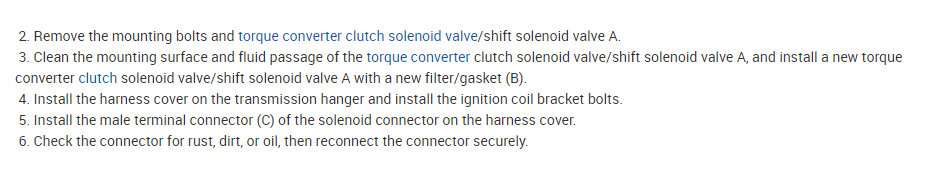

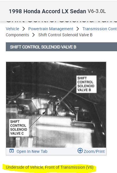

I attached directions below for replacing solenoid A. The first pic below shows the location of solenoid B and C.
