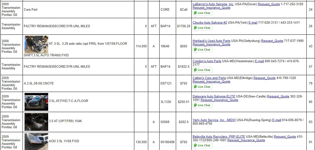

As far as the transmission, I found over 7 pages of the 3.29 ratio transmissions. Go to www.car-part.com. Enter your information and they will list the places, phone number, and emails.

Awesome, thank you for that. And I should've stated that I found some that were 3.29 but I was looking for something local to me because I need it as soon as possible and I'm in Denver Colorado. But that's awesome that I can use to 3.09 is there anything that would have to be different installing it? And would I be able to take the brand new shift solenoids and everything I just put into mine and put them into the 3.09?
