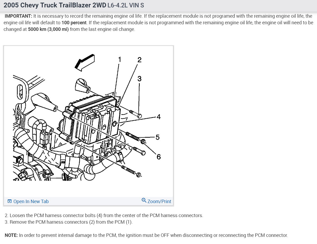

Thanks for the details on this question. it sounds like the PCM is going out, but we should run the codes again to see what comes up. here is a guide to help us fix the problem:
Please run down this guide and report back. Here is the PCM location I would check the connectors and see if there is any water damage. Check out the diagrams (below). Please let us know what you find.
