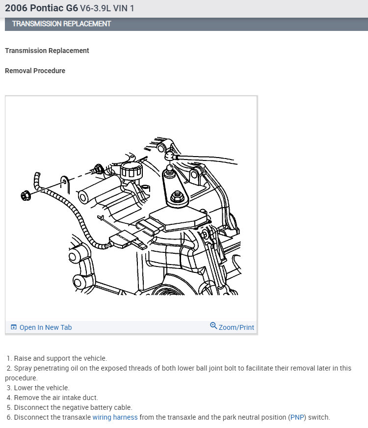

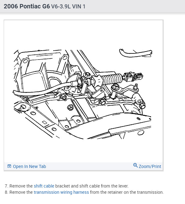

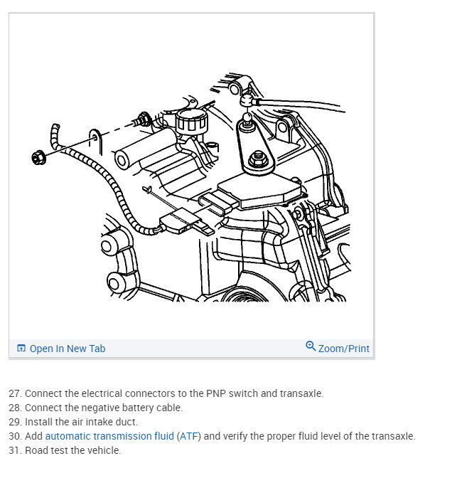

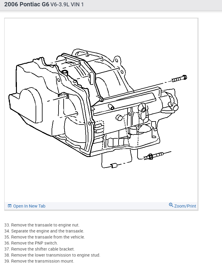

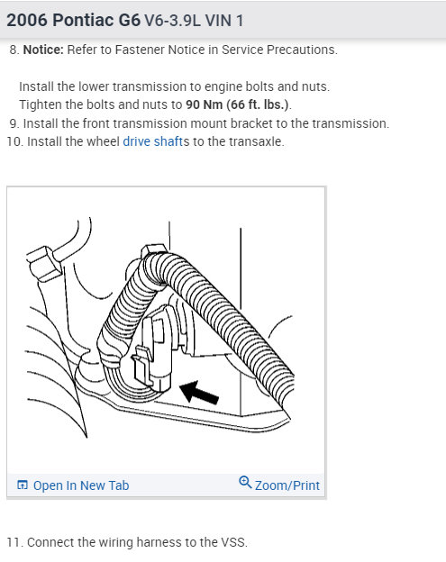

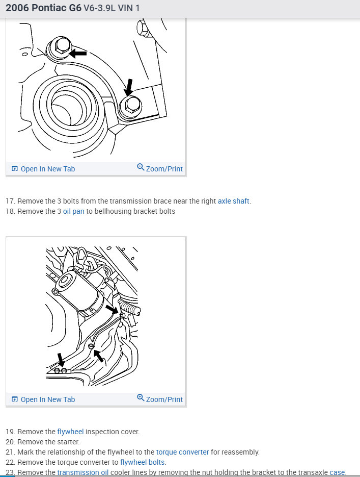

See attached for the transmission replacement procedure, for the 4T45-E transmission.
If your vehicle is equipped with the 4T65-E transmission, let me know and I will provide info on that as well.
