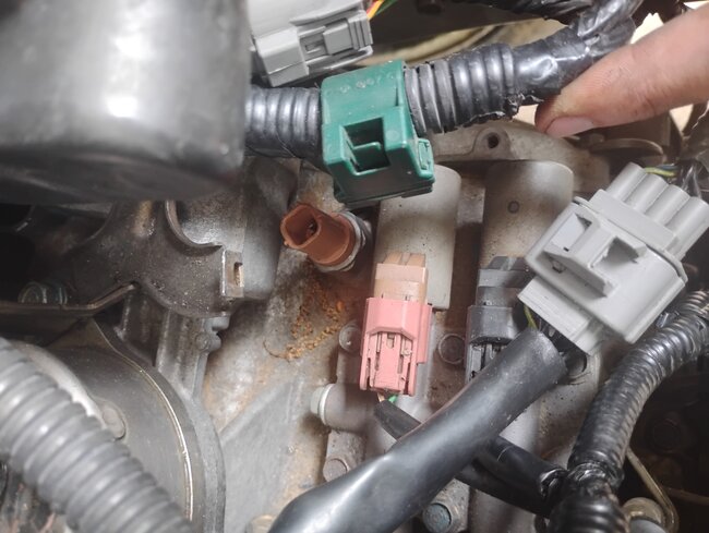

I did an av6 swap on my tl, using the transmission off a 2006 Accord V6, because my transmission had gone out. Now I have everything back together but there are 2 sensors on the transmission and there are no plugs for on the wiring harness.

Yep, this happens when swapping parts. We can't make the car use the sensors if it never had them. Can you upload an image of the sensors that are there? maybe we can rig something.

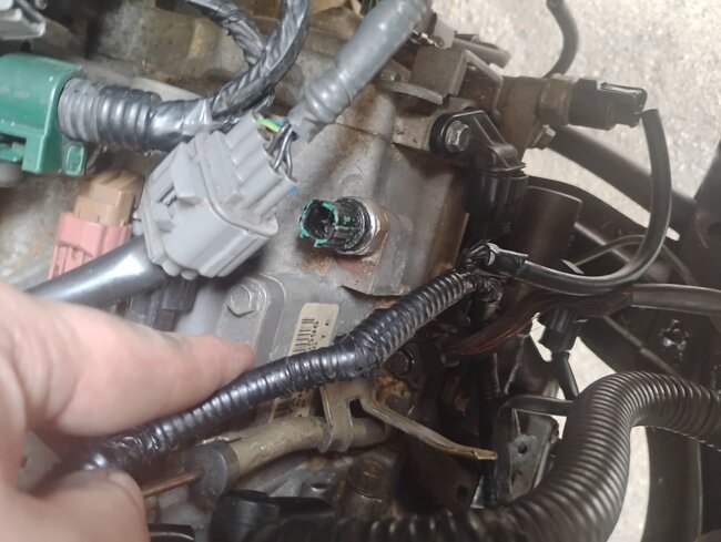

Here are the sensors.
May 29, 2025 at 2:14 PM
Thanks for the images. One looks like it can be for the transmission temperature, and the other looks like a counter shaft speed sensor. Does the transmission work okay without them? Do you have a check engine light on?
