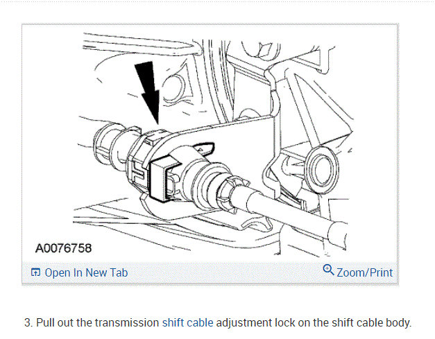

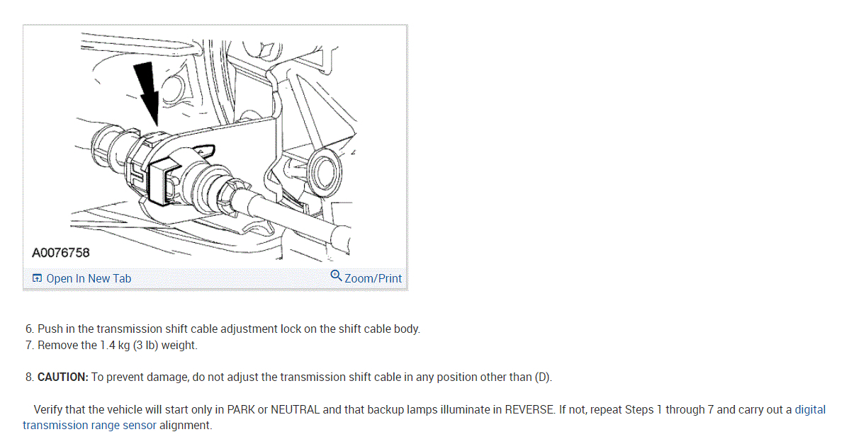

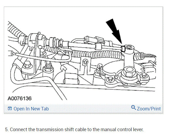

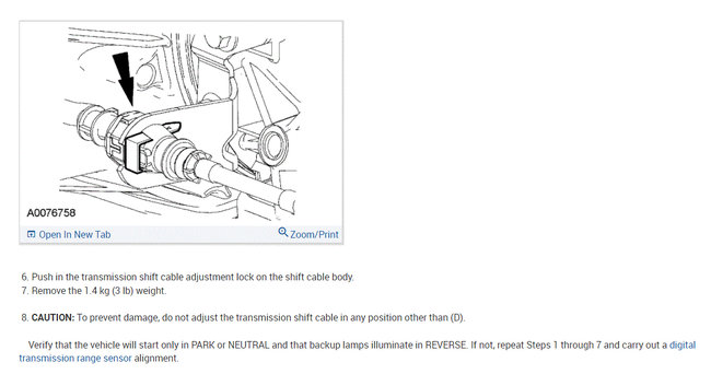

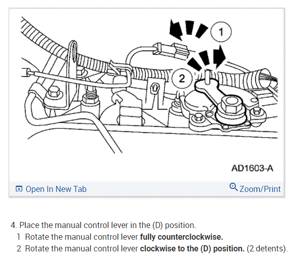

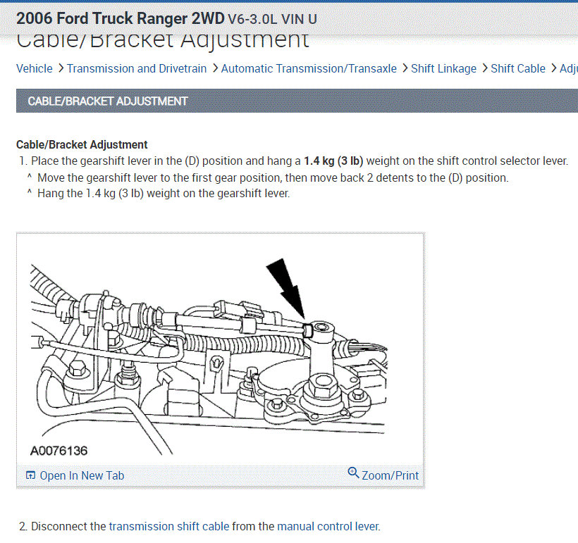

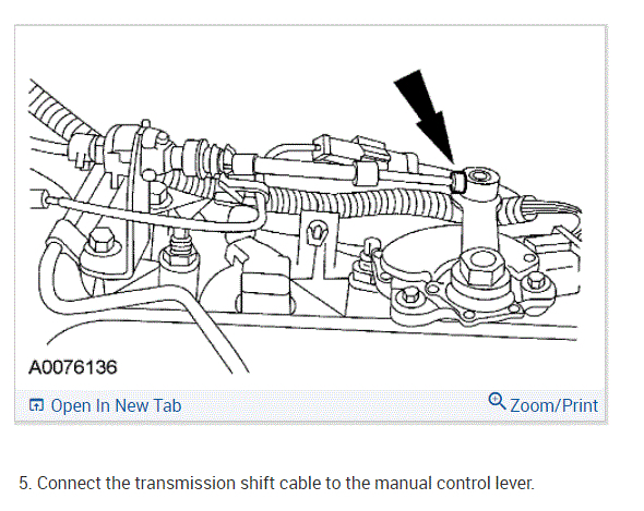

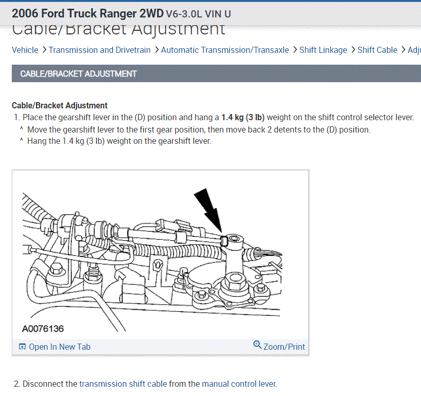

When you experience the issue, does the engine rev as though it is in neutral? Have you checked to make sure the fluid is clean and full? Also, have you checked to make sure there isn't an issue with the shift linkage? Something could be preventing it from fully engaging in each gear.
I attached directions below for adjusting the shift linkage. Take a look through it and inspect your vehicle. Make sure the connector at the manual lever on the side of the trans isn't loose or damaged.
See pics below.

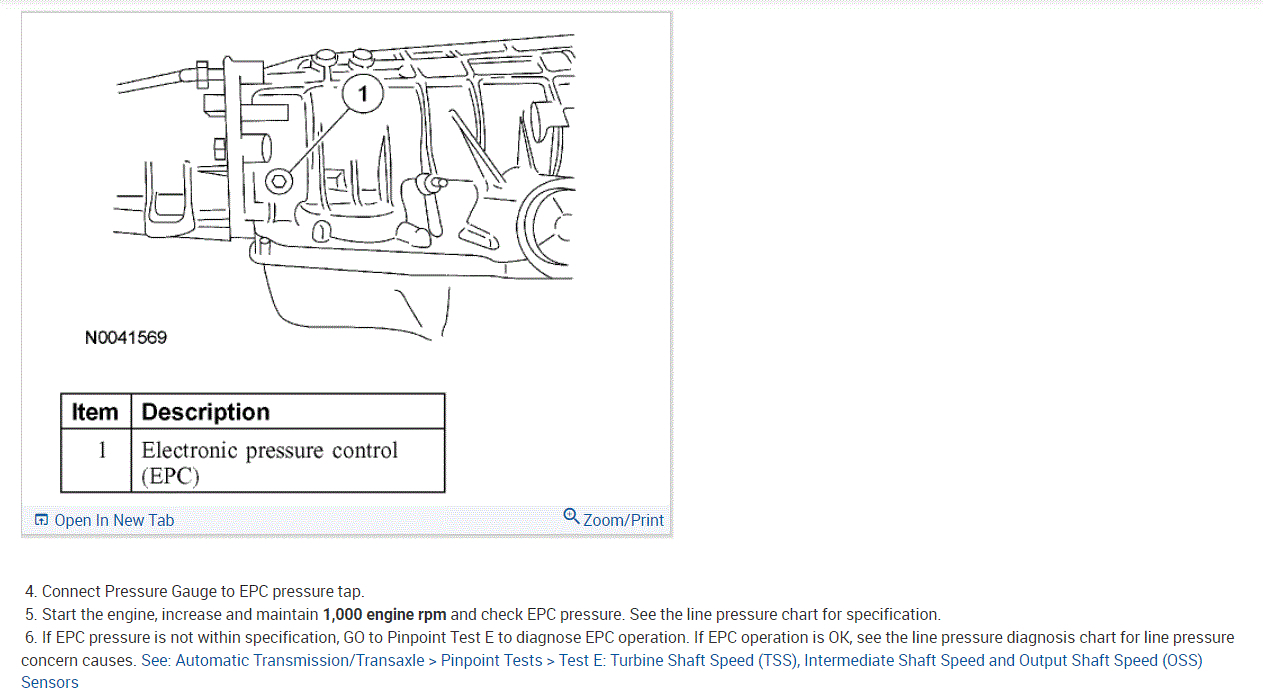

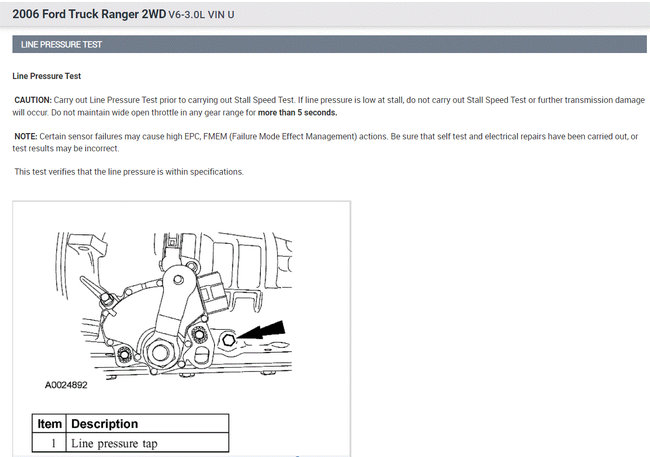

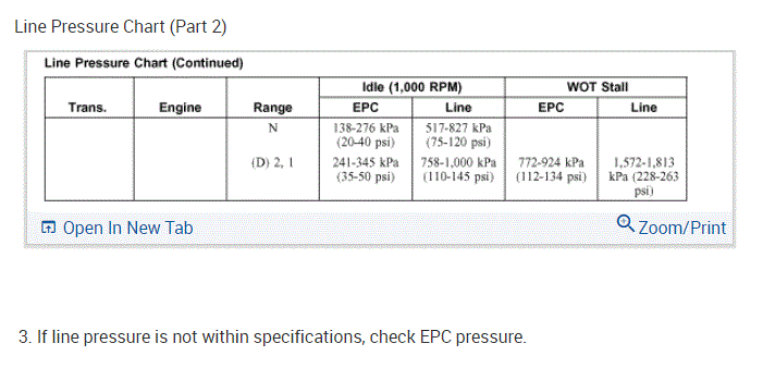

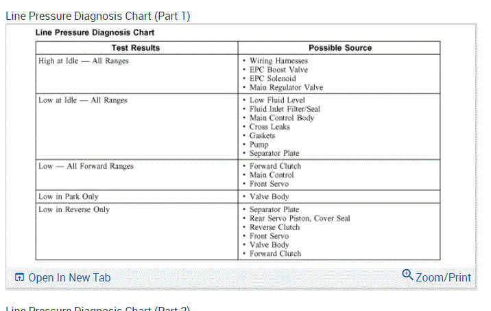

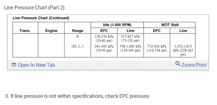

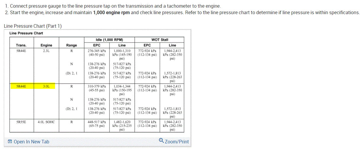

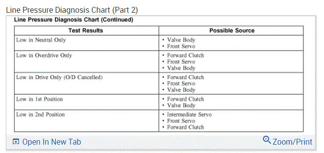

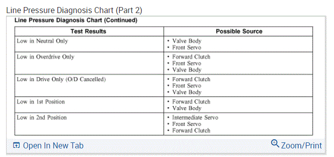

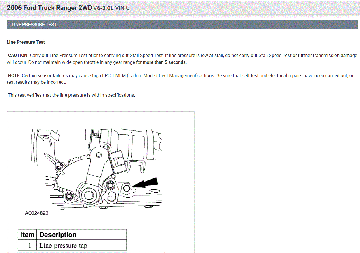

That does sound like a line pressure issue. It also could be the result of the linkage not fully engaging the transmission in the correct gear.
This could even be related to a partially plugged transmission oil cooler.
What we need to do is check the transmission line pressure. If the fluid is clean and full, we need to first confirm the linkage is tight and working properly. If that all checks good, then the line pressure needs checked.
If you look at the attachments below, I included the directions and diagnostics related to checking the transmission line pressure.
Let me know if you are comfortable performing the procedure.
See pics below.
