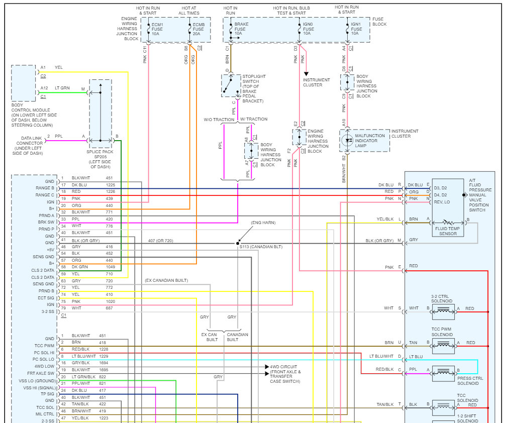

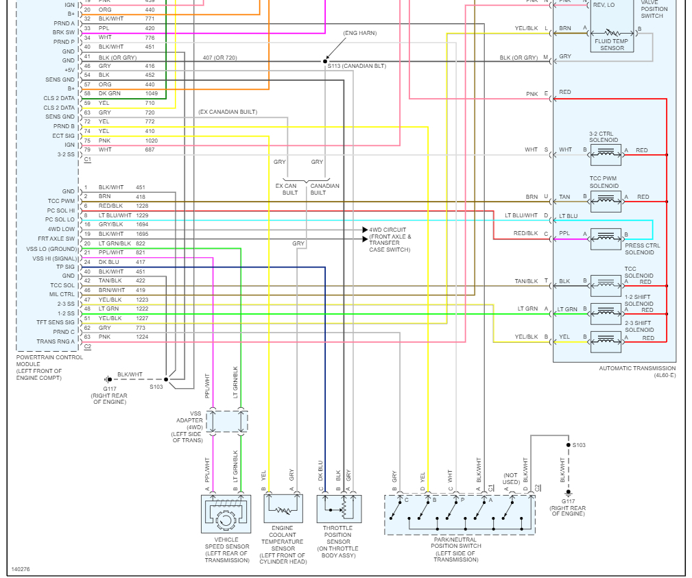

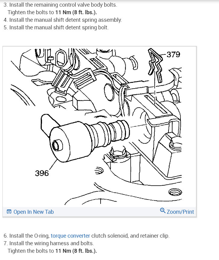

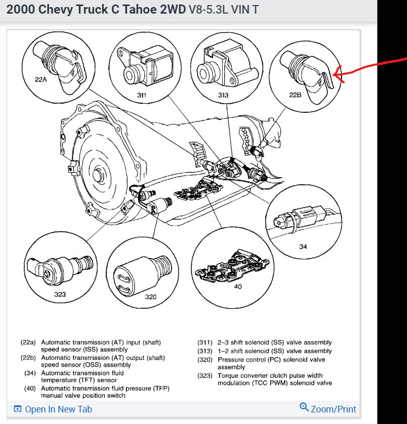

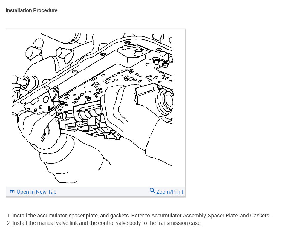

I have the vehicle listed above Z71 5.7L. codes P0740, p0753, p0785, p1860. It has a transmission in it that was refurbished 2 years ago. I installed a new create motor about a month ago. I check shift solenoid A and B. Both are working and receiving between 20 and 25 olm's about 21.7 to be exact. What are some things I can do to fix? Working on a budget.
