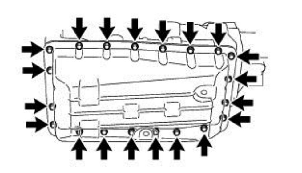

Does anyone have a picture of what the oil pan looks like in a 2014 Toyota Tacoma? I also want to make sure I emptied the right bin

Yes that is how a fuel filter acts when it is plugged. It will be restricted at lower speeds but as the volume of flow increases it will overcome the blockage and return to seemingly normal operation. I have included the diagram of your transmission oil pan in the diagrams down below.
