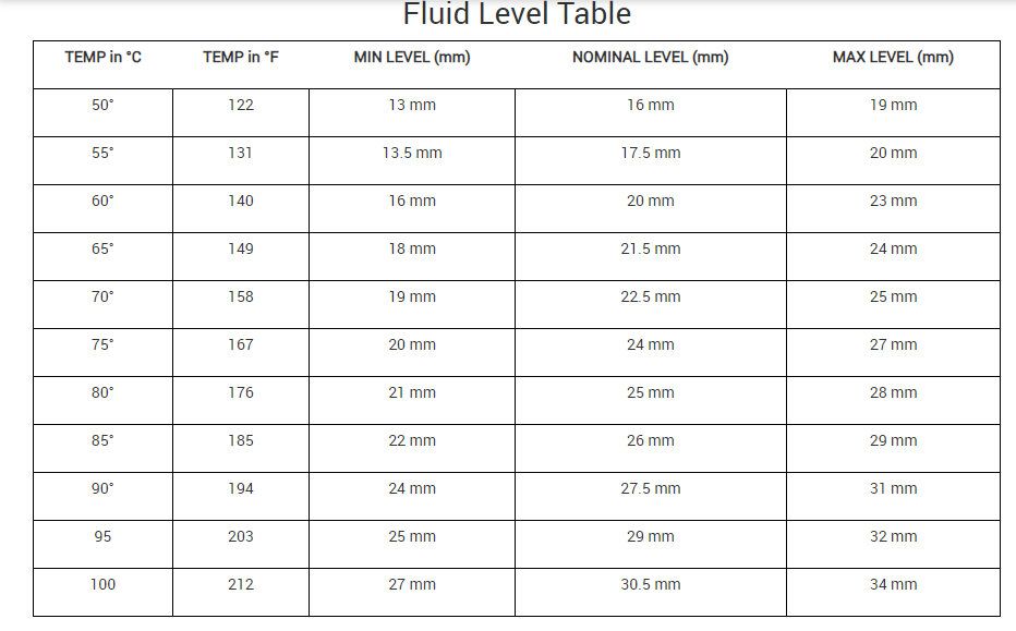

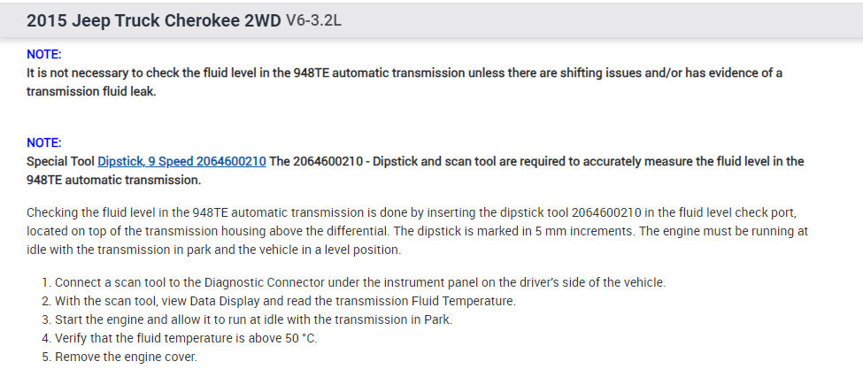

What you described sounds like the transmission slipped. The first thing I recommend is to check and confirm the transmission fluid is both clean and full. If it is low, it can cause this. Here is a link that explains how in general to check the fluid:
https://www.2carpros.com/articles/how-to-check-and-add-transmission-fluid

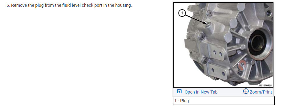

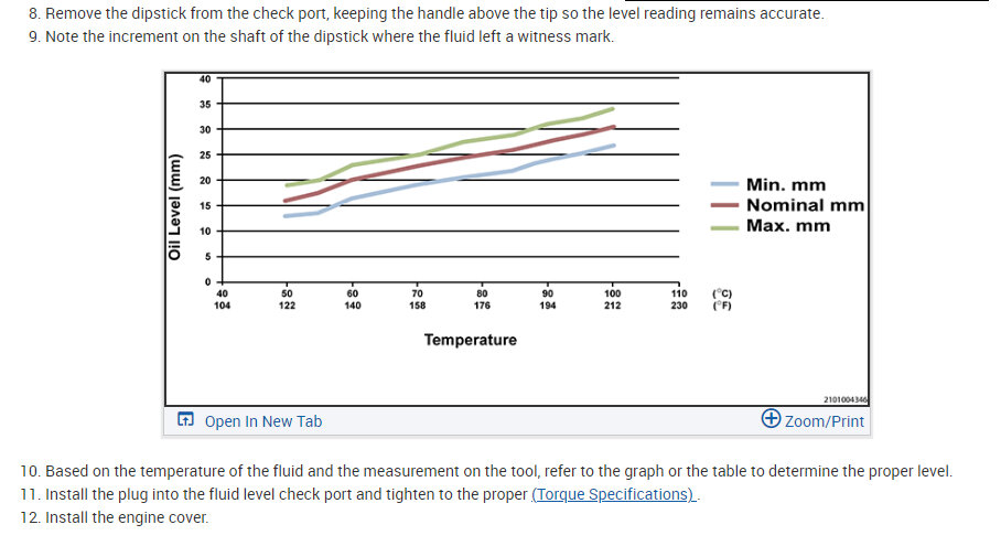

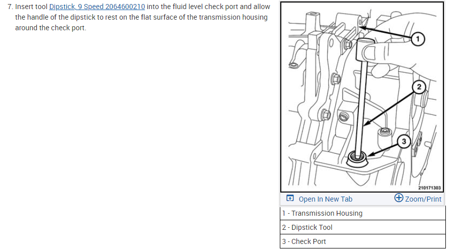

Note that the transmission dipstick tube will be sealed with a rubber plug. To check the level, you need a specific dipstick. I have no idea why they feel the need to do this, but they do. See pics below for directions for testing fluid level.
