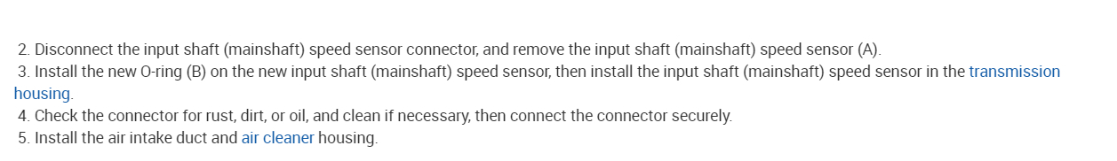

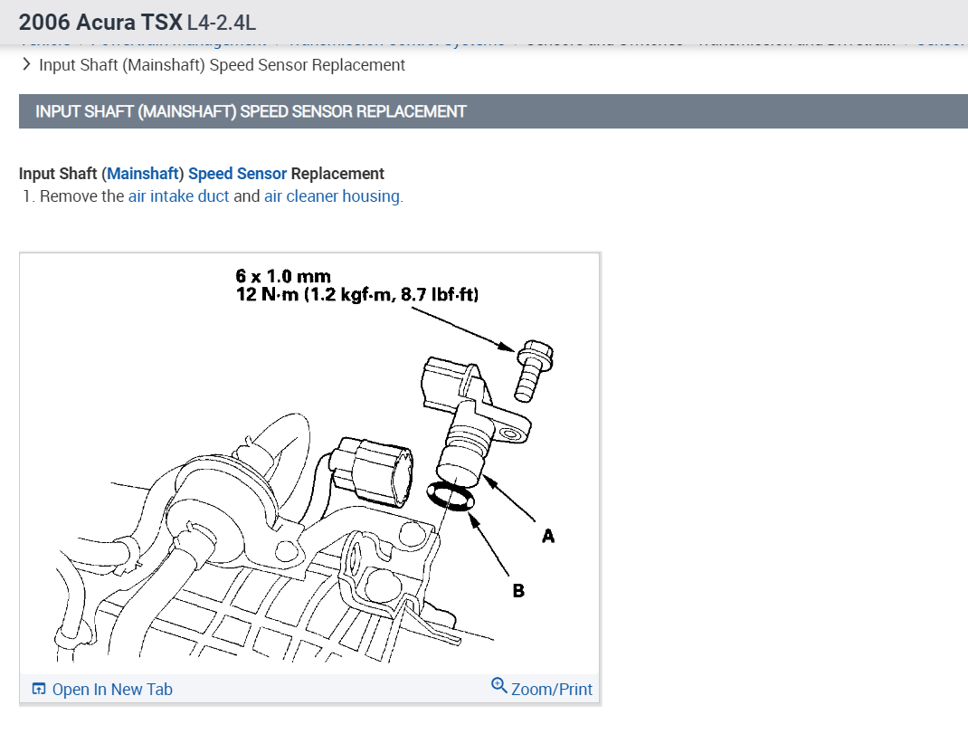

Make sure the transmission is full of fluid and if so with no codes I would replace the input shaft speed sensor which can cause the problem of the transmission not shifting. Check out the images (below). Please let us know what happens.
