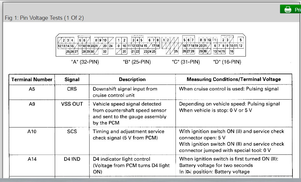

I recently replaced the transmission with a Japanese used transmission. I'm not a mechanic.so we picked up the transmission they told me to switch the speed sensor from our old transmission. the installation went well. shift cable is okay, goes into park and all gears. the car starts off in fourth gear then after it's moving you can push down the throttle and it down shifts. if I manually pull linkage into first still takes off in fourth. I thought the plugs were straight forward. could I have mixed the plugs and get these results? the car is 2.3 liter, so sorry.

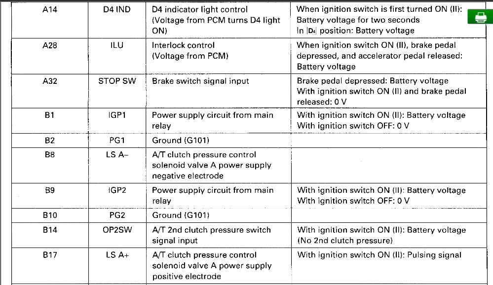

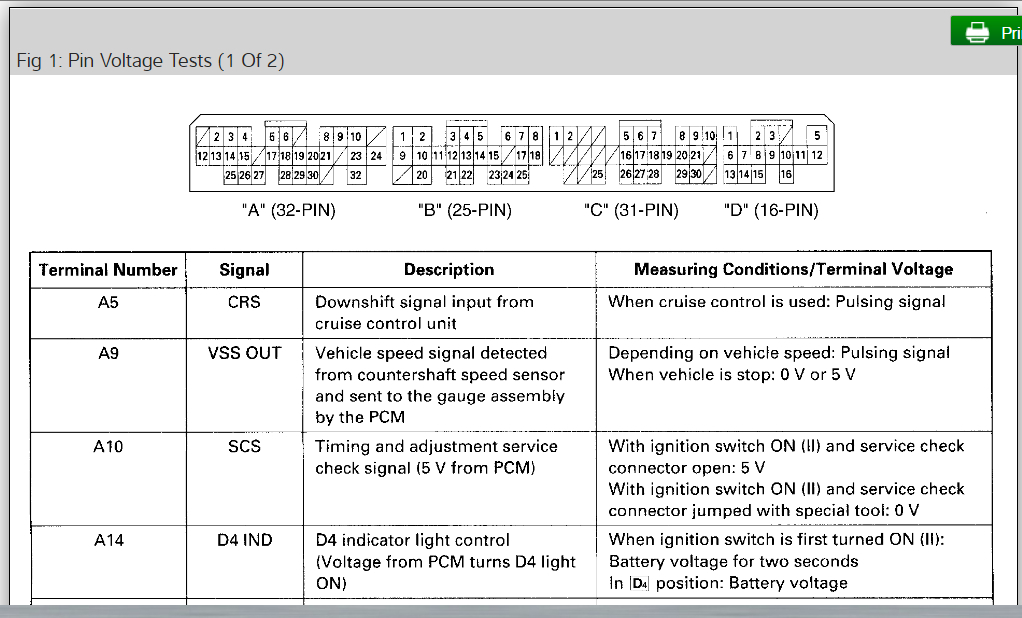

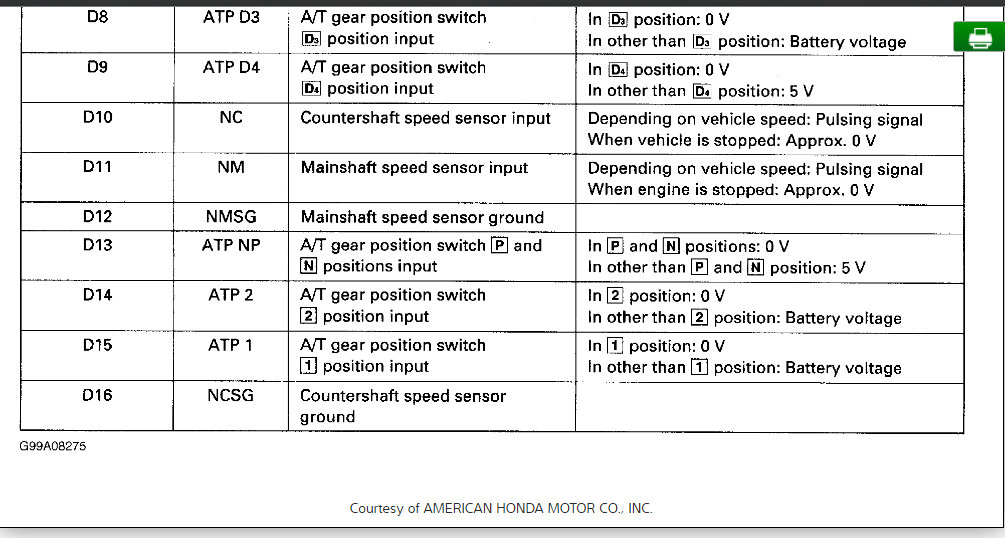

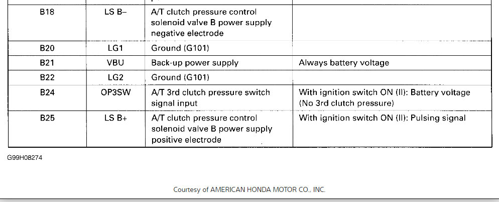

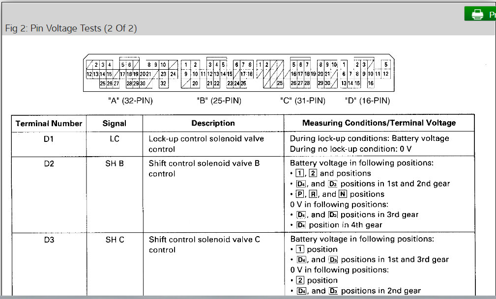

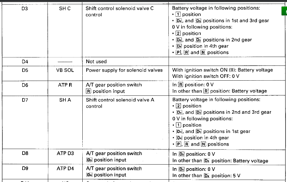

Did you switch the Transmission Speed Sensor (TSS) when you switched the transmission. The Transmission Control Module (TCM) uses this information the figure out when to shift, without it it sounds to me like it is "limp mode". I have included a link for you to go to down below:
https://www.2carpros.com/articles/reduced-power-limp-mode
and
https://www.2carpros.com/articles/automatic-transmission-problems
I have also included in the diagrams down below a voltage pinout chart for your TCM. It will give you what the expected voltage should be at every pin in the connectors that go to the TCM so you can make sure your new transmission is working as it should. Please get back to us and let us know what you find out.

JACK RUSSELL
Hello this is Jack Russell. I wanted to tell you how much I appreciate you sending me those diagrams and testing pinpoints. I was able to trace it down to a multi-plug on the solenoid B valve and without your help I would have never been able to do it. thank you so much you are absolutely the best.
