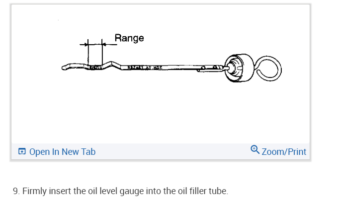

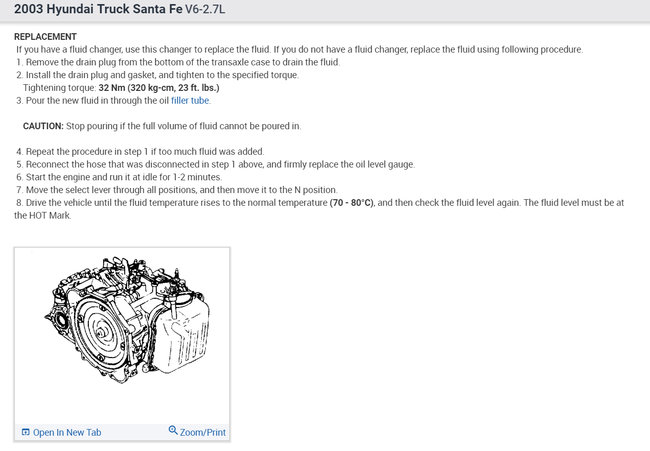

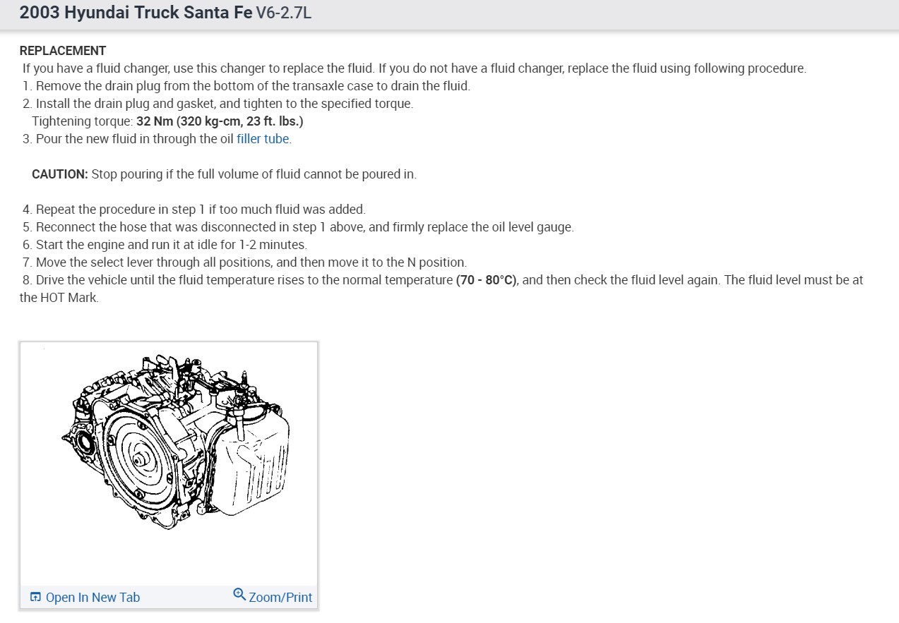

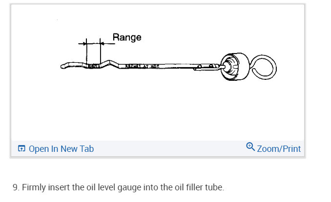

If the transmission fluid is low it can cause this issue have you checked it? Here is how in the diagrams below, I would also service the unit to look for metal in the pan. Here is a guide to help walk you through and diagrams below to show you how on your car:
