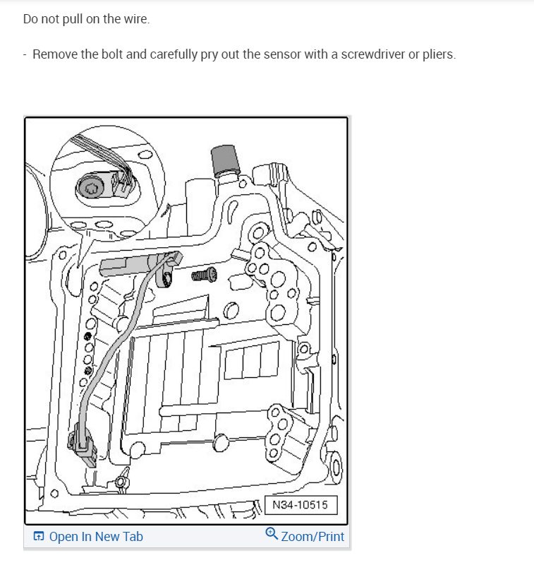

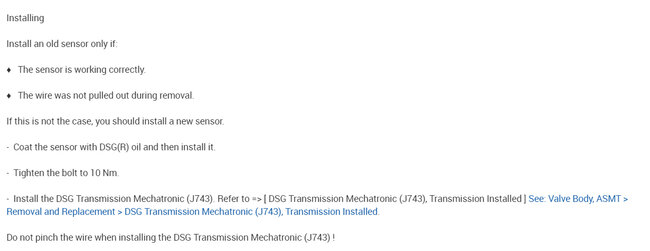

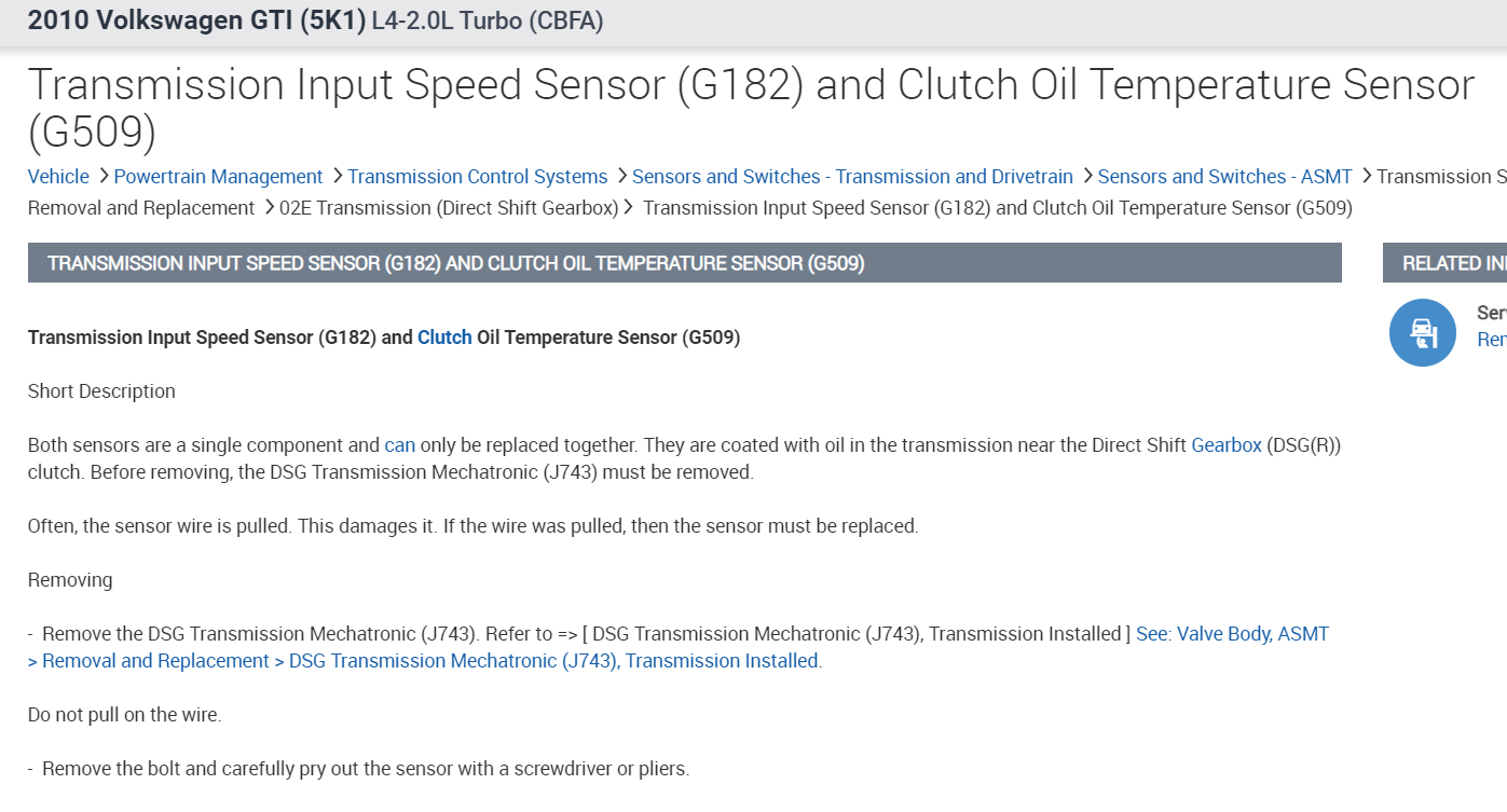

I would think the input shaft speed sensor would cause the shifting issues. I have the repair in the images below in case you need them. Check out the images (below). Please let us know what you find.
