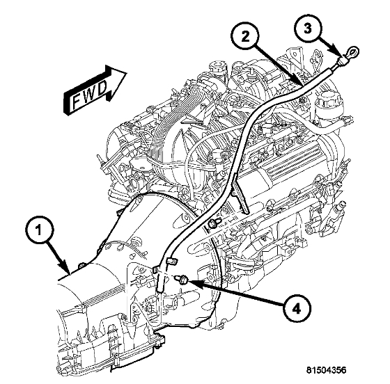

Since this has the 3.7L, you may be able to reach them from the top as well. I know if you remove the transmission dipstick tube, it helps open up the passenger side, so try that if you already haven't.

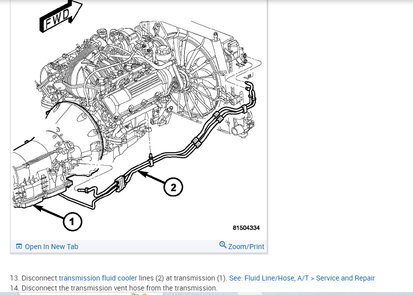

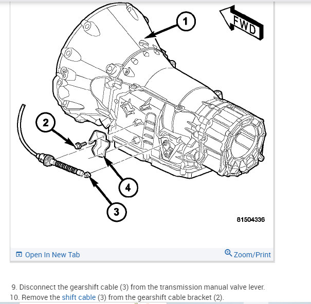

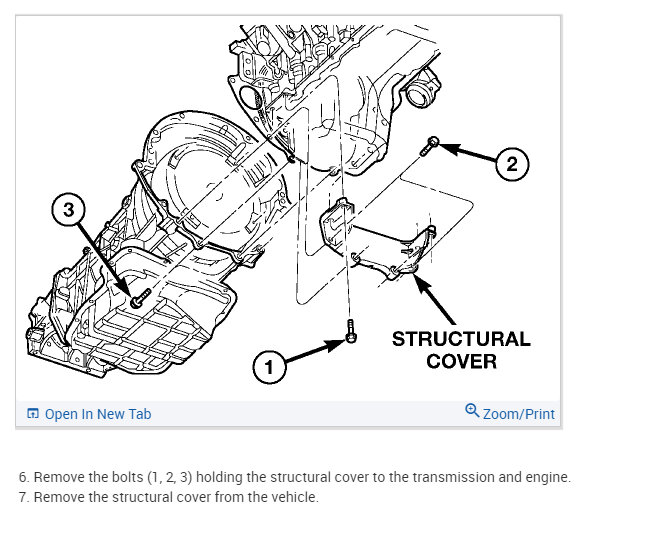

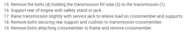

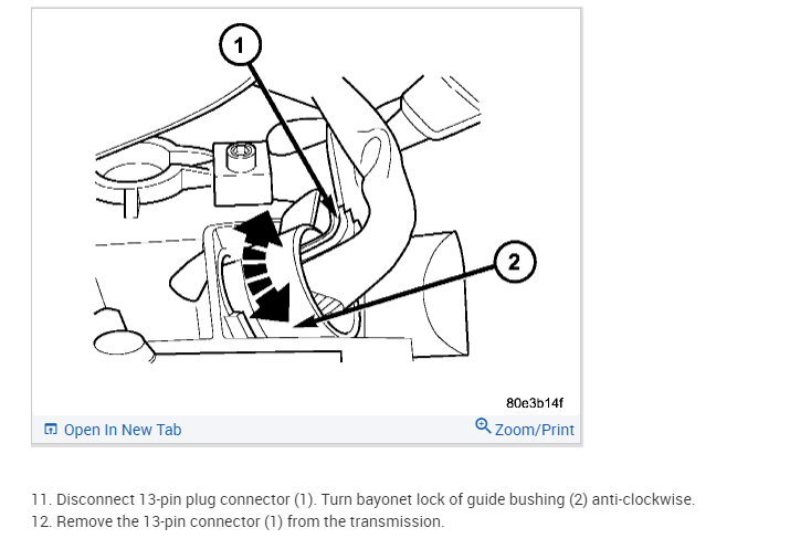

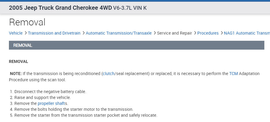

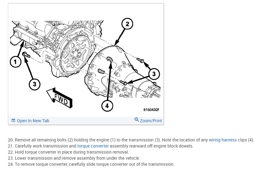

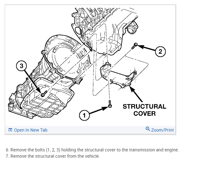

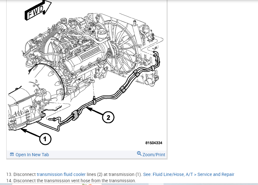

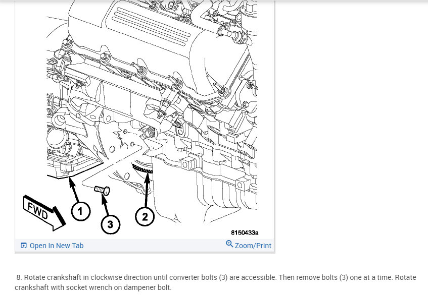

I attached the directions below from the manual. See if anything helps.
See pics below.
