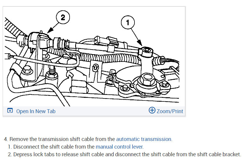

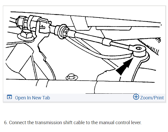

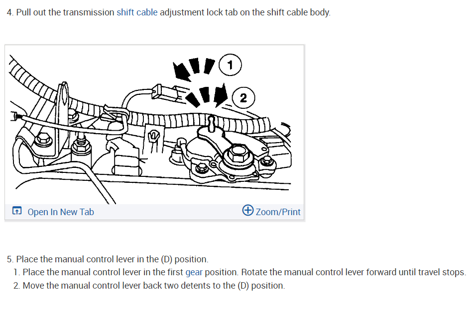

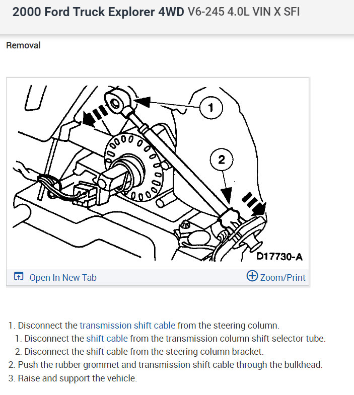

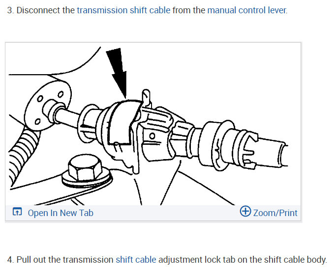

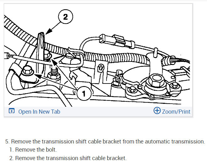

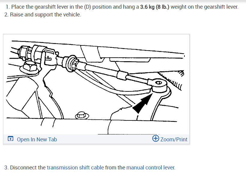

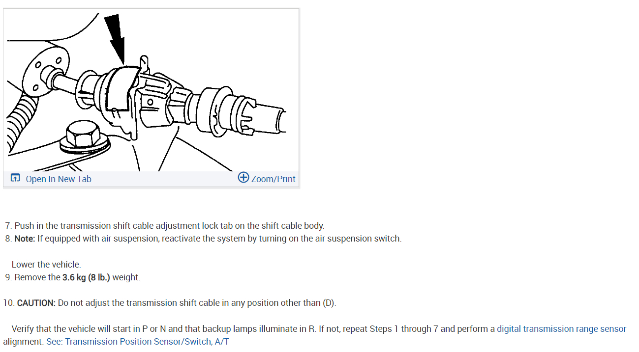

It sounds like the shift cable needs to be replaced and adjusted. Here is how the job is done and I included how to adjust the shift cable after installation. Check out the images (below). Please let us know what happens.
