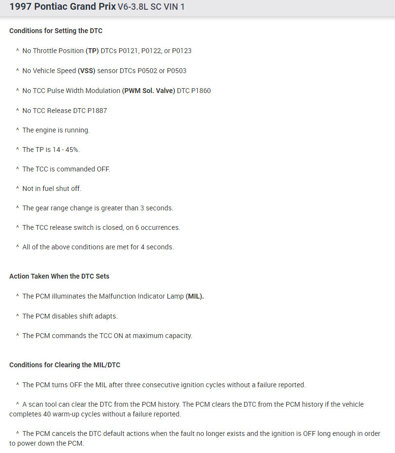

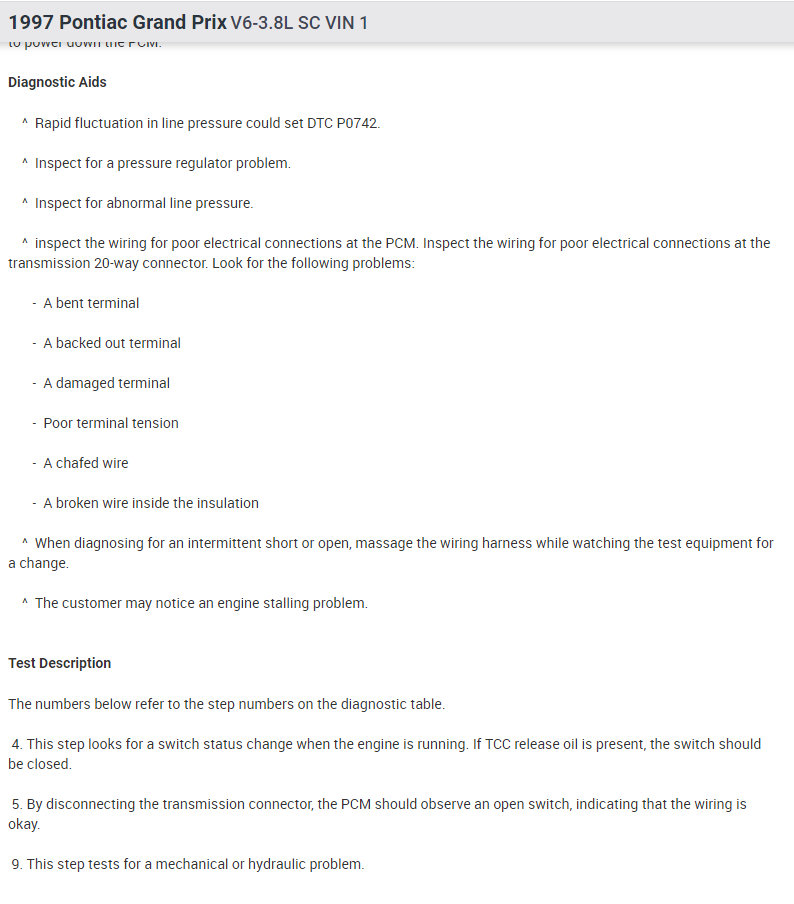

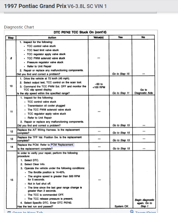

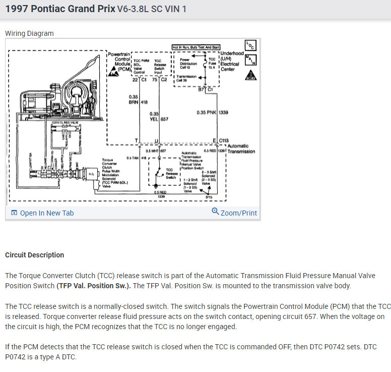

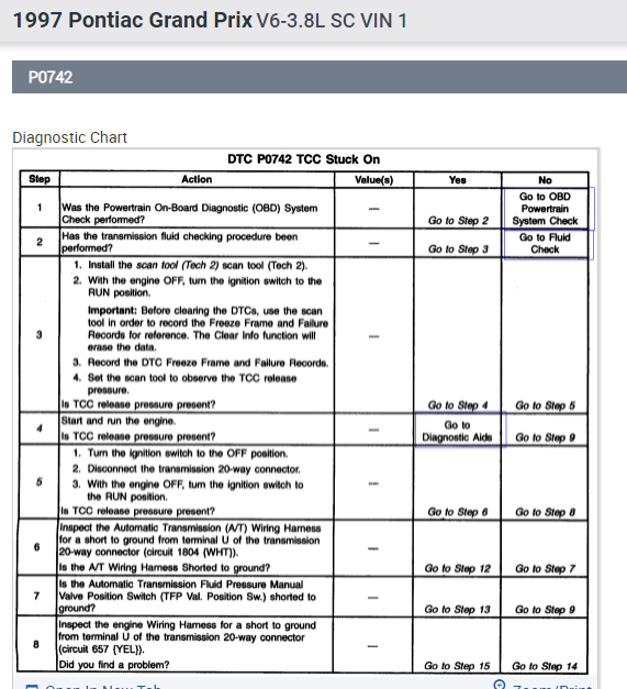

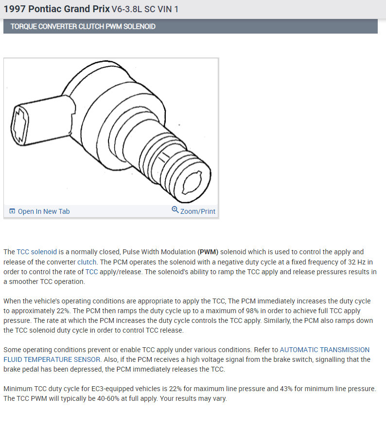

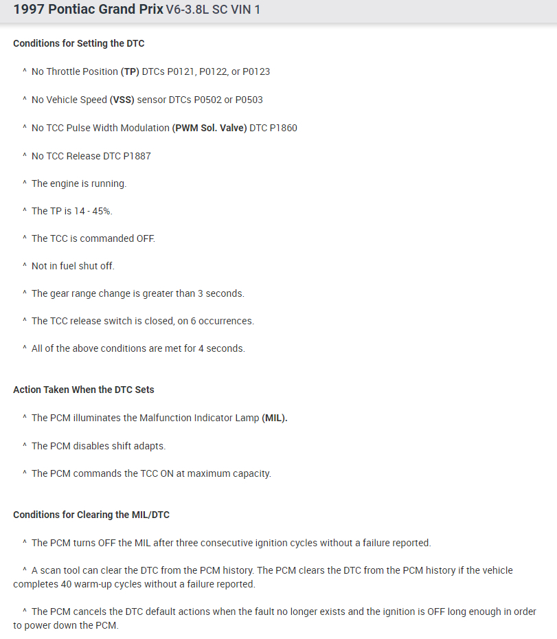

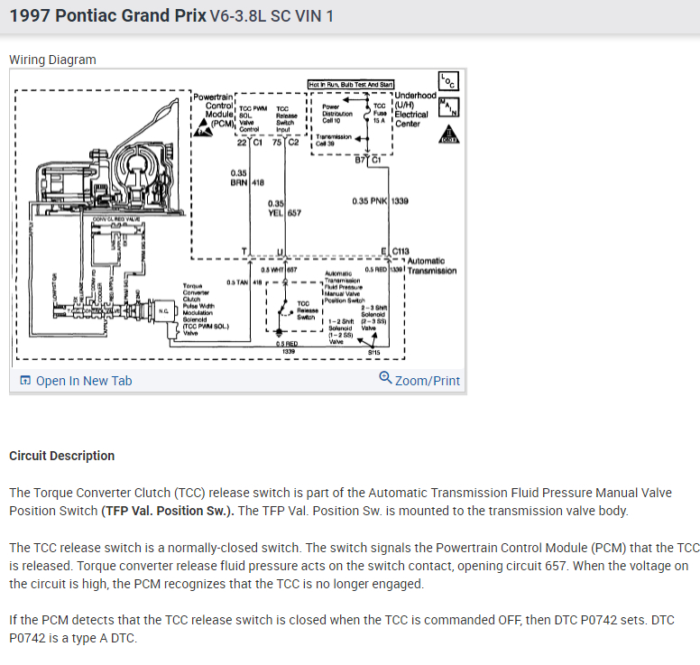

The code: P0742 - TCC (torque converter clutch) Stuck On.
This can be due to a faulty powertrain control module or torque converter clutch switch.
It could also be an issue with the switch not getting enough power or connection issue.
I have attached the diagnostics for that code (look below). This can help determine what is the reason you are having this issue.
