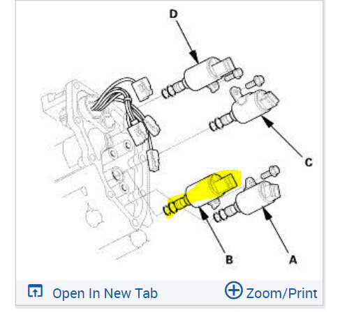

I have a shift solenoid b stuck off I think it's code p0756 or 757 and I was wondering if you could give me some guidance on a how to repair?
Dec 16, 2023 at 8:47 PM
I checked both codes, and they are both related to shift solenoid B.

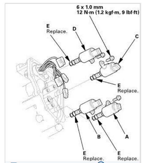

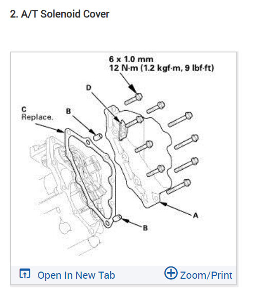

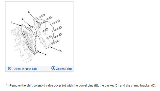

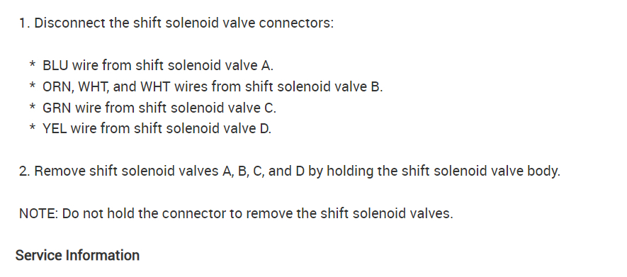

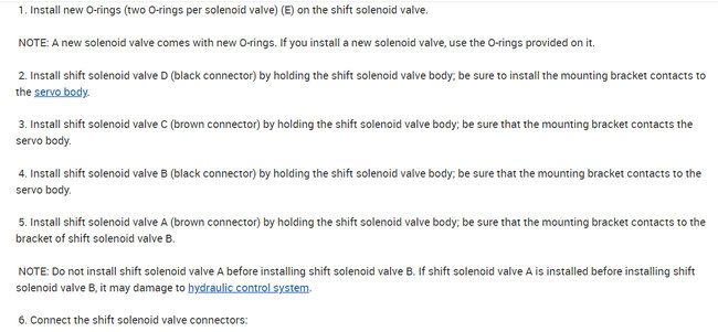

As far as the solenoid, you need to remove the side cover from the transmission to access it. There are several solenoids, and the directions indicate to disconnect all of them. However, you should be able to just disconnect the one being replaced.
The directions below are for replacing the solenoid. Take a look through it and let me know if you have questions. Also, drain the transmission fluid before removing the cover.
Let me know if this helps.
See pics below.
