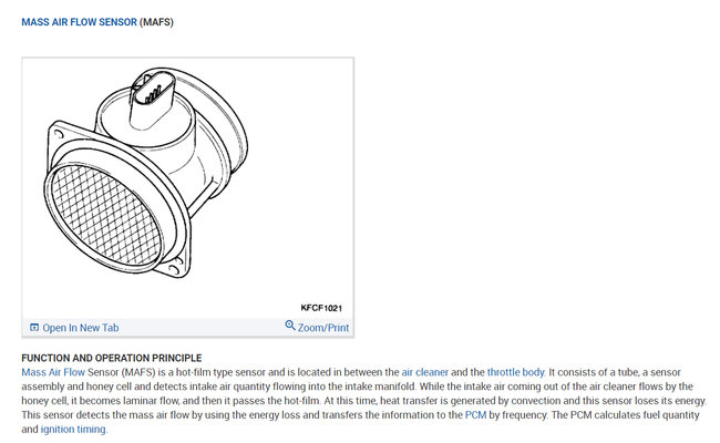

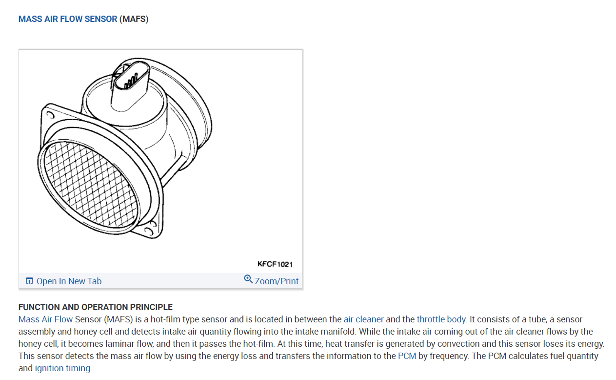

Codes do not tell you to replace anything. They tell you there is a failure in that system.
https://www.2carpros.com/articles/how-a-mass-air-flow-sensor-works-maf

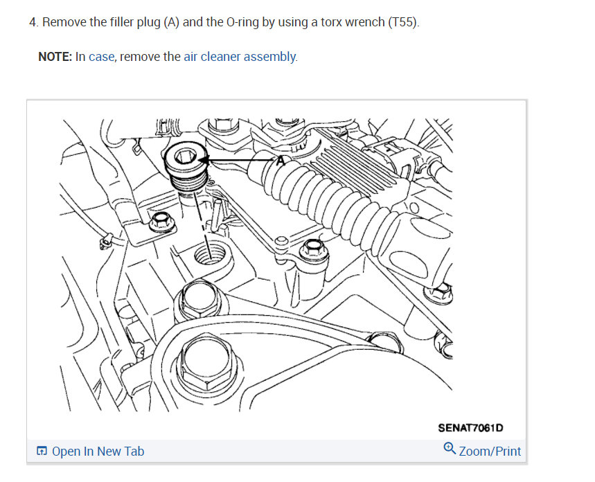

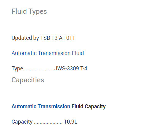

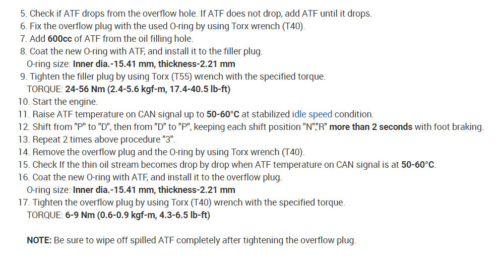

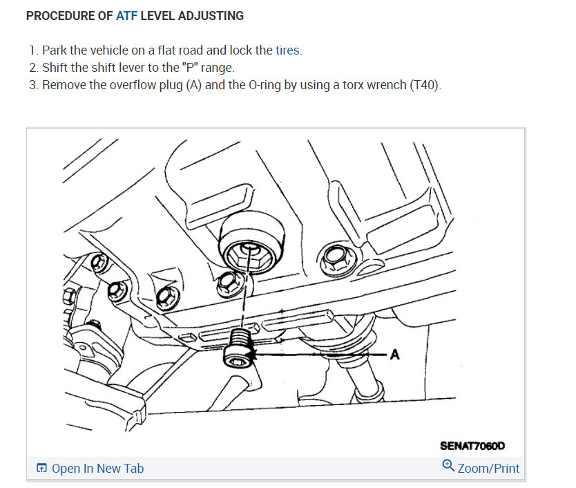

https://www.2carpros.com/articles/automatic-transmission-problems
Have you changed the fluid in the transmission?
