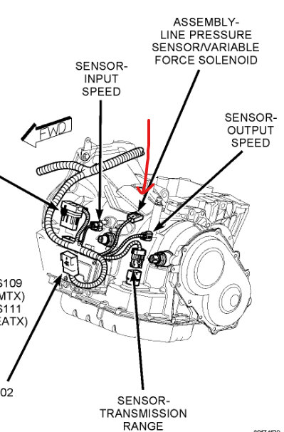

Can you tell me the code number? that would help. Here is the location of the line pressure sensor is this what is not connected to the 2005 transmission? If so this will be the problem. Please come back with the code so I can check it out further for you. If it does have a the sensor and you change it out be sure to clear the codes, also please start a new question for the overheating issue.

Can you show me where it would be at on the 2005 rl transmission please?
Aug 8, 2025 at 1:08 AM
Check the image in the post above :)

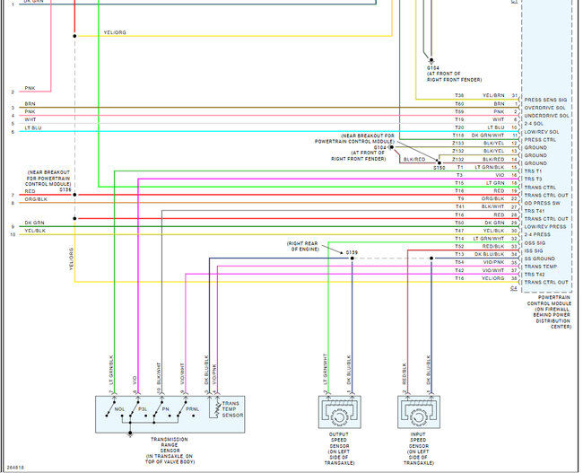

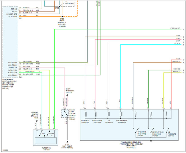

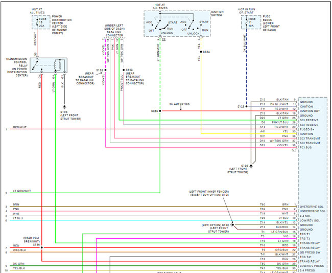

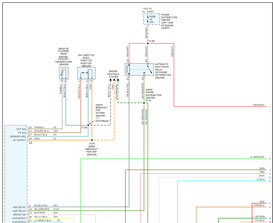

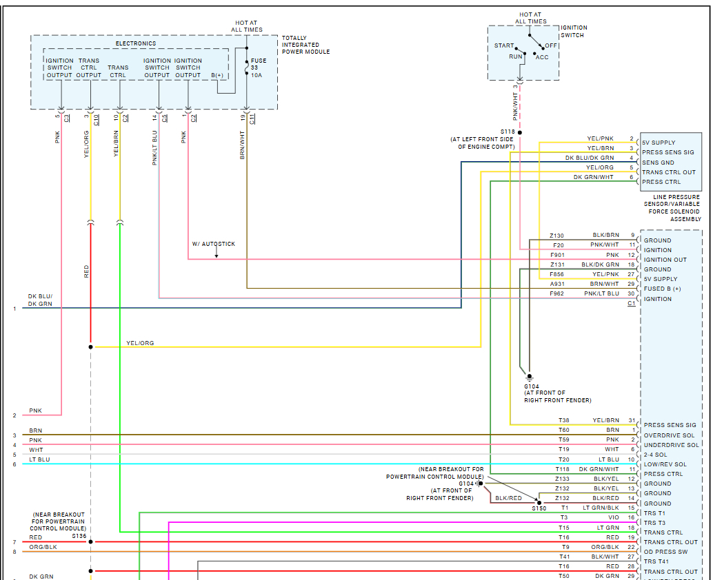

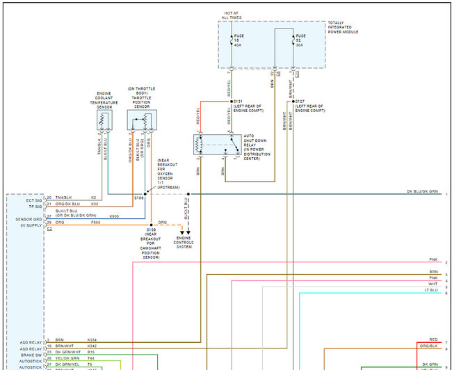

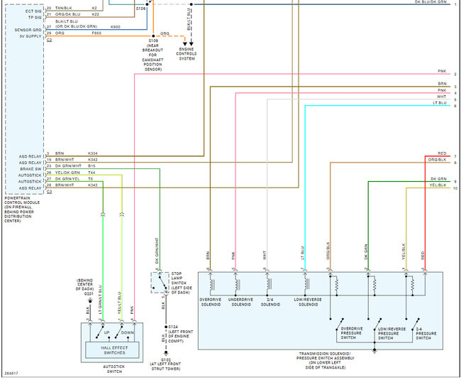

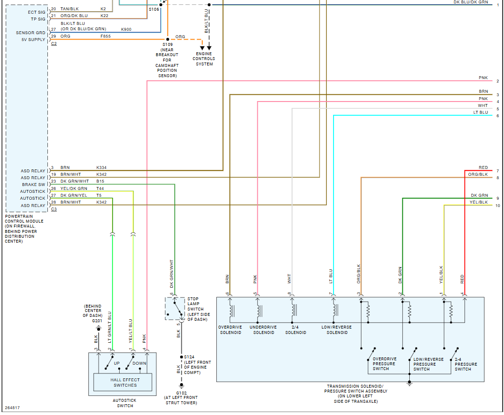

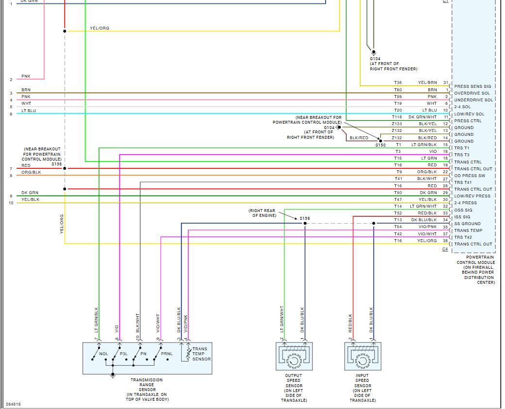

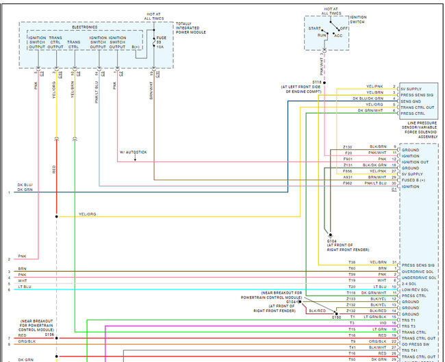

Ok well i foondi out that the 2005 transmission has only 4 wire plug on it and the 2008 has 5 plugs and that i would need to customize my wire harness. Do u know how i could get my 2005 transmission to work with my 2008 pt
Aug 11, 2025 at 6:12 AM

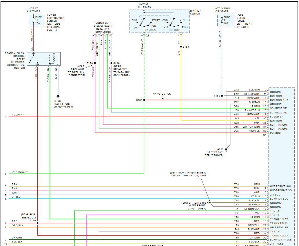

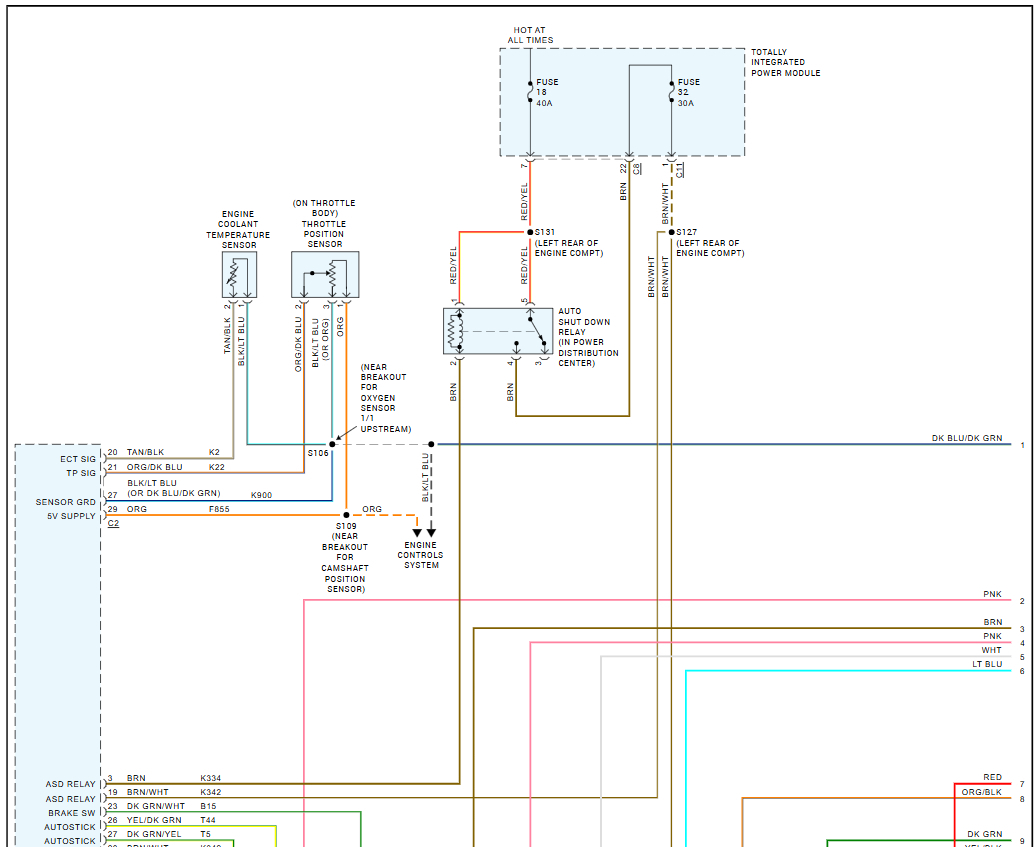

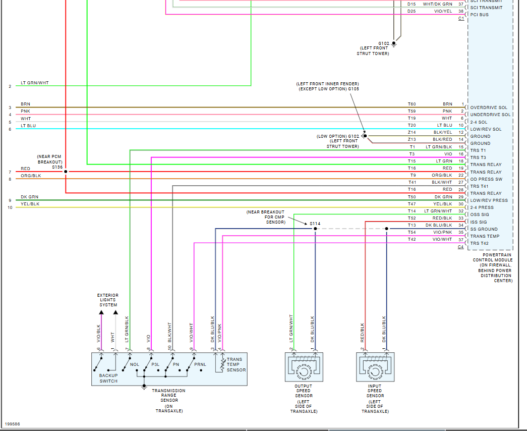

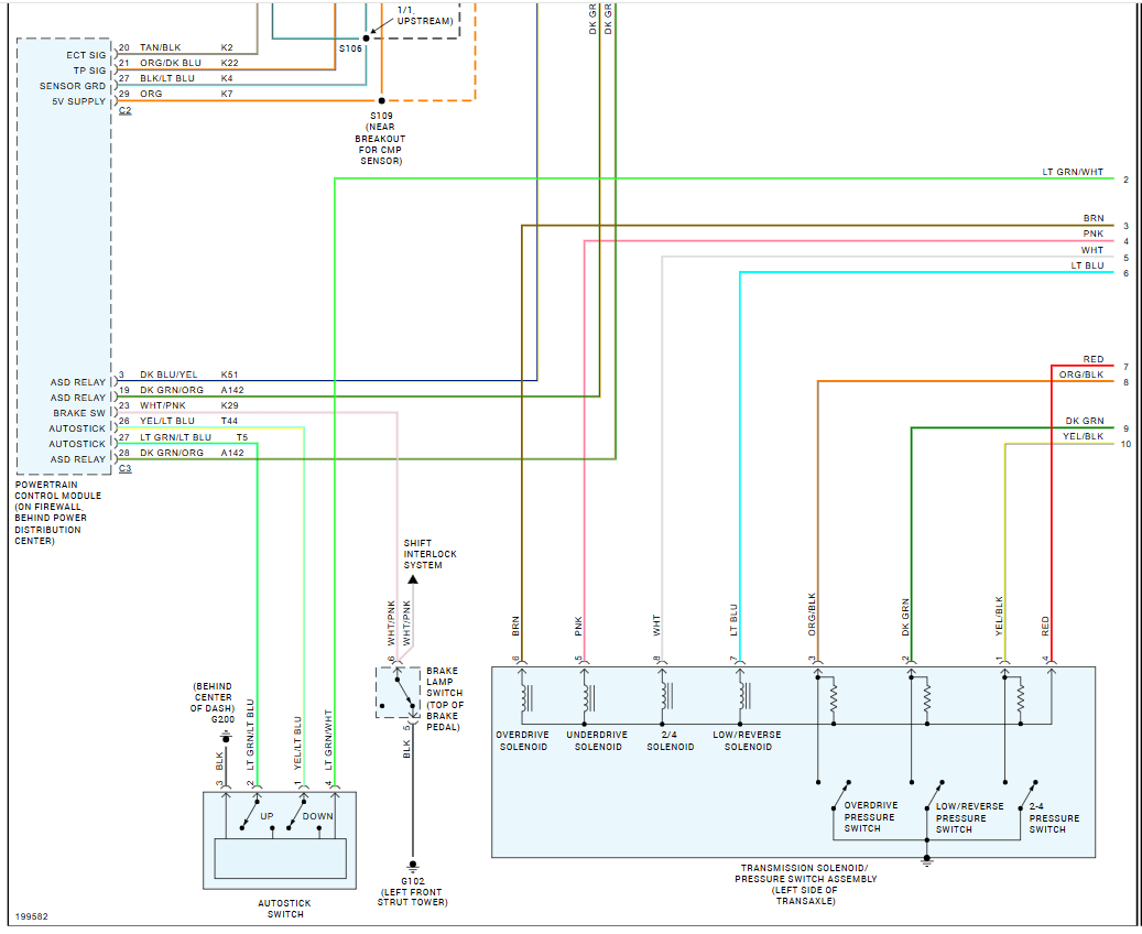

I don't know if that can be done, the computer system is designed to work with the five wire. Here are the wiring diagrams for both. The 2008 is first. Check out the images (below). Let us know how it goes
Aug 11, 2025 at 8:25 AM
