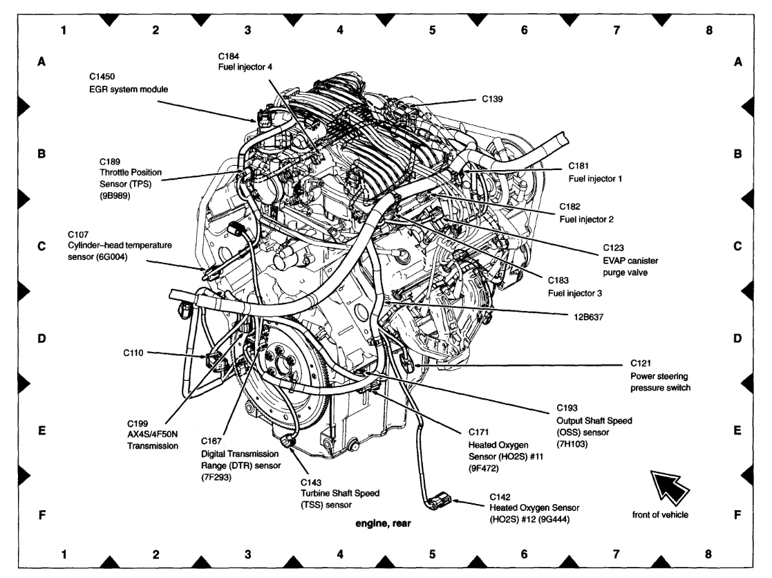

transmission will-miss shift when shifting into second gear does not do it every time.
Apr 13, 2022 at 2:51 PM
This happens when the turbine speed sensor starts to go out here is the location so you can change it out which a guide and how to fix automatic transmission problems just in case. Also are there any codes?
https://www.2carpros.com/articles/automatic-transmission-problems
