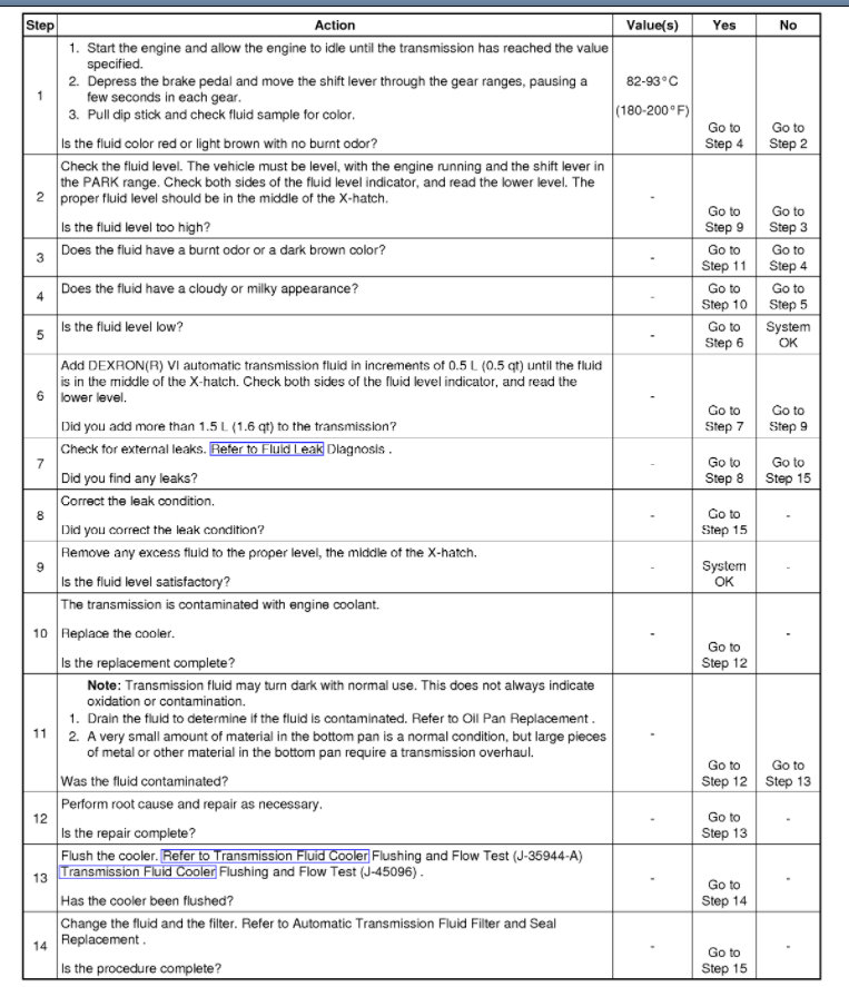

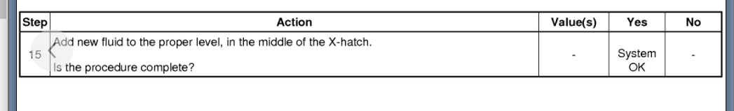

Next we need to check the fluid and make sure it is the proper level and condition.
I attached the process below from the manual on how to check the fluid.
Please let us know what you find with this and clarify me on the issue if I am not understanding.
