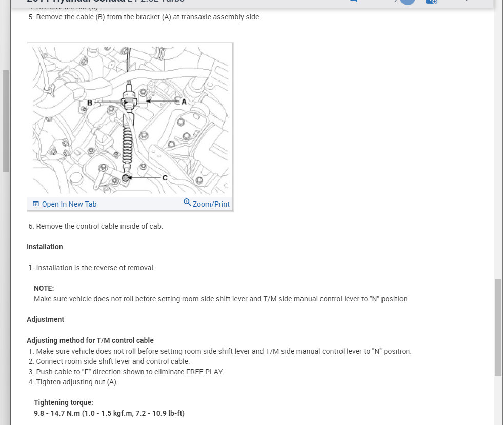

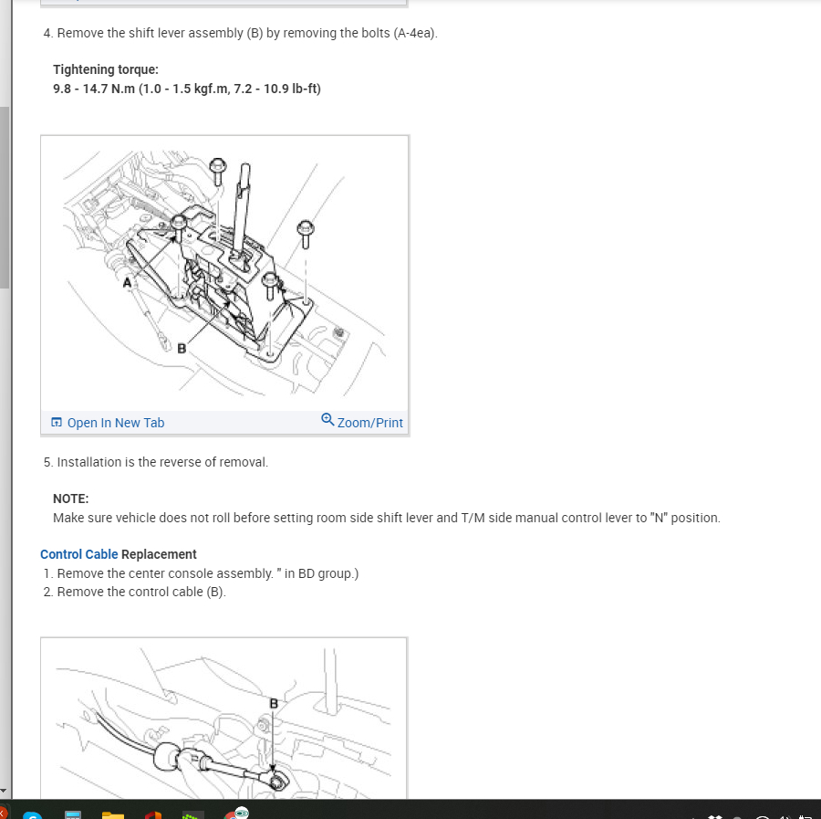

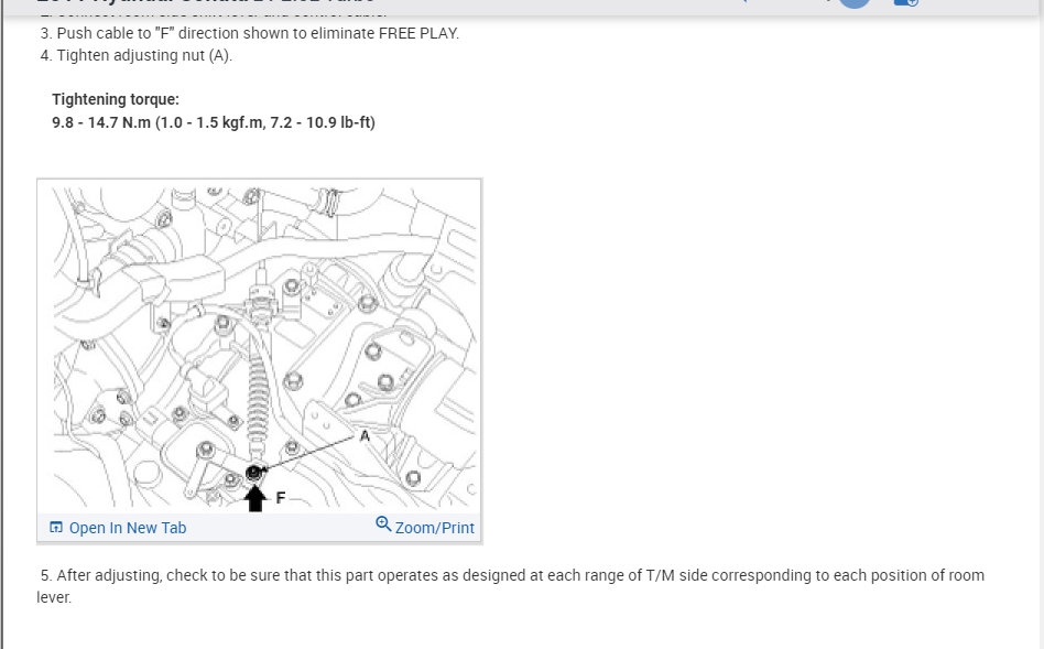

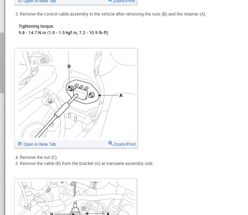

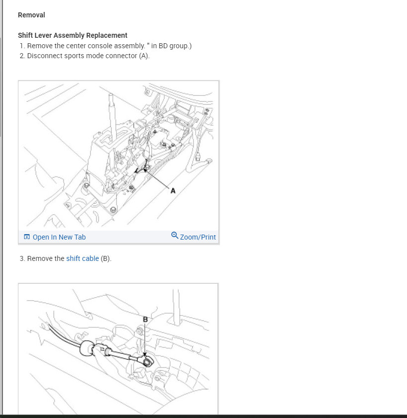

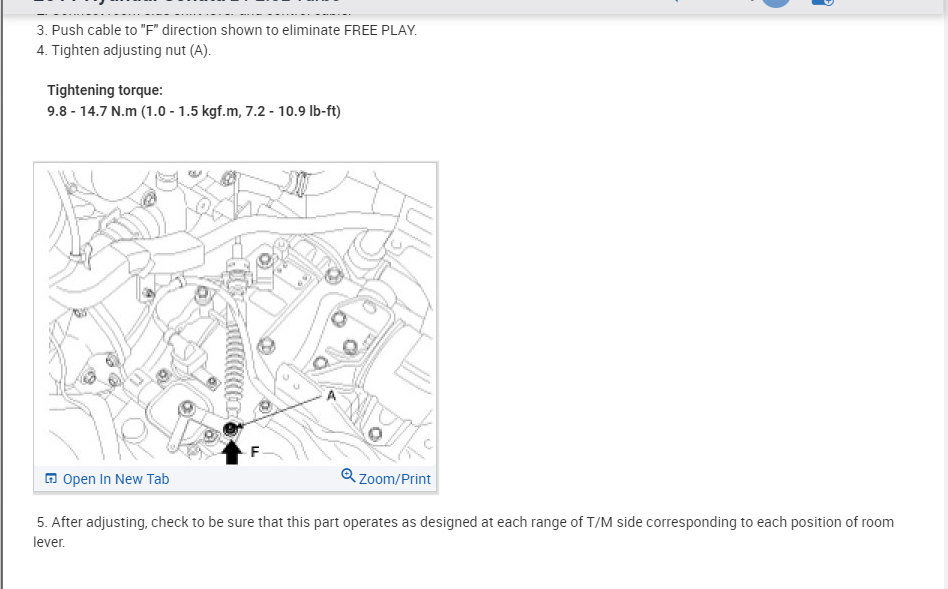

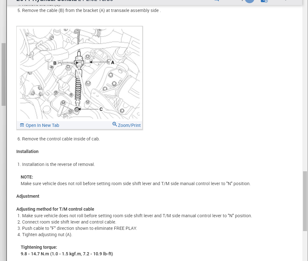

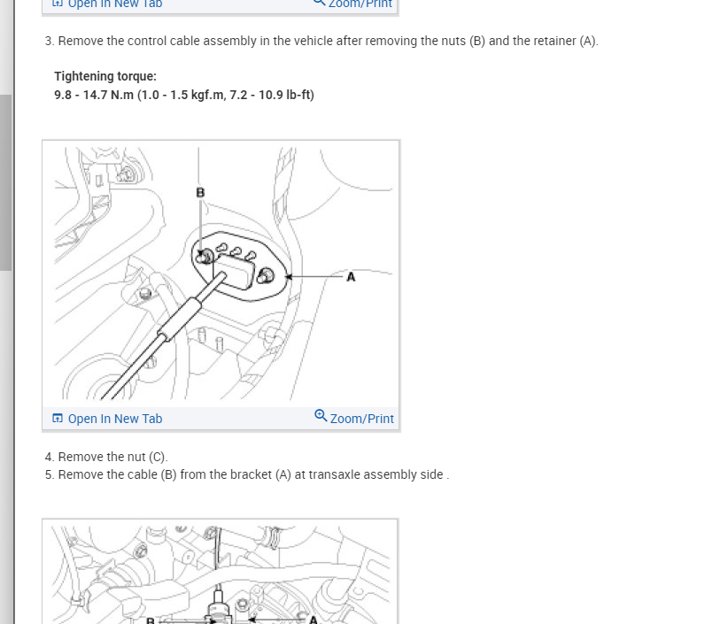

So, let's start with running through this process I am attaching below but here is a guide that will help with lifting the vehicle in the event you want to do that to make it easier to access the range switch on the transmission:
Below you will find the info from the manual on how to replace this and adjust it so if you want to run through the adjustment first and see if that improves operation then that would be fine.
Let us know what questions you have.
