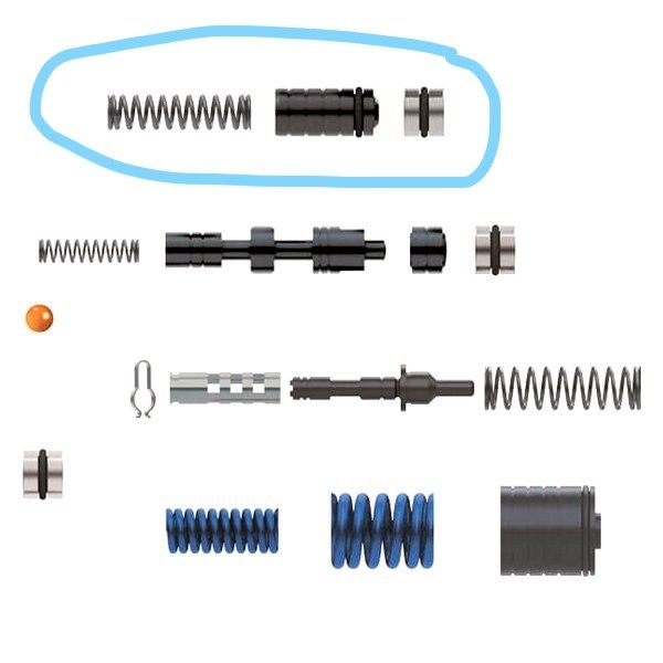

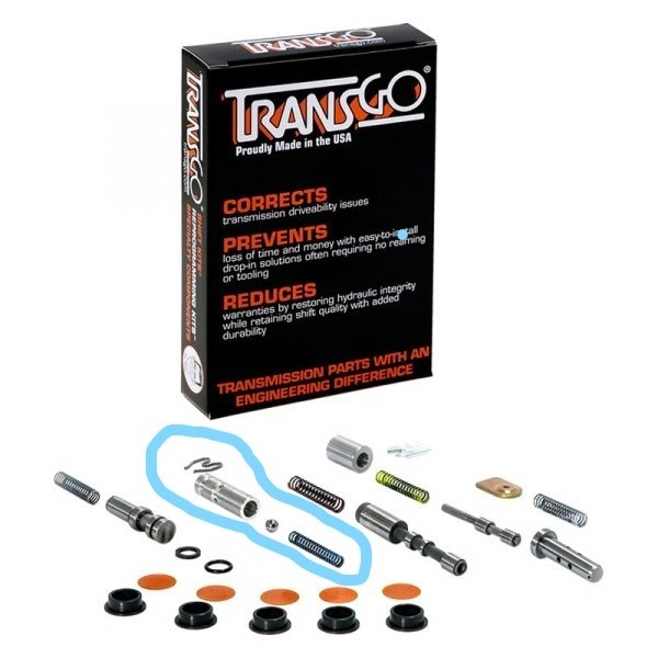

Yes, took valve body apart and bought a repair kit for it there was one valve that looked different that i left the way it was because didn't know if that needed to be changed. The first image is the piece that was already there and didn't know if i needed to change to the other on image 2. Also, when i tried to put tips with rubber ring it would go through kept getting stuck.

What did you do to get it to work and not bind?
Dec 24, 2021 at 7:00 AM
TADRIAN712
  • 5 POSTS
I left the other end tips on because they still worked, or maybe should i put in the new pieces, but I don't know what kind of grease to use to make valve move with new tips and rubber rings. a video on YouTube and the guy on there did it with no problem.
Dec 24, 2021 at 8:08 AM
This may be the actual problem.
We use Vaseline jelly. Good lubricant.
Dec 24, 2021 at 8:16 AM
