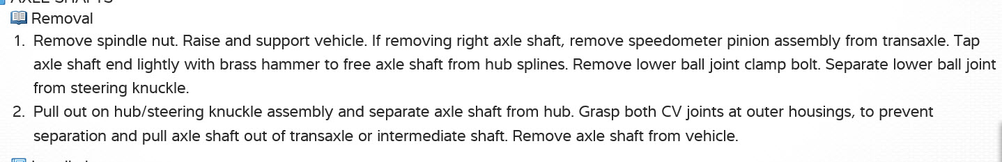

I have been having problems with my car I was not sure what it was. I decided to remove the CV axles and check them. When I removed the right side (passenger side) transmission fluid started to pour out of the transmission, is this right? I do not think that that is supposed to happen. Can anyone tell me what my problem is and how to fix it? I am replacing the right side half shaft.
