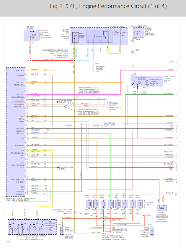

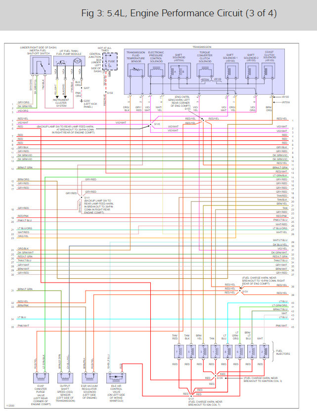

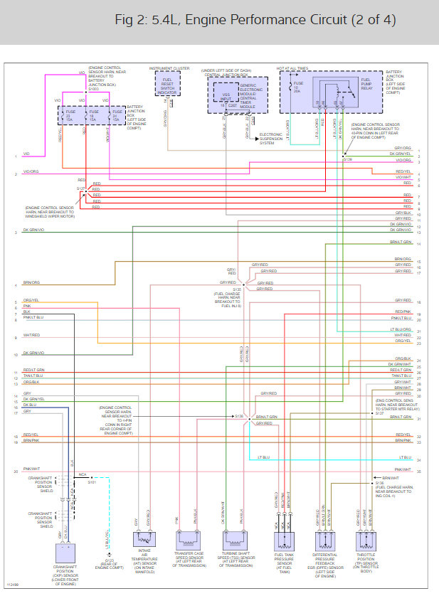

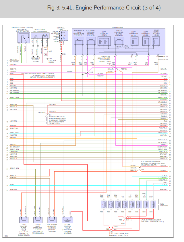

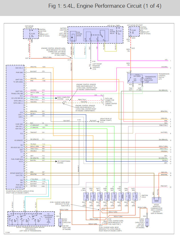

Okay,

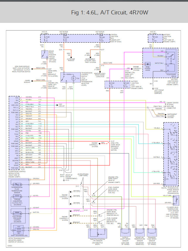

With three separate issues I would say the wiring needs to be checked to make sure everything is connecting the way it should.
Here is a wiring diagrams and guide to help you see whats going on:
Let me know what you find, Ken

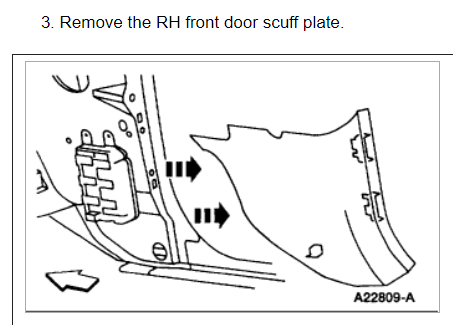

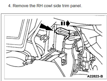

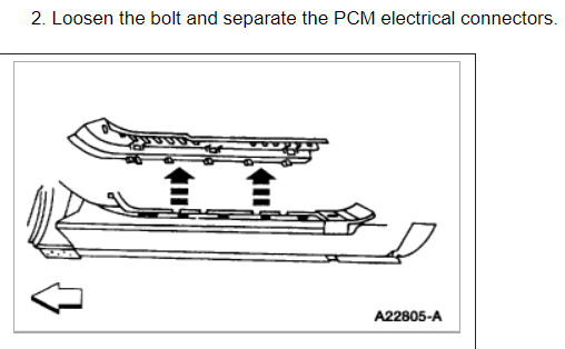

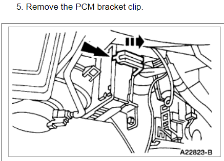

With all three codes being different issues and the wiring okay I think we are safe to say the PCM is out and needs to be replaced. Here is the location I would try a used one.
Check out the diagrams (below).

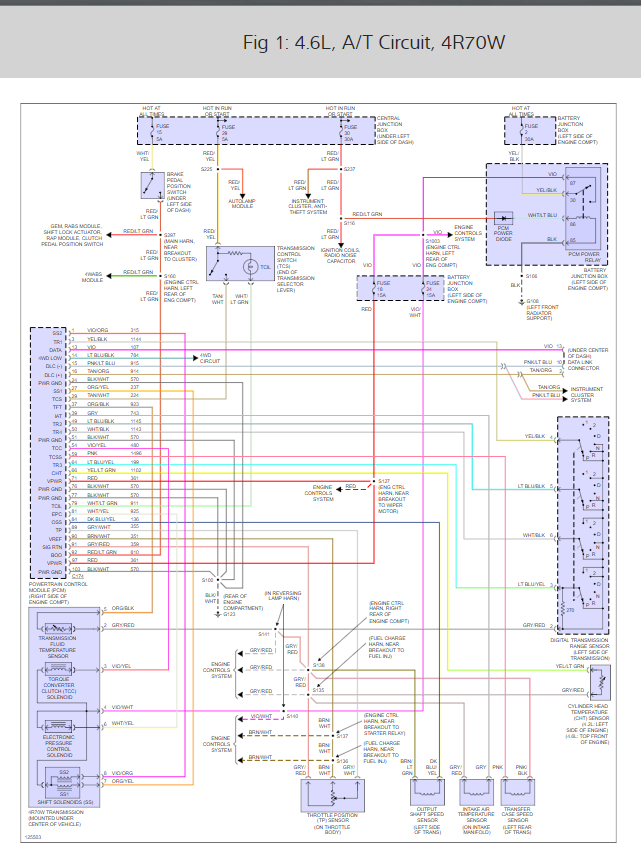

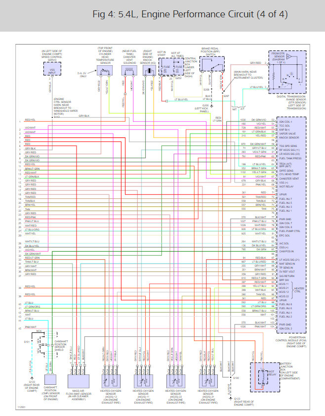

Have you checked the transmission valve body wiring connector? It sounds like you have a connection problem between the transmission and PCM here are the engine wiring diagrams as well.
Let me know if you need large versions of the engine wiring diagrams.
