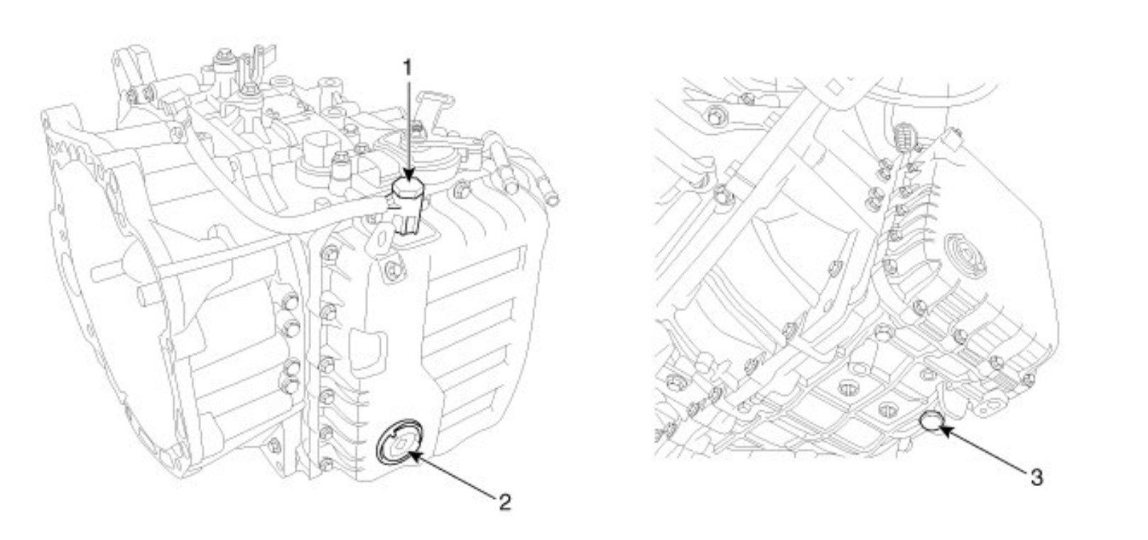

I would check the fluid level first, here is how this transmission uses a see through eye to check the fluid level
Fluid Types
Updated by TSB 13-AT-011
Automatic Transmission Fluid Type
Type .................... SP4-M
Capacities
Automatic Transaxle Fluid
Capacity .................... 7.71 qt (7.3L)

Check out the images (below). Please let us know what you find. We are interested to see what it is.
