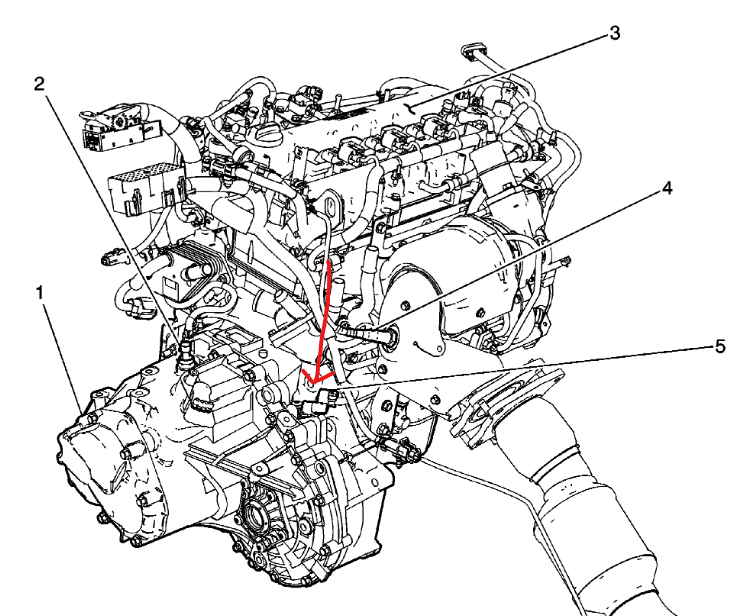

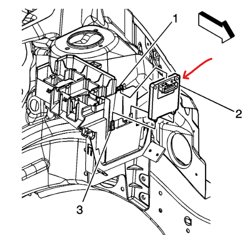

Crap! I love an easy fix that doesn't work, what the heck! Okay, now we get to start looking deeper, so the input for the vehicle speed goes through the TCM and then onto the PCM so we might have an issue with one of them, if I had to guess I would say the TCM is the issue, to be sure lets run a CAN scan. Here is a video to show you how. You might want to check the ECM/TCM fuse (#25) on the BCM which is inside the car under the radio, and the ECM trans fuse (#43) in the fuse panel under the hood, if the fuses are good disconnect the battery and remove the electrical connector form the TCM to check for corrosion. Here is its location. If all else fails let try doing a CAN scan which should give us a code that we can work with. Here is how
https://youtu.be/u-4syLc-ifQ
Check out the images (below). Let us know how it goes
