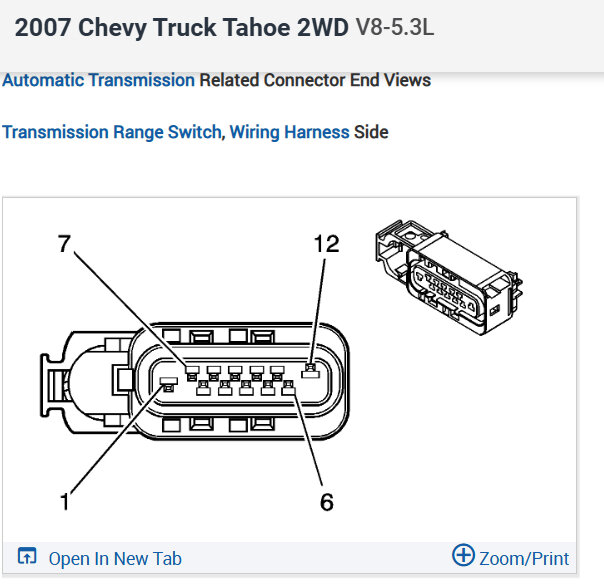

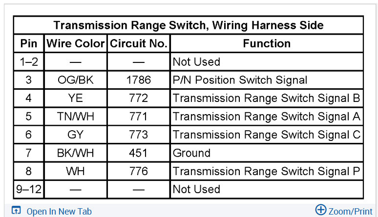

replace neutral safety switch connector need 6 wire diagram.
Jun 27, 2025 at 10:48 PM
Sure, here is the gear range sensor (neutral safety switch wiring pin outs and colors. Check out the images (below). Let us know if you need anything else.
