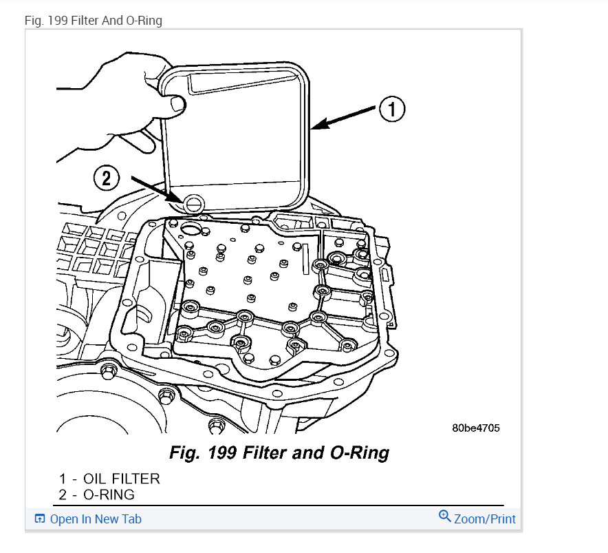

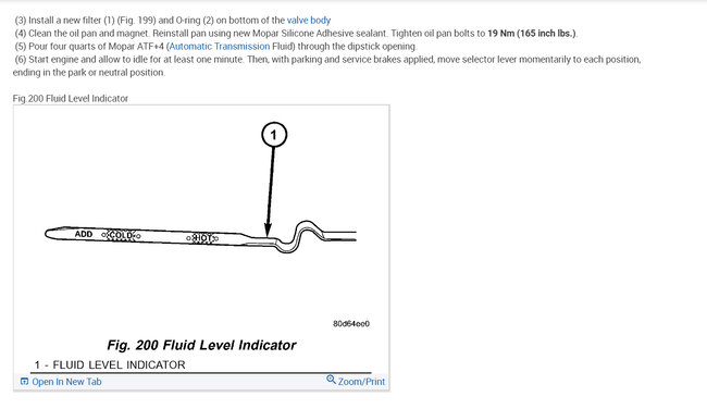

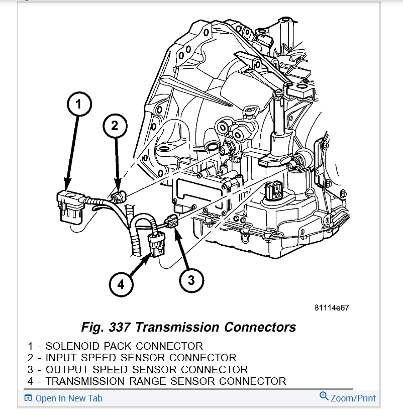

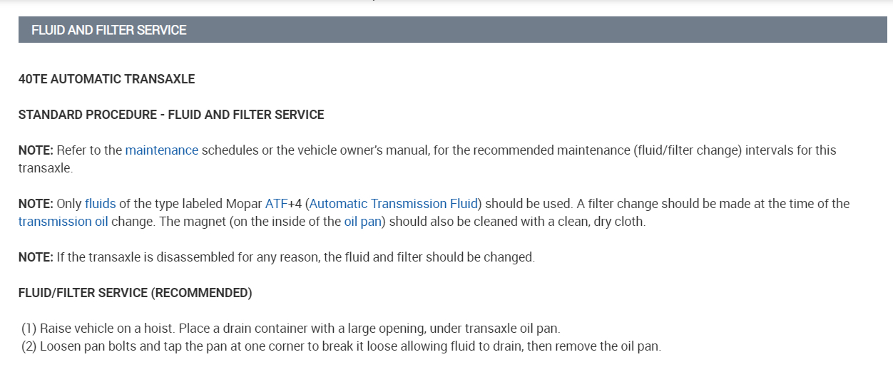

My car goes into what feels like neutral when I'm in D and it slips whenever I try to press on the gas reverse works fine, it's just my other gears don't. My car will drive but you have to push it for a little bit, but it slips every time. i want to find any way I could fix it without getting a new transmission, but if I have to I can. Thanks for helping me.
