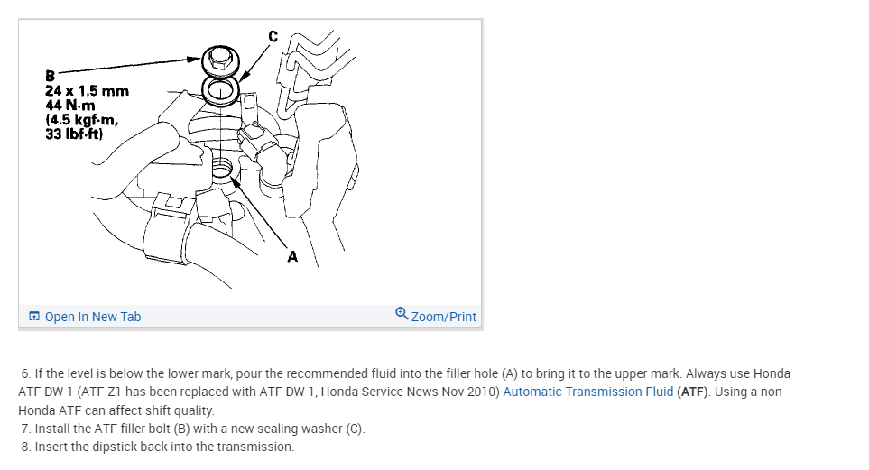

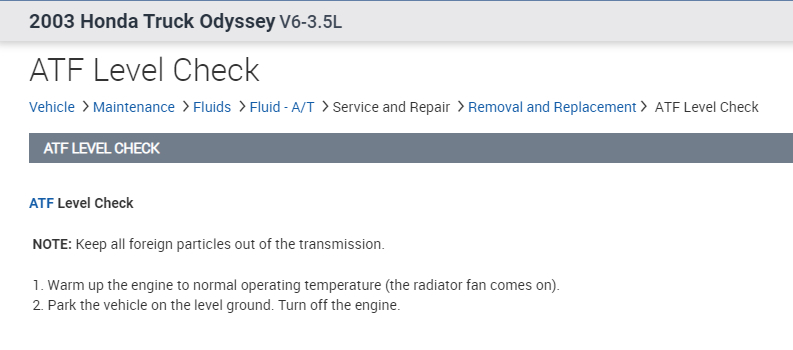

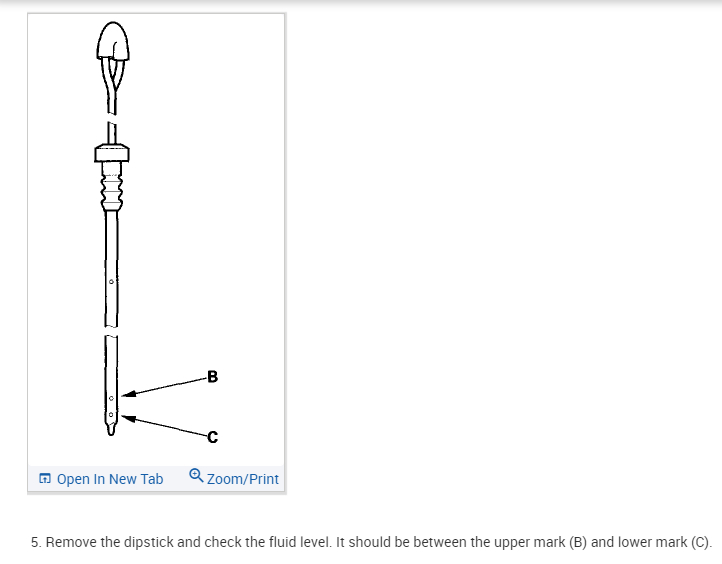

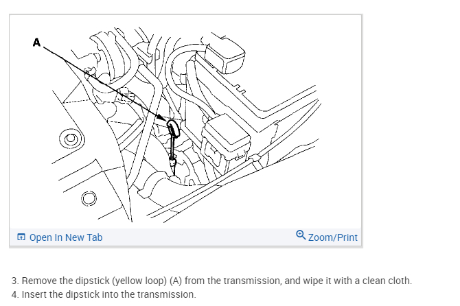

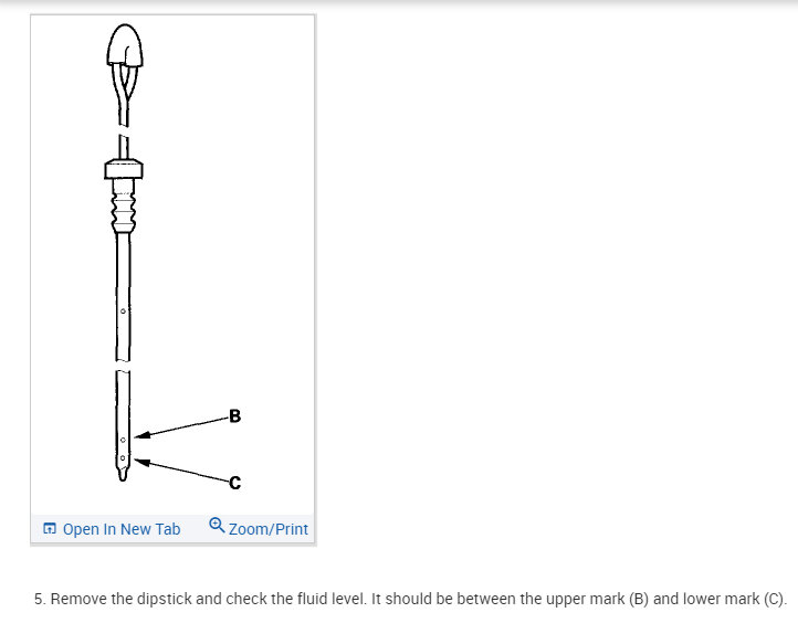

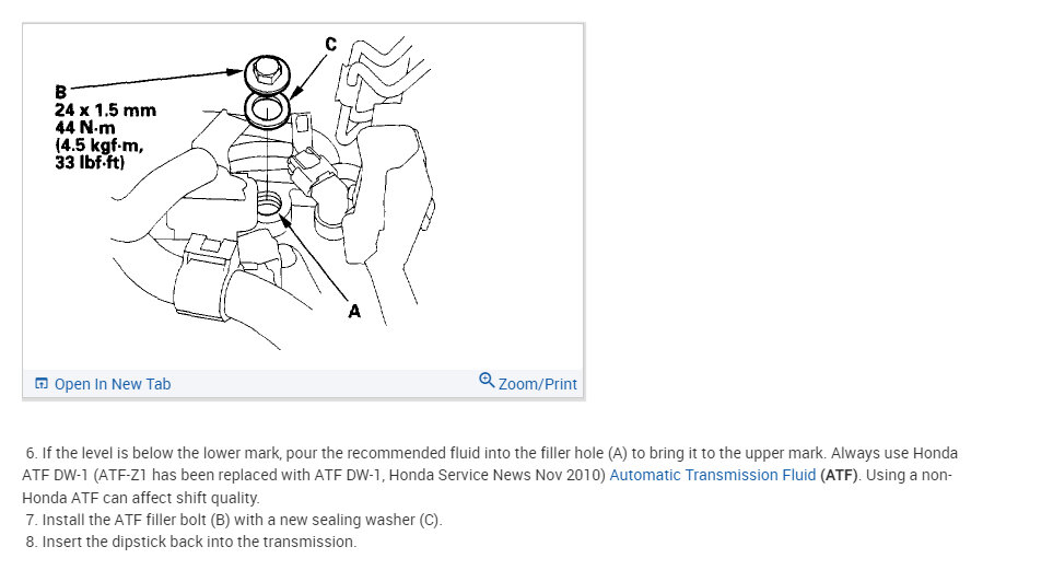

Is the transmission fluid clean and full? Have you rechecked it? Also, when you checked it, was the engine at operating temperature and off?
See the directions below and let me know if that is what you did. Additionally, let me know the color of the fluid at this point.
see pics below.
