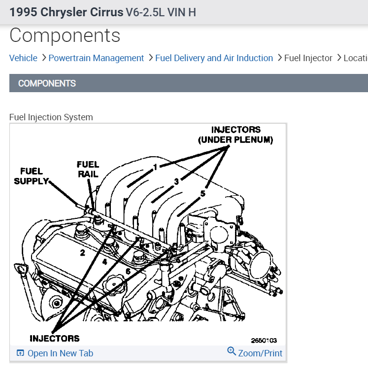

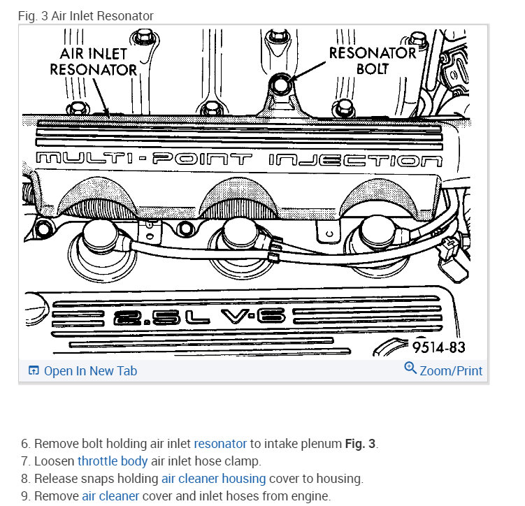

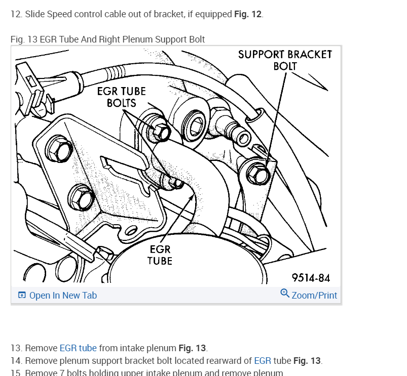

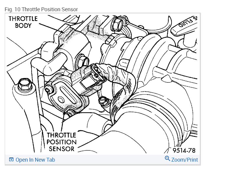

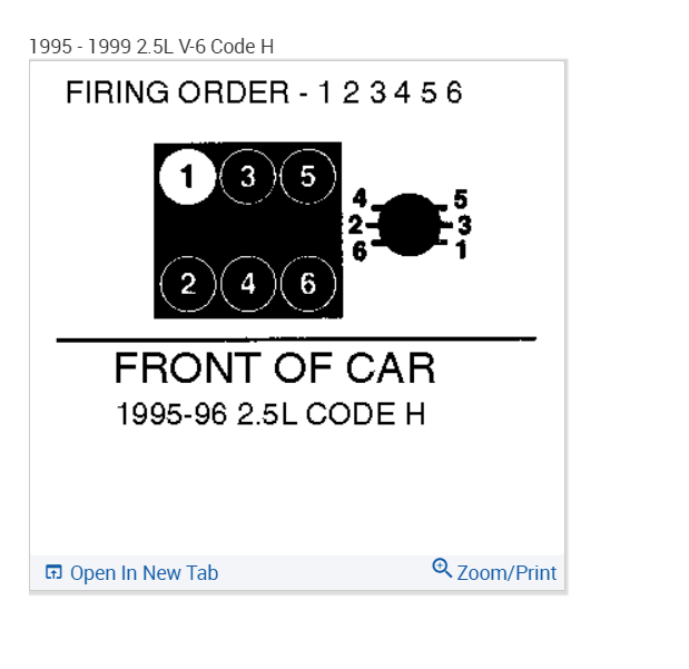

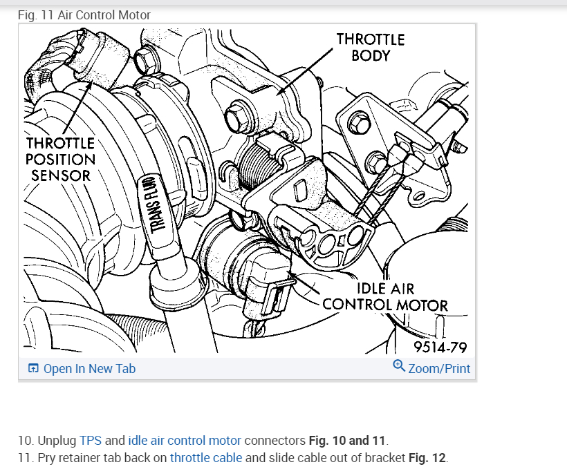

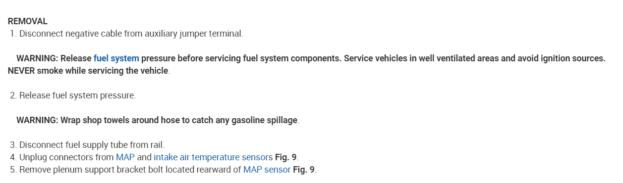

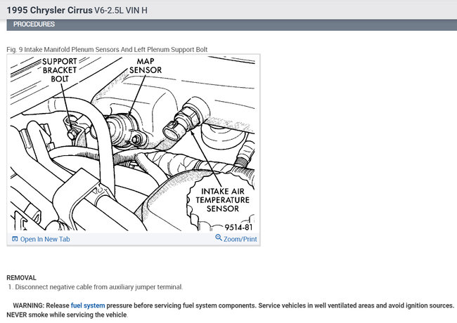

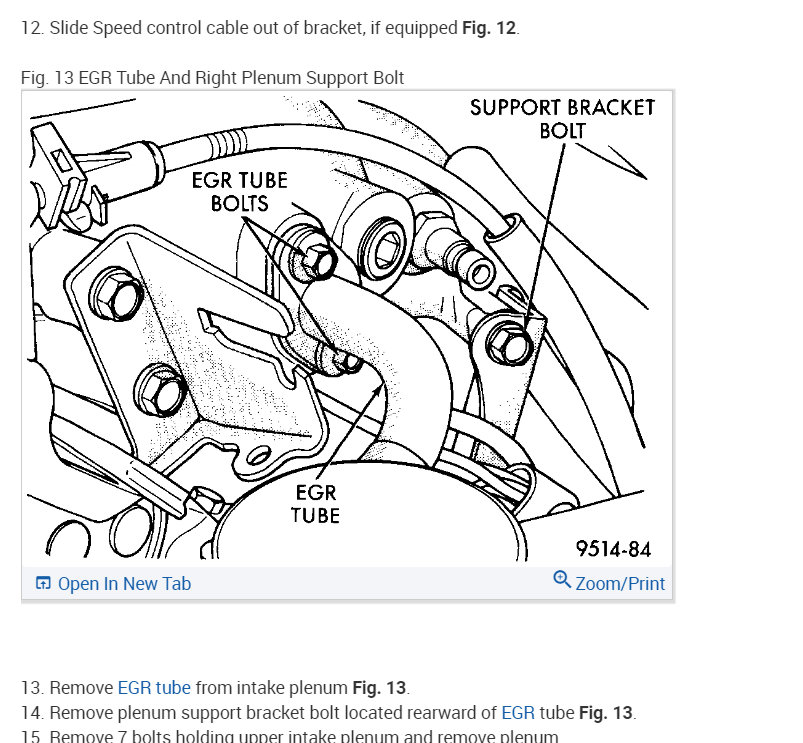

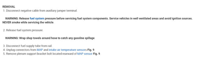

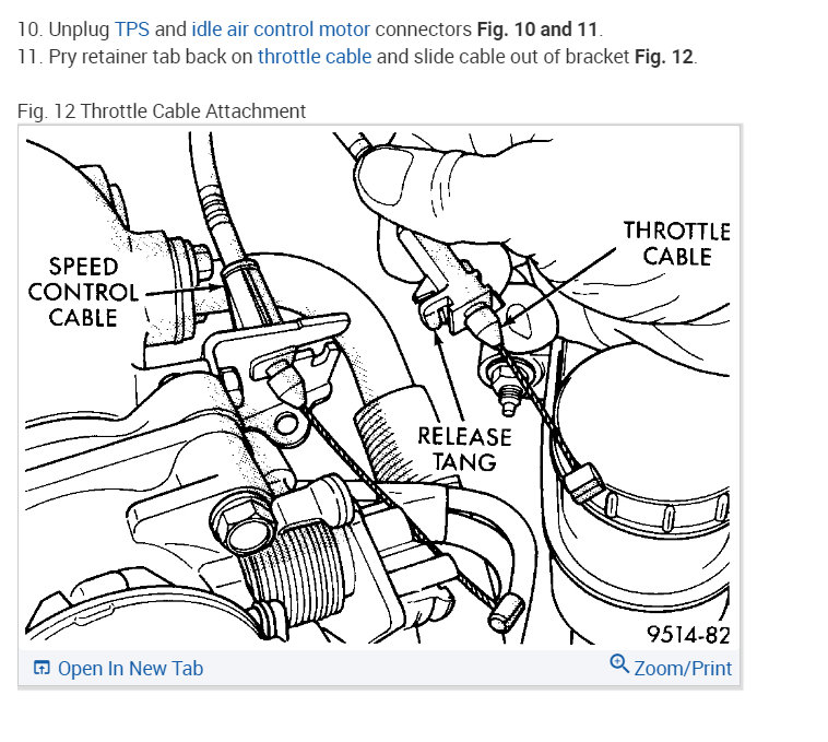

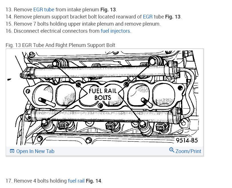

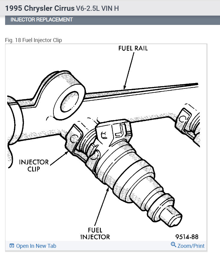

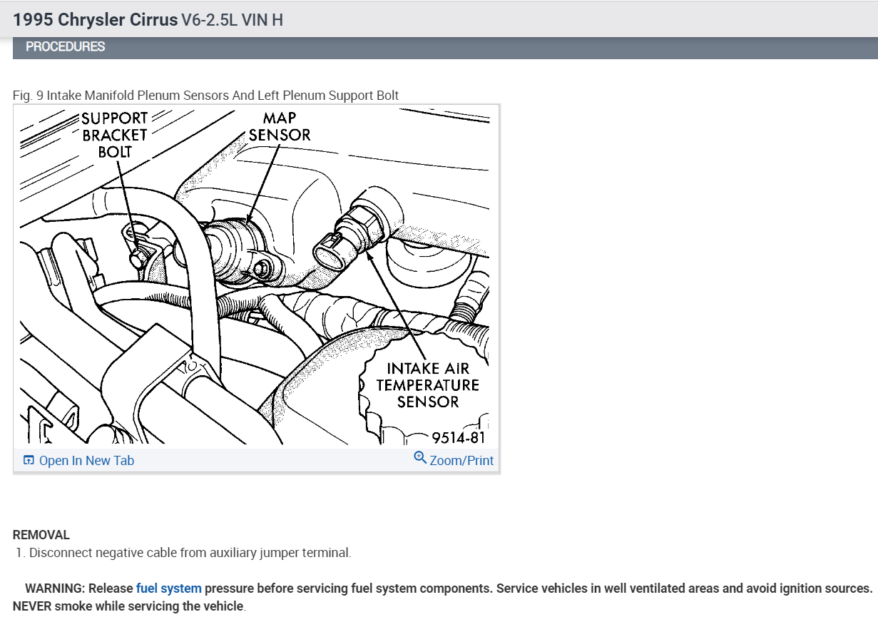

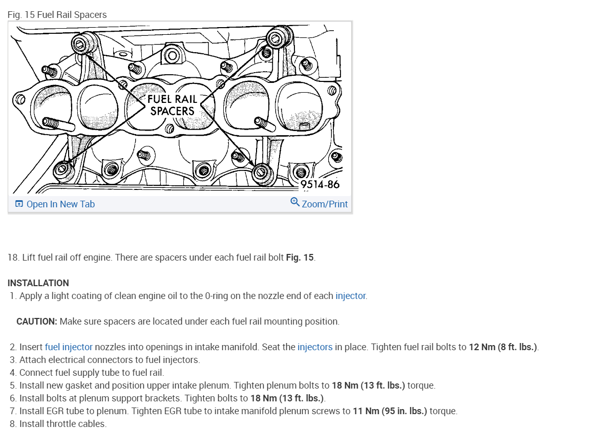

This code P1266 Faulty Fuel Injector #6, here is how you can replace it and fix the problem. I have included the firing order so you can see which injector #6 is. Check out the images (below). Let us know what happens and please upload pictures or videos of the problem.
