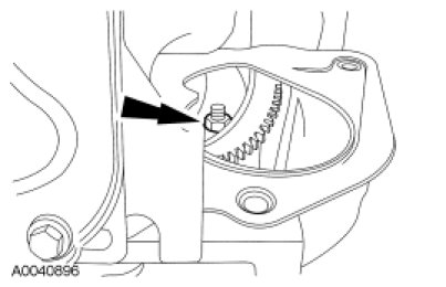

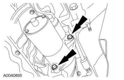

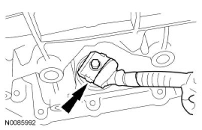

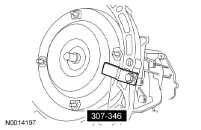

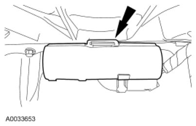

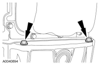

I don't know if you need them, but here are directions for the removal and replacement of the transmission. The attached pics correlate with the directions.

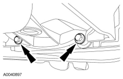

5. Remove the Heated Oxygen Sensor (HO2S) connector from the front of the transmission fluid pan rail.
pic 2

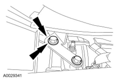

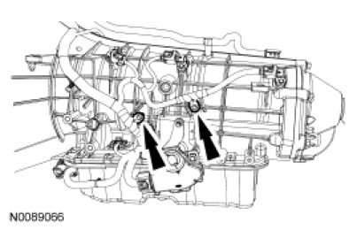

6. Remove the transmission crossmember. For additional information, refer to Frame.

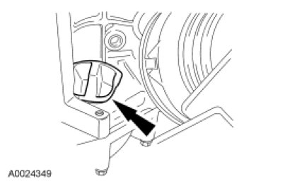

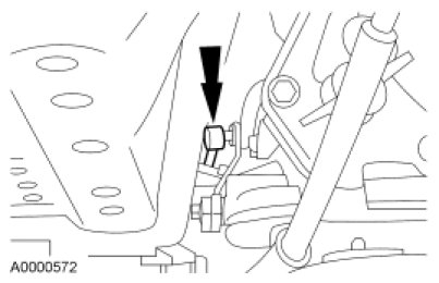

7. Remove the selector lever cable from the transmission manual control lever.
pic 3

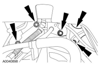

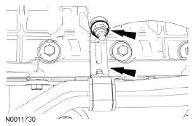

8. Remove the 2 transmission selector lever cable bracket bolts from the transmission and remove the bracket.
pic 4

10. Remove the flexplate cover.

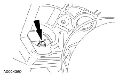

11. Remove the access cover.

13. Remove the starter and position aside.

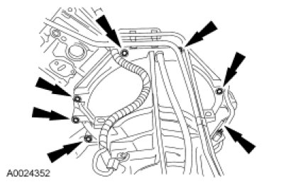

15. Remove the lower transmission retaining bolts.
pic 10

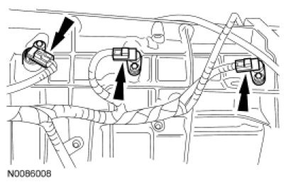

17. Disconnect the Turbine Shaft Speed (TSS) sensor, Output Shaft Speed (OSS) sensor and intermediate shaft speed sensor connectors.
pic 11

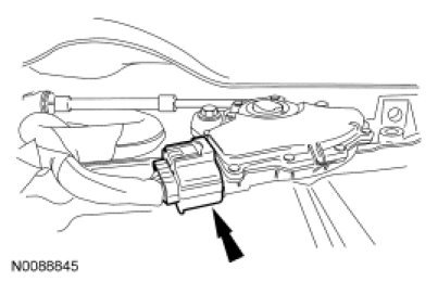

19. Disconnect the Transmission Range (TR) sensor connector.
pic 13

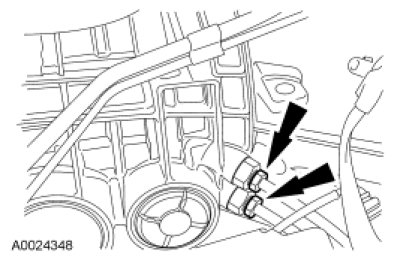

21. NOTICE: Do not damage the cooler tubes.
Remove the transmission fluid cooler tubes.
pic 15

23. Remove the 7 engine-to-transmission retaining bolts.
pic 17
4.0L engine
24. Remove the 6 engine-to-transmission retaining bolts and position the fuel line bracket aside.
pic 18

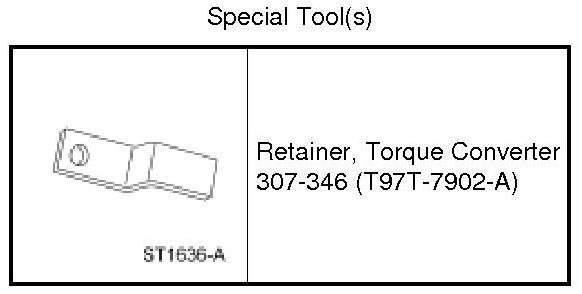

26. Install the Torque Converter Retainer.
