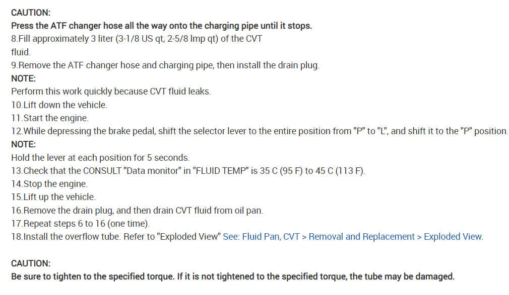

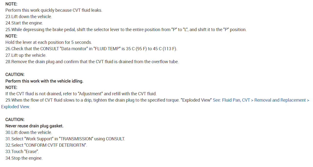

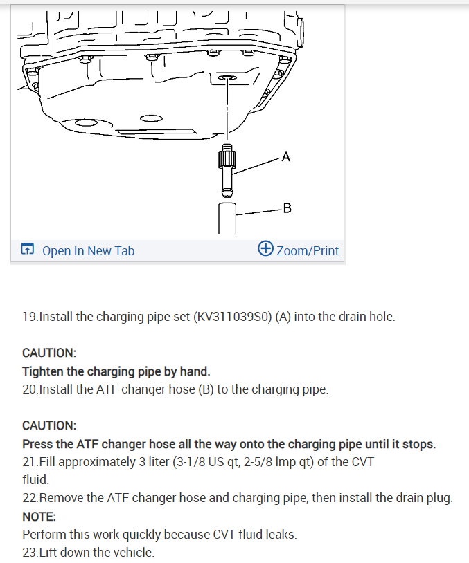

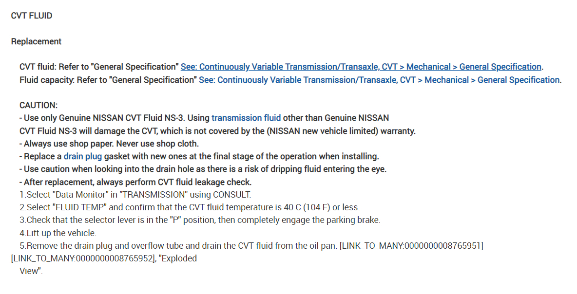

This car has the CVT transmission which they had trouble with, the multi friction belt ends up going bad, but we should run the codes and check the transmission fluid level.
Here are guides to help with instructions for your can in the images below:
and
https://www.2carpros.com/articles/how-to-check-and-add-transmission-fluid
Also, I would service the fluid if it smells burnt to see if that helps but it might be too late.
Transmission Fluid
Type .................... Genuine Nissan CVT fluid NS-3
Use only Genuine NISSAN CVT Fluid NS-3. Using transmission fluid other than Genuine NISSAN CVT Fluid NS-3 will damage the CVT, which is not covered by the NISSAN new vehicle limited warranty. Check out the images (below). Please upload pictures or videos in your response to the problem so we can see what's going on.
