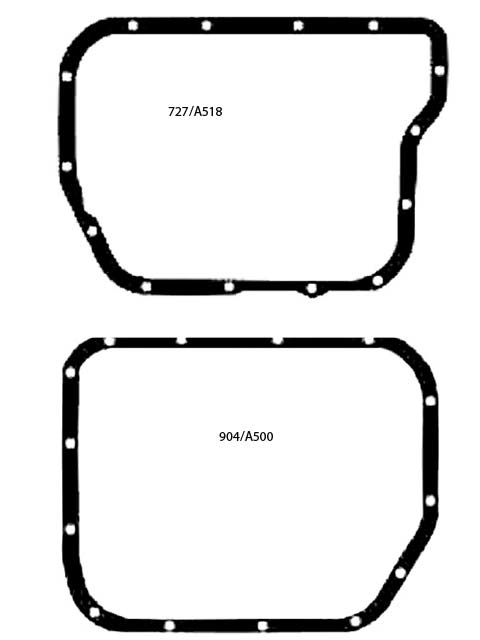

That should have either an A727 (most likely) or the A904 transmission.
