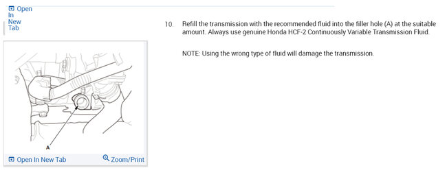

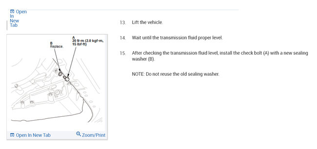

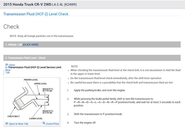

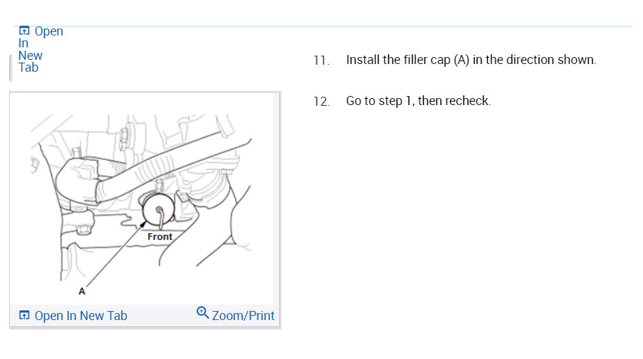

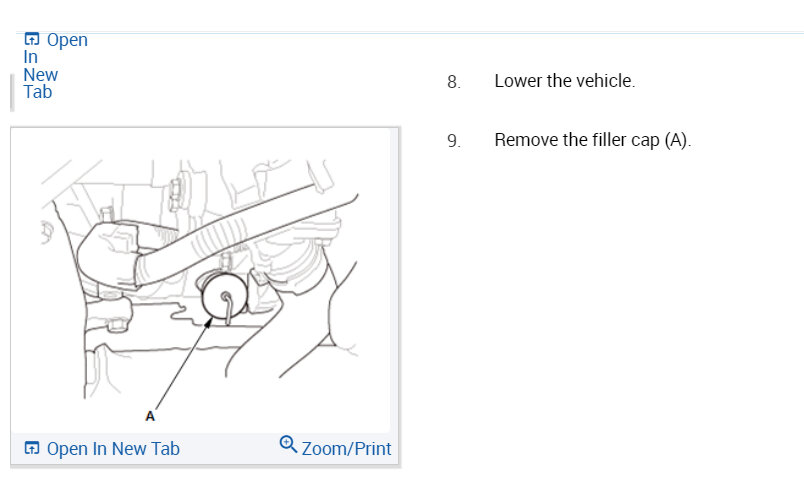

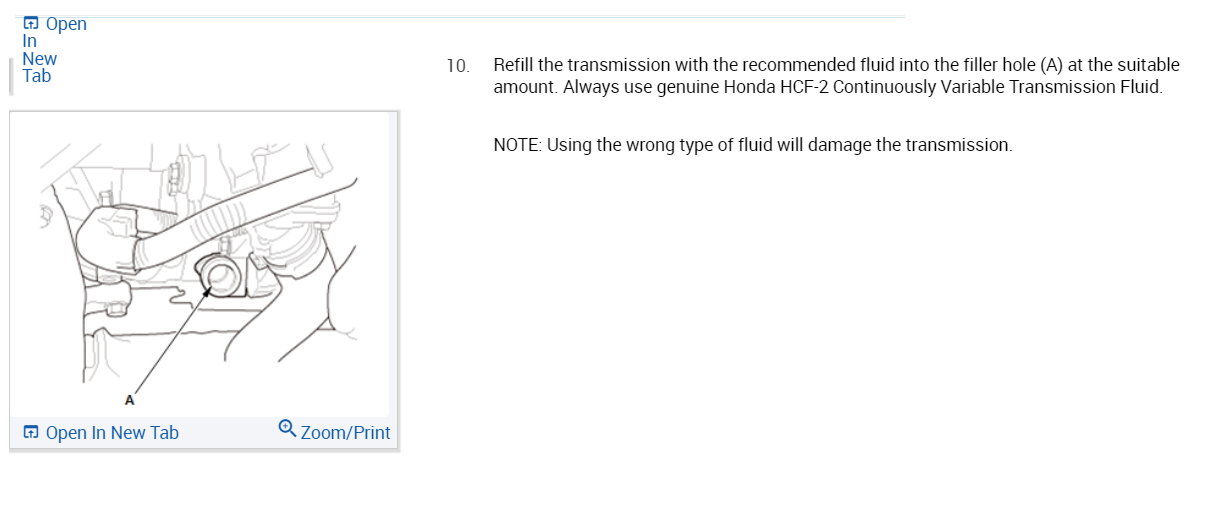

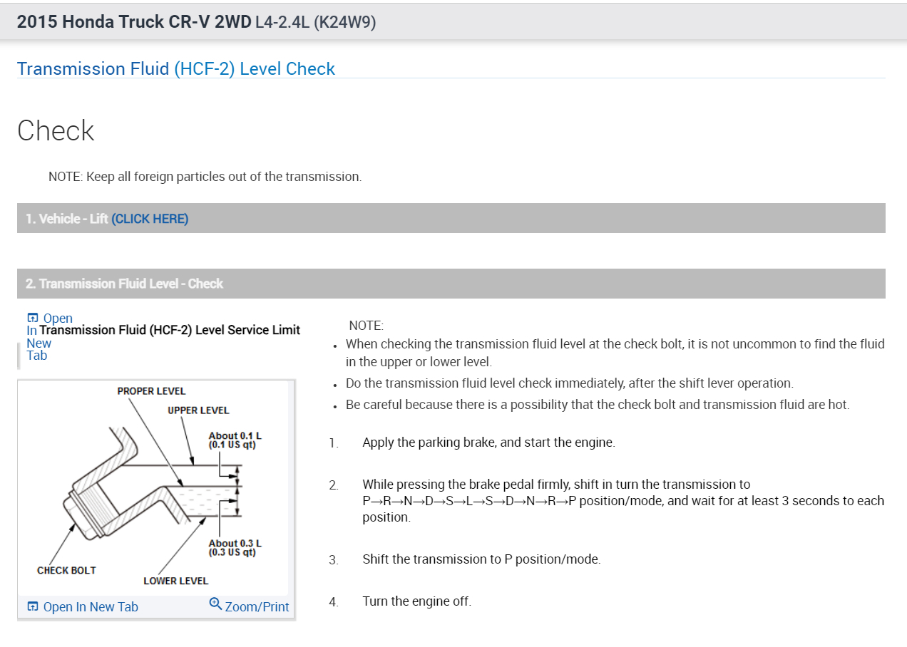

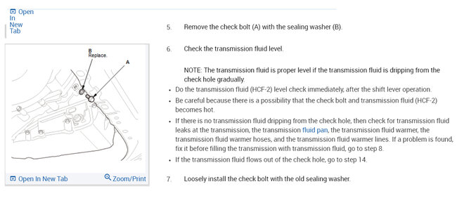

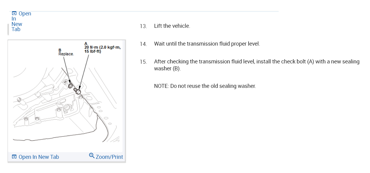

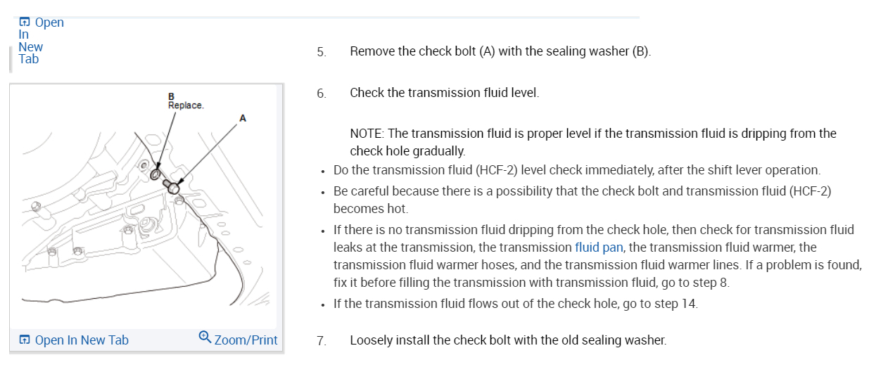

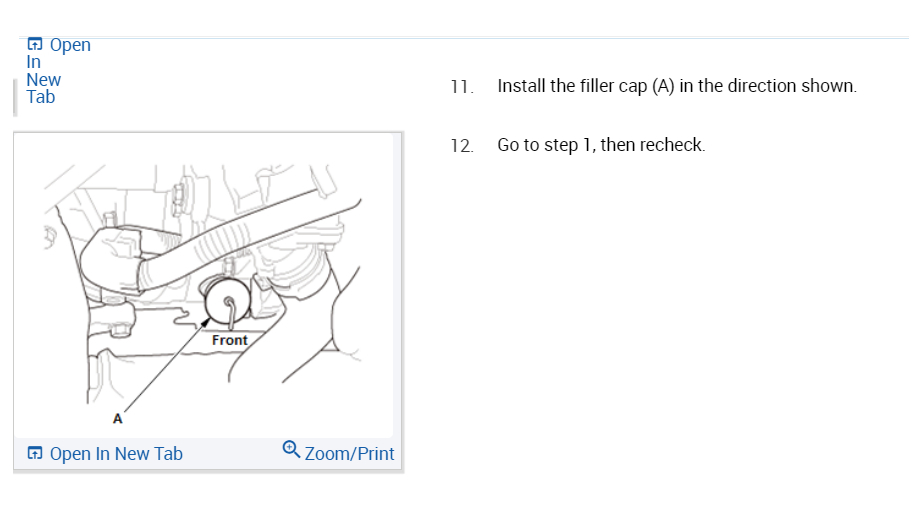

Here is how to check the transmission fluid and a guide as well:
Use Honda HCF-2 transmission fluid.
Note: Using the wrong type of fluid will damage the transmission.
This car has the CVT transmission which had big problems BTW. Check out the images (below). Please let us know what happens.
