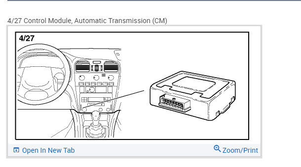

Transmission control module location.
Aug 30, 2019 at 4:45 PM
Please find the attached location of the TCM.
If you have have shifting issues, start with the fluid. Make sure it is not low and in good condition.
If this is not the issue, then it could be the TCM or the shift solenoids depending on what it is doing.
Let me know if you need anything else. Thanks

The transmission control module is located on top of the transmission. Have you checked your transmission oil level? Low fluid will cause shifting issues as well.
