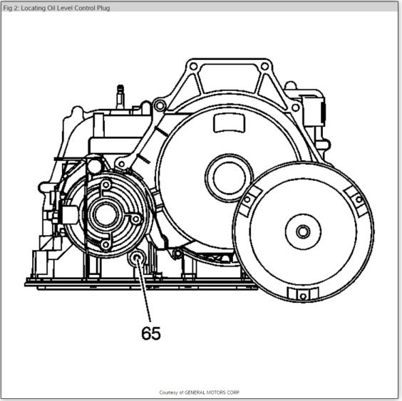

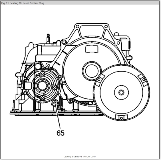

Where is the transmission dip stick located on this car? I cant seem to find it.
Mar 19, 2016 at 11:03 PM
Hey Holtsherrod,
Yep, they hide it on ya, and it's not a traditional dipstick which can fool anyone, I found this information in Mitchell1 thought I would pass it along. In #65 obviously, let me know how it goes. Thanks for using 2Carpros.com
