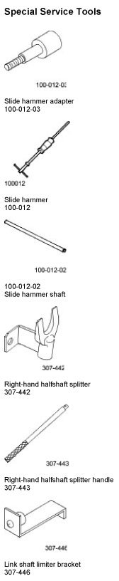

I am not sure what step 13 is in the directions you have. Step 13 in my directions deals with driveshaft removal. Here are the directions from Alldata. I have also attached a picture of the special tools required. All pictures correlate with these directions. I hope this helps.
Transfer Case (46.10.01)
Special Service Tools (see pic 1)
Special Service Tools (See pic 2)
