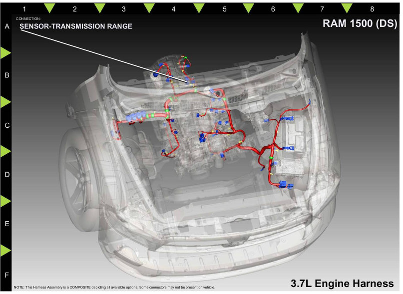

I am looking for transfer case range sensor. I have gotten C1405 code which is malfunction in transfer case range sensor but I cannot seem to find it anywhere.

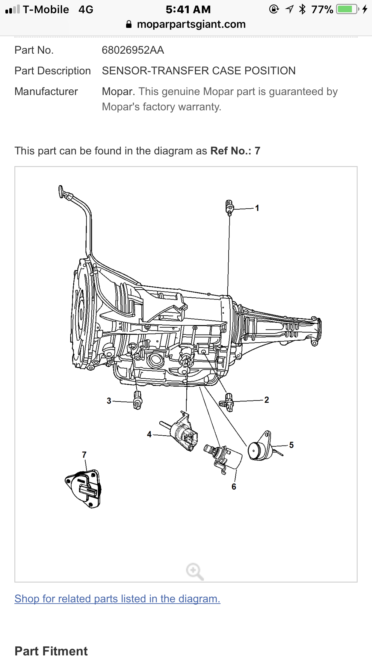

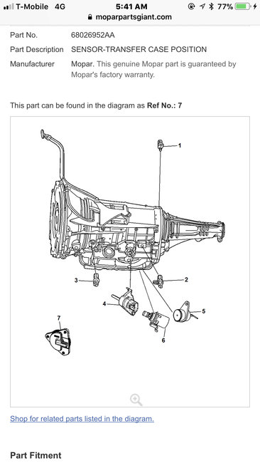

I found a diagram that shows my truck (listed above) uses this part (see attached) but does not show where it is located (fig. #7). part number is 68026852AA.

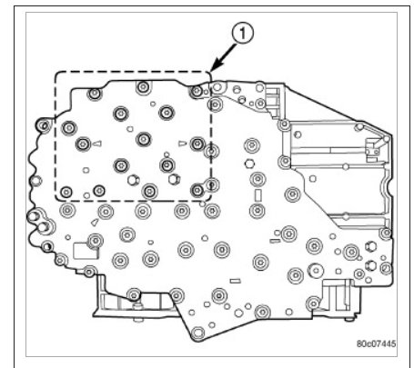

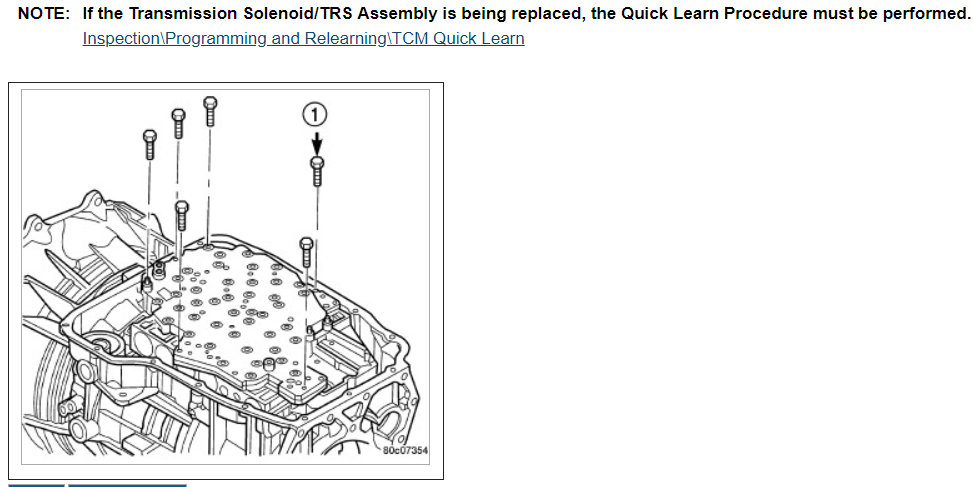

It looks like it is inside the transmission here are diagrams of the location and how to remove it. You will need to remove the transmission pan.
